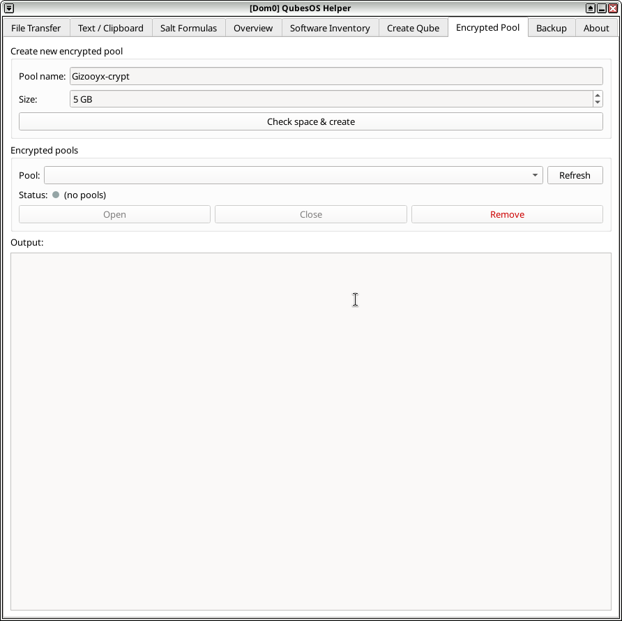

:white_check_mark: This guide solves the old problems:
Many users have been requesting this functionality for a long time. In my anti-forensics guide, I used an ephemeral encrypted dm-container in overlay mode, but we can build a persistent encrypted container protected by a passphrase, which will serve as the backing store for a dedicated secret pool.
How it works: the setup script performs the following steps. First, it allocates a large sparse file (vault.img) and attaches it as a loop device. Then it formats the loop device with LUKS encryption and opens it, creating a decrypted mapper device. On top of that mapper, we build an LVM thin pool (PV → VG → thin LV). The thin pool is then registered with Qubes as a custom lvm_thin pool named vault. Two helper scripts are installed in /usr/local/bin/:
  • vault-open - attaches the loop device, unlocks the LUKS container with your passphrase, activates the volume group, registers the pool in Qubes, adds hidden VMs to the app menu and qube manager, so your secret VMs can boot.
  • vault-close - gracefully shuts down any running VMs from the pool, deactivates LVM, closes the LUKS mapper,detaches the loop device, returning the pool to a fully encrypted offline state, hides secret VMs from the app menu and qube manager.
This gives you a seamless workflow: run sudo vault-open, start your sensitive VMs, and when finished, run sudo vault-close to lock everything away.
When the pool is closed, cryptsetup close removes the existing mapping and wipes the encryption key from kernel memory - this is explicitly documented in the cryptsetup manual. Once the key is erased from RAM, the encrypted container becomes inaccessible, and even a physical memory dump or cold boot attack cannot recover the volume key. The kernel securely erases the passphrase and any derived keys from memory, making this approach resistant to forensic memory analysis. This is a significant improvement over simply unmounting a filesystem, where encryption keys might linger in RAM.

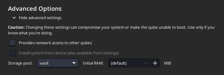

  4. Assign VMs to the vault pool via Qubes Manager: click clone qube and in Advanced select vault in Storage pool. Or create a new qube, and select vault Storage pool in the Advanced Options.
    Now your secret VMs can run.

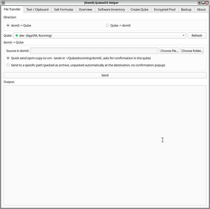

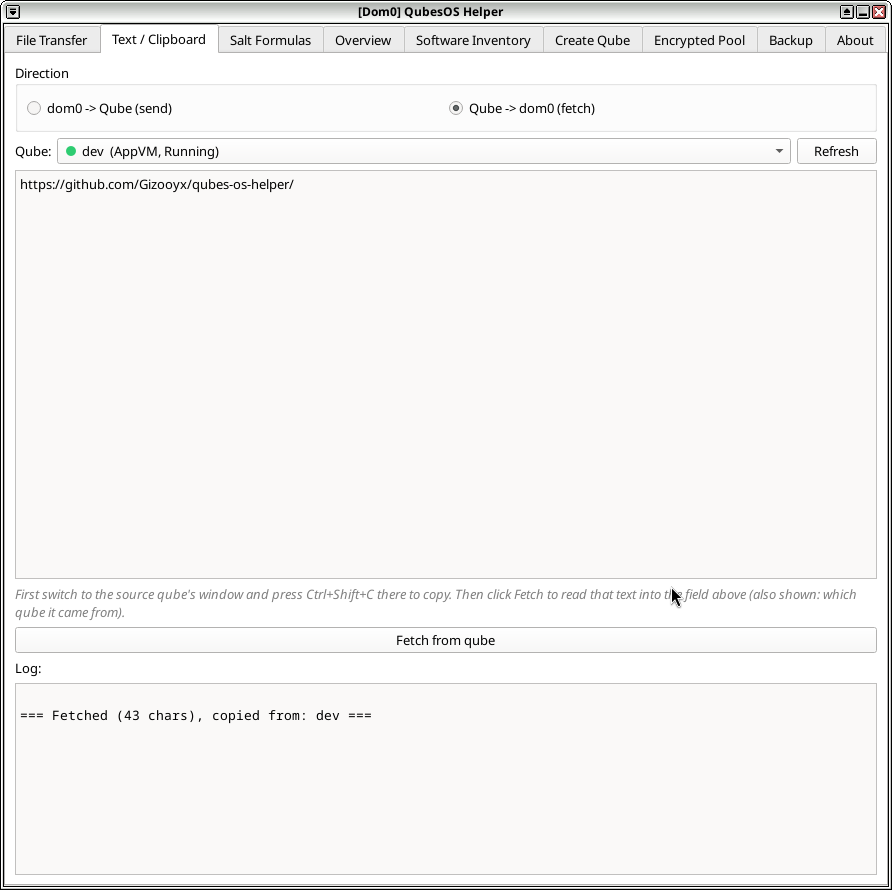

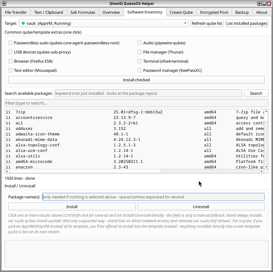

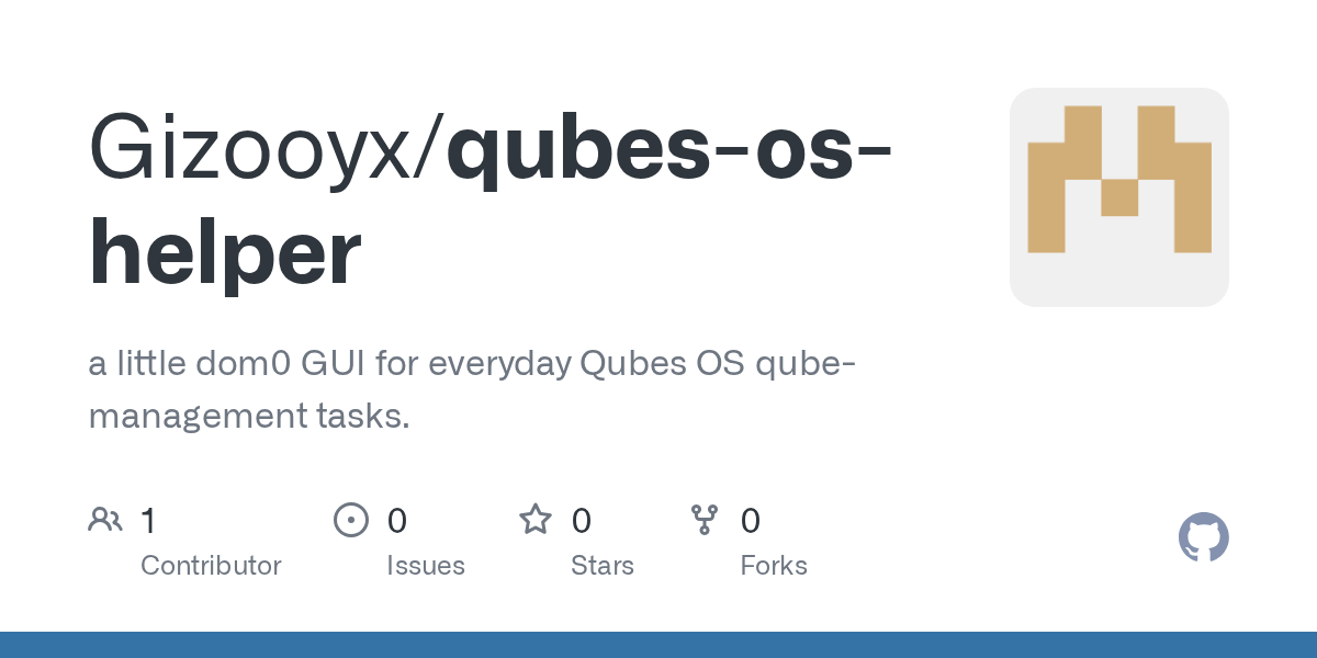

great guide, this inspired me to build a GUI wrapper for exactly this
approach LUKS+LVM-thin encrypted pool, create/open/close/remove from a proper
UI instead of raw shell scripts. part of a small dom0 tool I’ve been
building:
(Encrypted Pool tab, if anyone’s curious)
