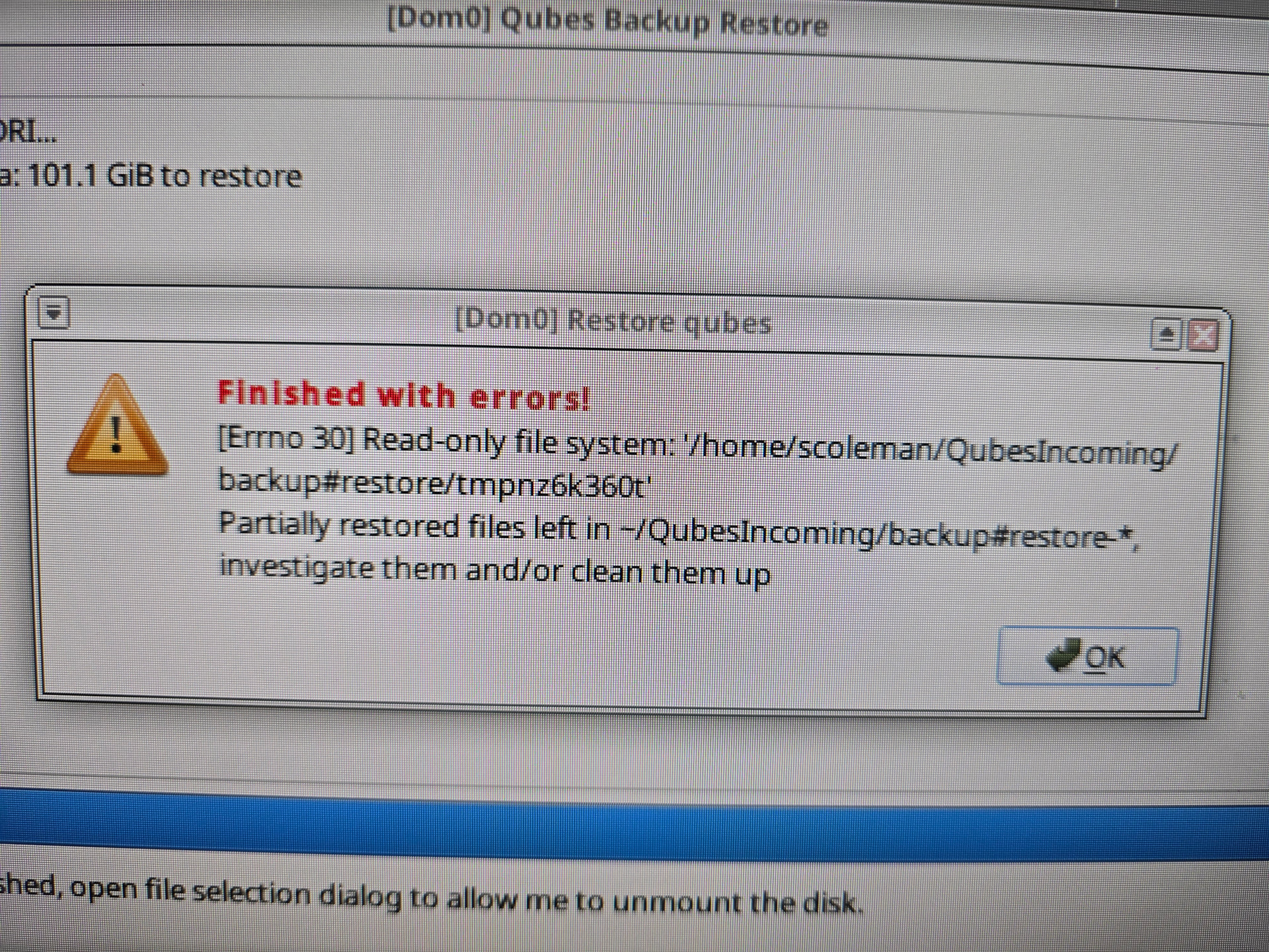

Just before posting this I ran a restore archive verification which gave a slightly different message:

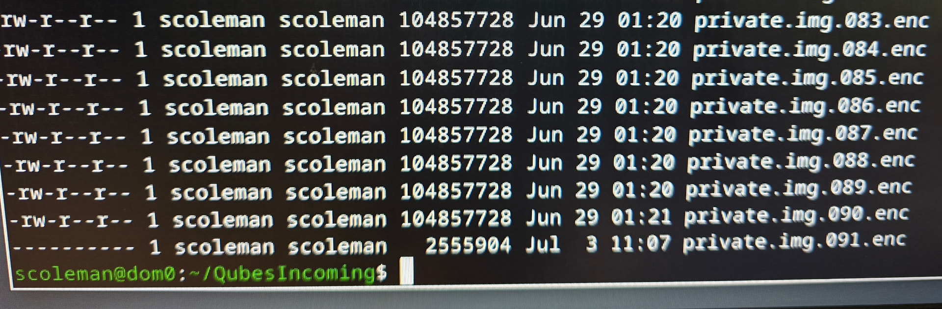

Read only file system? When I looked at the very last data segment it was stored without any read permissions:
Apparently the very last segment is being written into dom0 with no read permissions. But why? Is it chmod’ing after writing each data segment? This would explain why all of them are currently failing while some VM’s yesterday were restoring just fine with no problem that won’t restore today.
I need a clue how this is supposed to work. Can the data be recovered from Dom0 after its dumped here?
Was it, actually? The kernel can automatically remount the filesystem read-only if there are disk problems. Check the dom0 journal’s kernel logs around that time. Never mind, the journal wouldn’t have been able to store those logs as it’s located on the very same filesystem… But maybe you noticed in some other way at the time that the dom0 filesystem was actually read-only?
dmesg tells me EXT4-fs (dm-5): Remounting filesystem read-only
How do I determine what physical drive this is?
It’s gotta be the drive backing your main dom0 filesystem, right? Or /home/scoleman if you partitioned separately for that. If you’re saying the filesystem is backed by multiple drives in a RAID setup, I’d look for earlier dmesg errors pointing out a physical drive. If there aren’t any such earlier errors, the physical drive(s) are probably not what’s causing the problem.
I found the problem. The SSD started to fail during the prior system update and when it made the temproary image device it got marked read only and thus it could not write to it and assumed it was out of space. Device files such as dm-5 were being remounted read only. Any attempt to restore a backup to the newly created system sitting on a bad SSD drive would have pretty random failures on the system. The problem is recognizing when this is happening as SSD’s are not very friendly when this happens. I’m thinking smartmon or gsmartcontrol running on startup in the background might be a good idea.

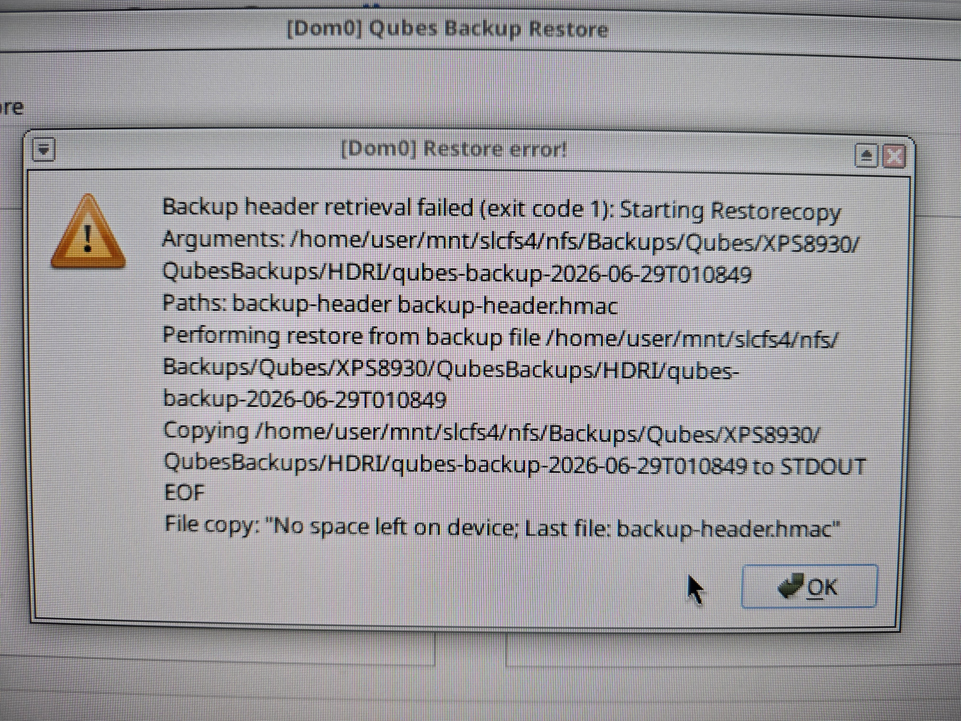

Ok, The SSD is/was not the actual problem here. I just bought all new SSD’s and reinstalled Q4.3 several times, and I am still unable to restore from backups on this specific machine. The exact same backup archives restore just fine on another machine, but that is not where these VMs need to live.
Each time the restore program says that the archive has an EOF in it, and that it is broken.
RestoreError.log (551 Bytes)
This is false, because I can restore the same archives elsewhere just fine. Each time it appears the thin-pool is running out of space when I have 8TB total on the system, but just 4TB as a part of Qubes OS proper at the moment. There is plenty of disk available, and the SSDs are verified not to be failing.

Something is broken in the restore process with the handling of some ext4 pool temp space that it is using to process/restore this archive, but I don’t know what I need to do to give it more space. It’s clearly the larger VM archives that have a problem being restored with the largest being 400GB. When I restored that one first, it worked but still with an error, and ran just long enough that I can actually run the VM, but all subsequent VMs now fail to restore.
