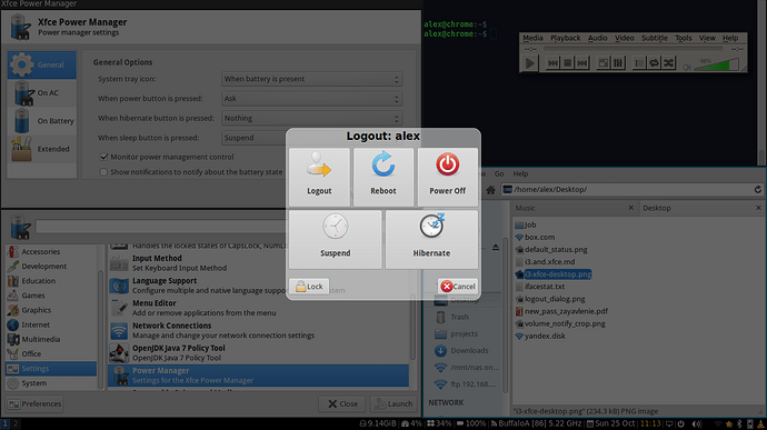

I’ve had the logout window repeatedly appear lately. The only solution to make it go away was to disconnect sys-net. This was before and after a fresh install of 4.2.0. Subsequently, I did a fresh install of 4.2.1 and haven’t seen the problem yet. Has anyone seen this problem?

Maybe I didn’t understood correctly what do you mean by logout window.
Do you mean this window?
In that case maybe it’s a hardware problem with you power button on your PC case or sleep button on keyboard.
Yeap, that window. Good idea. I have a VFD display with a remote control and there could be random RF signals sent. If I hit the power button on the remote, that window appears. The battery on the remote was strangely dead yesterday and I had to recharge it. That has to be it.
