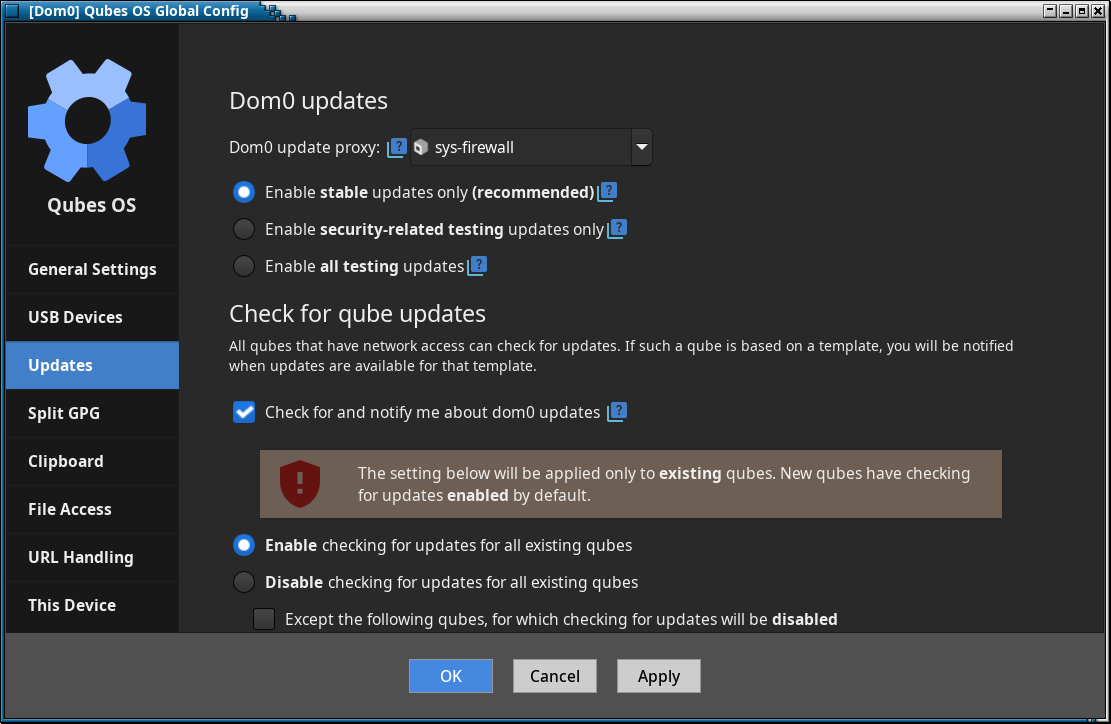

If your qube don’t have internet connection (as it seems, because without proxy it couldn’t install anything), then in Q menu, cogwheel, Qubes Tools run Qubes Global Config. In Updates section change Dom0 update proxy: from sys-whonix to sys-firewall.
Then every qubes updates and applications installations will be done by clearnet, not TOR and will be much faster.
now that worked for the kde apps from flatpak helped me download it faster…

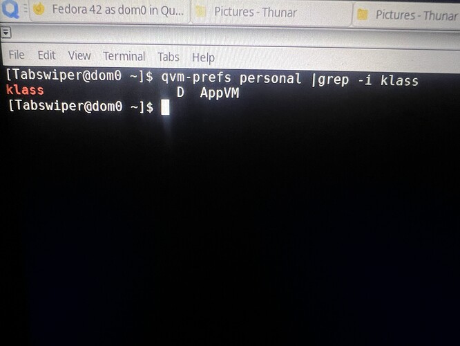

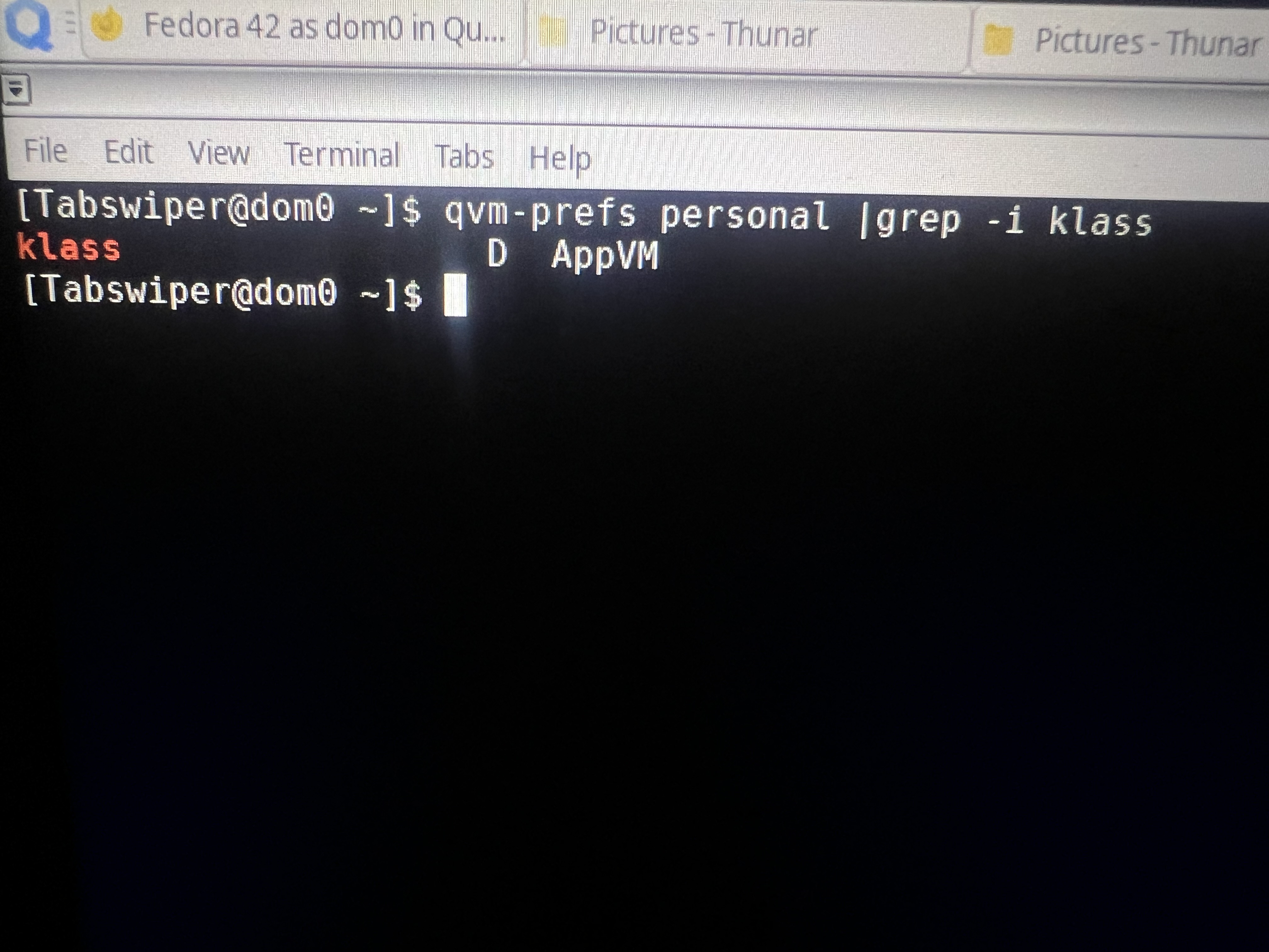

In dom0 terminal check command:
qvm-prefs personal |grep -i klass
if it’s DispVM then it forget everything after it’s closed.

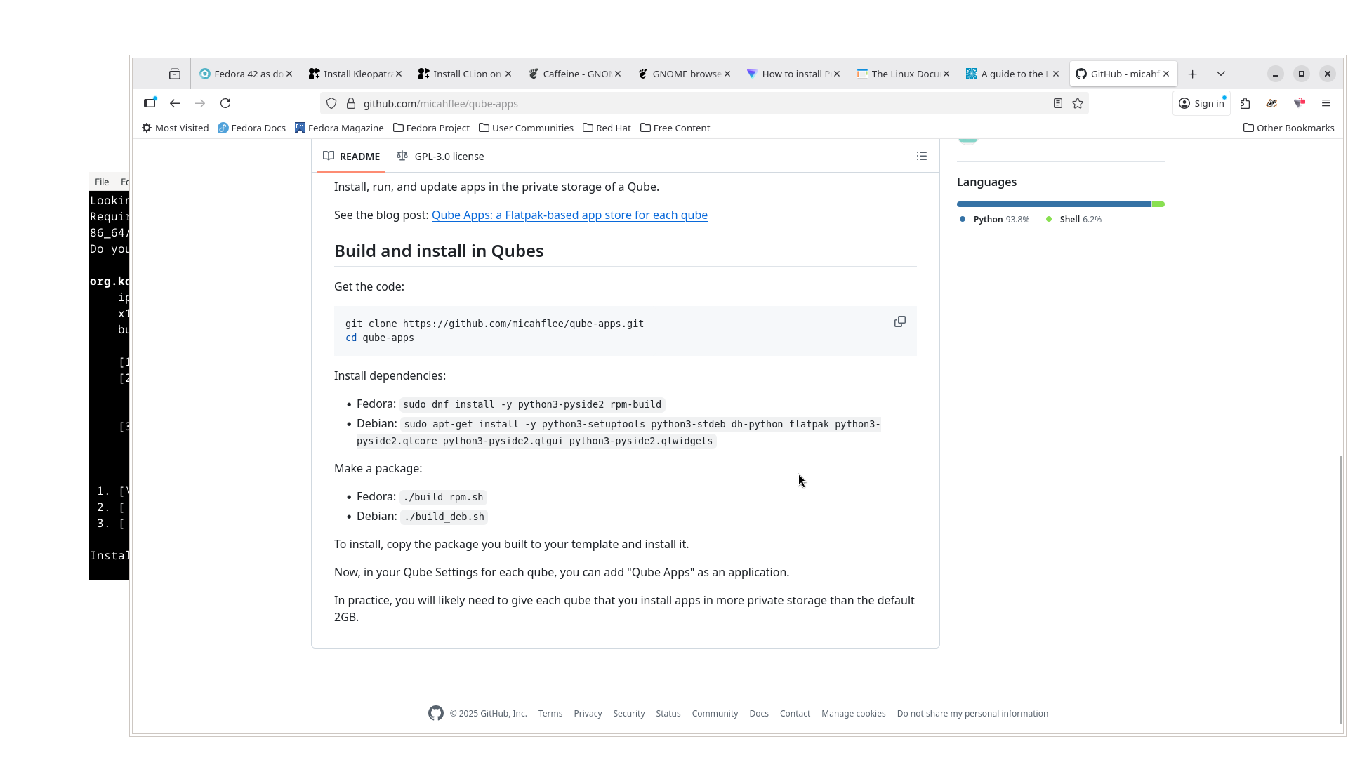

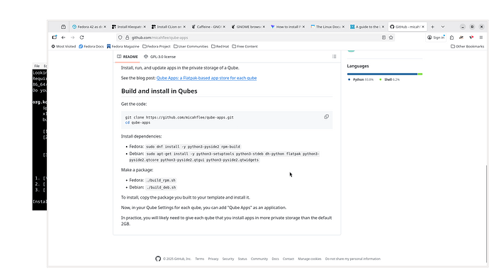

before i go check the dom0 terminal i’m on micahflee’s github the 1 who created a python script for all qube-apps right… and idk what i did wrong i copied the github code first, then install the dependencies after install the code … then it said make a package with ./build_rpm.sh and once i typed that code in after installing the fedora depend with
sudo dnf install -y python3-pyside2 rpm-build
my personal terminal went krazi and locked screen !

Micahflees
it went krazi wrong picture sorry… it just got me lost in the qubes-apps part i saw that it halfway installed it i guess . and i press ls, cd to make sure i was in the file with the directories .
i handled it correct all the way until
okay it got wrong on my end, with make a package and the command he put ./build_rpm.sh and wrong install , copy the package you build to your template and install it ??? how once i’m in the terminal i see the files build_rpm , and qube-apps inside the file itself in the terminal .
Don’t use it.
It’s very old app for QubesOS 3 or older.
It needs libraries from fedora EPEL9 which is old… really old.
There is no such package as python3-pyside2.
WIth python3-pyside6 it start build but then there is error with %changelog.
In sum - it don’t work.
Forget.
Go back to fix your personal qube. You can’t do 6 thing at the same time and with broken qube.
Idk if it says it because it do have D AppVm? In the Dom0 terminal I can’t screenshot it with clear pictures like from my personal template terminal
back to fixing my personal qube to make the apps persistent and stick i tried to get the clearest picture but why is the D so far spaced out if it’s disposable ? D AppVM
