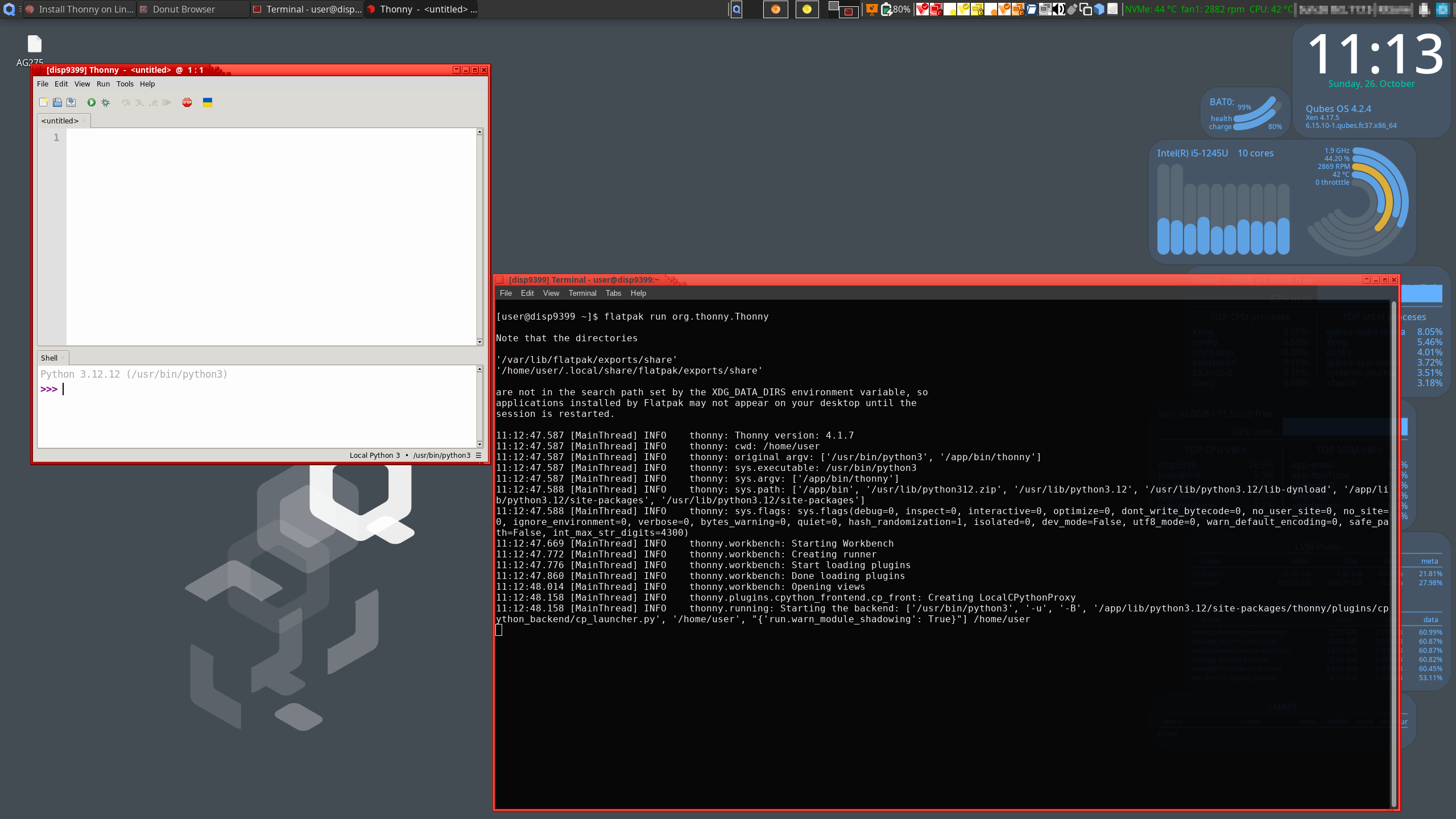

Now you open appVM terminal (always remember to add --user option to every flatpak command - it’s not added at flathub site):
[user@disp2978 ~]$
[user@disp2978 ~]$ export http_proxy=127.0.0.1:8082
[user@disp2978 ~]$
[user@disp2978 ~]$ flatpak remote-add --user --if-not-exists flathub https://dl.flathub.org/repo/flathub.flatpakrepo
Note that the directories
'/var/lib/flatpak/exports/share'
'/home/user/.local/share/flatpak/exports/share'
are not in the search path set by the XDG_DATA_DIRS environment variable, so
applications installed by Flatpak may not appear on your desktop until the
session is restarted.
[user@disp2978 ~]$
Now, still in appVM terminal install packages (remember about --user):
[user@disp9399 ~]$
[user@disp9399 ~]$ flatpak install --user flathub org.thonny.Thonny
Looking for matches…
Required runtime for org.thonny.Thonny/x86_64/stable (runtime/org.freedesktop.Sdk/x86_64/24.08) found in remote flathub
Do you want to install it? [Y/n]: y
org.thonny.Thonny permissions:
    ipc       network       x11       devices      file access [1]      system dbus access [2]
    [1] /media, /run/media, home
    [2] org.freedesktop.UDisks2
        ID                                             Branch                Op            Remote             Download
 1. [✓] org.freedesktop.Platform.GL.default            24.08                 i             flathub            144.7 MB / 145.4 MB
 2. [✓] org.freedesktop.Platform.GL.default            24.08extra            i             flathub             24.0 MB / 145.4 MB
 3. [✗] org.freedesktop.Platform.openh264              2.5.1                 i             flathub            294.1 kB / 971.4 kB
 4. [✓] org.freedesktop.Sdk.Locale                     24.08                 i             flathub            191.4 MB / 393.2 MB
 5. [✓] org.gtk.Gtk3theme.Adwaita-dark                 3.22                  i             flathub              4.7 kB / 1.5 kB
 6. [✓] org.freedesktop.Sdk                            24.08                 i             flathub            548.3 MB / 630.5 MB
 7. [✓] org.thonny.Thonny                              stable                i             flathub             18.9 MB / 26.7 MB
Warning: While downloading http://ciscobinary.openh264.org/libopenh264-2.5.1-linux64.7.so.bz2: While fetching http://ciscobinary.openh264.org/libopenh264-2.5.1-linux64.7.so.bz2: [7] Could not connect to server
Installation complete.
PS: Installing pyCharm is like ~1GB of dependencies and 1.3GB of IDE itself and my ISP is wonky today so installed Thony instead

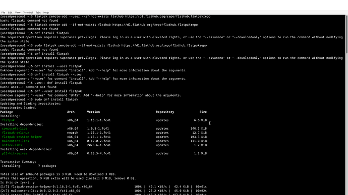

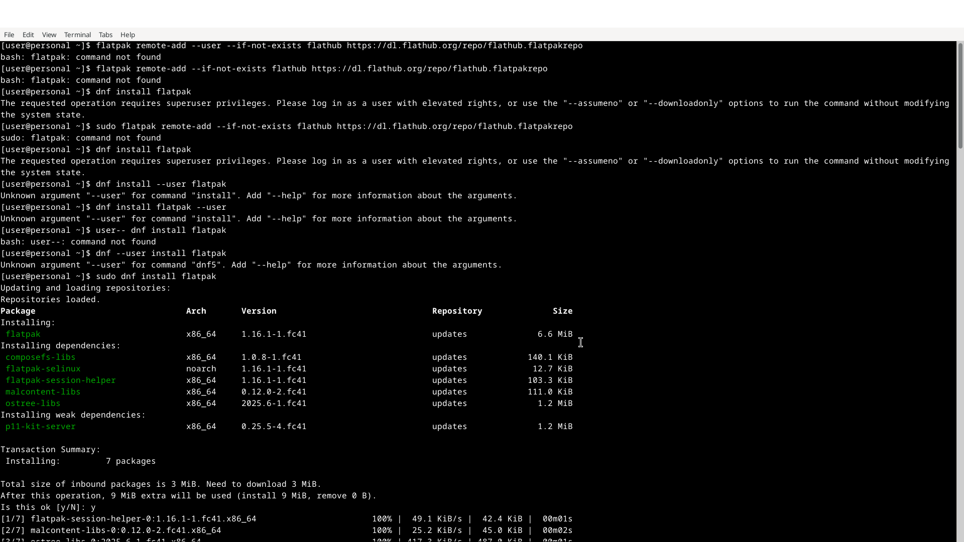

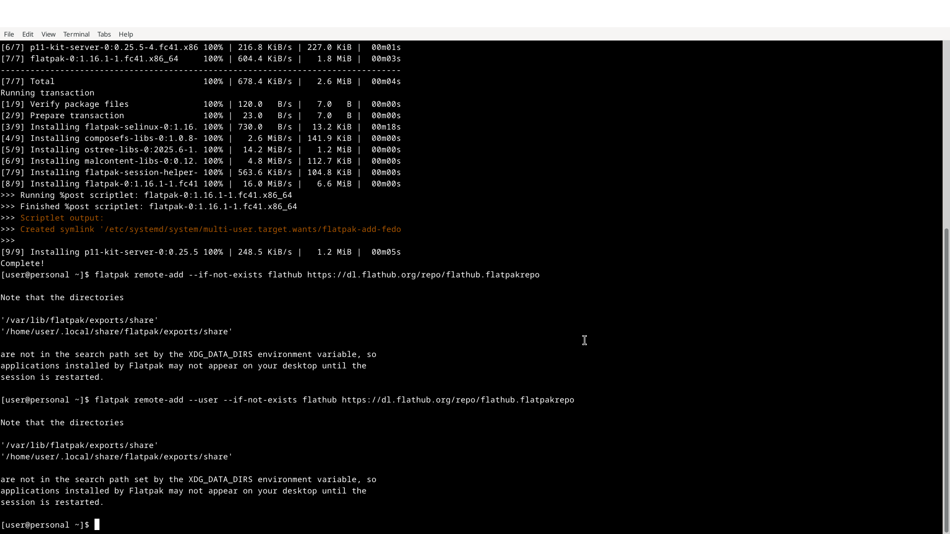

thank you i’m going to try all of these solution , i’ve literally tried everything from this forum to steam forum ,to stacks & developer forum , from fedora forum…i’ve read 30 pages since thursday its sunday… there has been no solution other than it’s something wrong with my dell latitude 5500 and it’s not like last year or a kernel is missing or i tried to add flatpak using sudo command… while in the other thread of fedora 38 , i was told to not type “sudo” and use flatpak remote-add --user … that command with --user does not work anymore i get :bash: command : user is not found.
that is literally the error i’m getting, even after typing dnf install flatpak command… or typing “sudo dnf install flatpak” then trying to addthe flatpak -remote-add --user --if-not-exists flathub command line… i’m getting this error with no help or progress. i restart qubes personal AppVM… heck i just restarted my whole computer with no progress…
because --user is not a command
I’ve seen that, you’ve typed
$ --user flatpak remote-add --if-not-exist
which is totally wrong, because --user is an option added to flatpak
You don’t do as you was told
you know what ,nobody in the other post told me to type the command in the middle post above - $ export http_proxy=127.0.0.1:8082 and press enter then type flatpak remote-add --user --if-not-exists flathub https://dl.flathub.org/repo/flathub.flatpakrepo … and i mean NOBODY never said type that export line what does that do ??
Because everybody assumes that you could at least do basic things in terminal.
Apps/commands in terminal are run like that:
command --options --long-options --arguments variable <destination>
where <destination> is either file or internet address

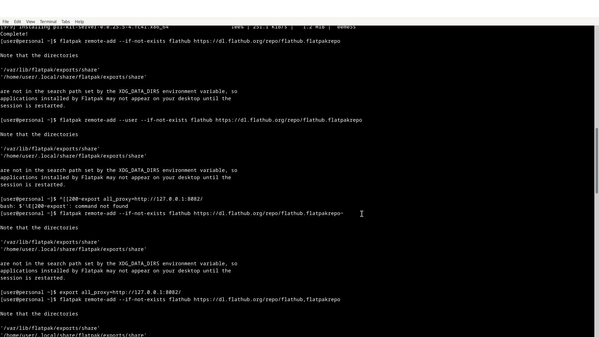

I believe in fedora 38 thread there was post that you need to use http_proxy - maybe without address because you’ve told that you used @solene guide where it’s stated how
that guide didn’t stated how lol… i literally found that on duckduckgo looking at stacks and change developer website and fedoras
it’s little different (different approach), but there is proxy
that 1 little proxy line just help me …that was what i was missing to type in the terminal the whole time i would have still been looking on every forums… thank you for typing it out like that .

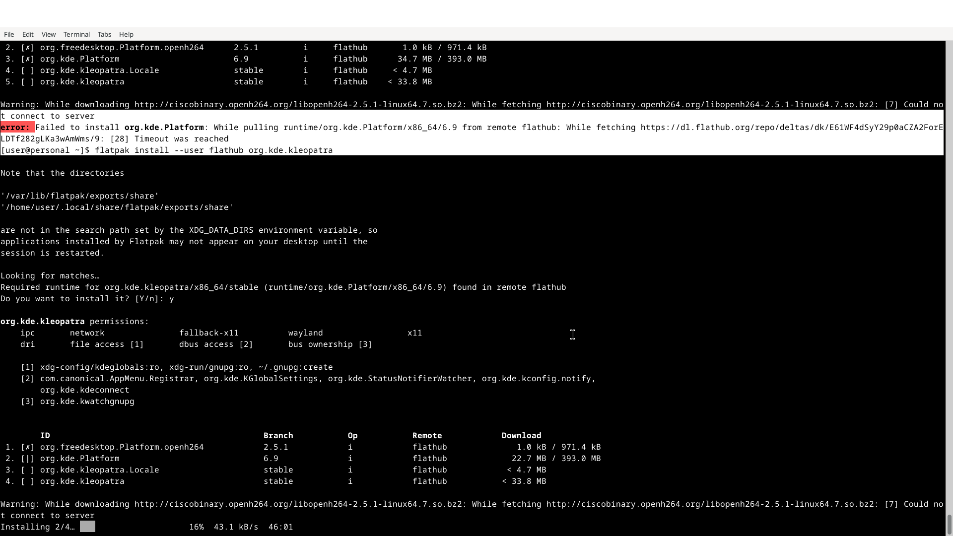

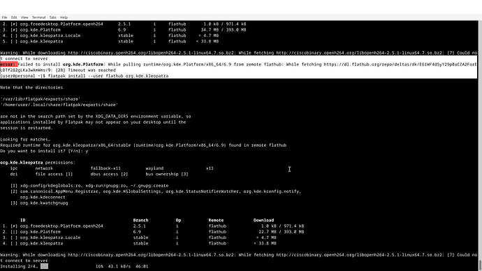

i have 1 more question for you . while downloading kde apps from flatpak like gpg kleopatra keys i get this krazi error.
do you think this is a network problem like my internet connection im checking it now in sys-net and it shows 80% to my wifi ? or is it another proxy 127.0.0 with the port issues i need to type in the terminal again ?
