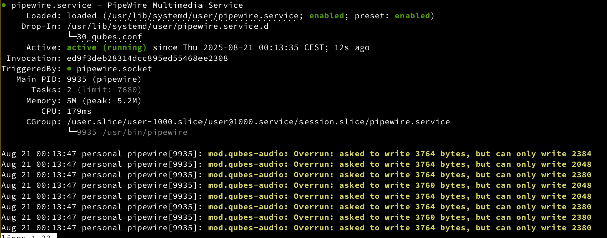

After using qubes for 3 weeks I am still facing issues with audio. After deep analysis, digging into pipewire, changing configurations, I am currently out of ideas what goes wrong. The only thing I have is this weird log of the pipewire service:
It fills constantly which kind of reflects the sound dropouts I am hearing (every second). My assumption is that the complete sound data cannot be sent via pipewire to my audiovm (sys-usb) and that is why I am facing this issue. The weird thing is also that this does not always happen. Sometimes the sound works and I have no issues, but most of the time it is not working correclty.

I also don’t think it is related to the headphones as today, after closing the lid of the laptop yesterday, the sound works again. This is what I also wrote above, that sometimes it works. The service status does not show any Overrun messages. So it seems there is a buffer or something else that overflows at some point and starting there the sound gets choppy. It would be fine for me to know which part of which qube I have to restart to get rid of this if it happens…

I have checked sys-usb top command while the sound cracks, and the whole qube is basically idle (2-5% pipewire). From a memory perspective round about 1GB is used out of 2GB. So I don’t think the resources are the problem. Also as mentioned above, today in the morning, after waking up the laptop, everything is fine. I bet that today in the evening I will face the same issue again. It seems that something gets bloated over time, but what and where…
