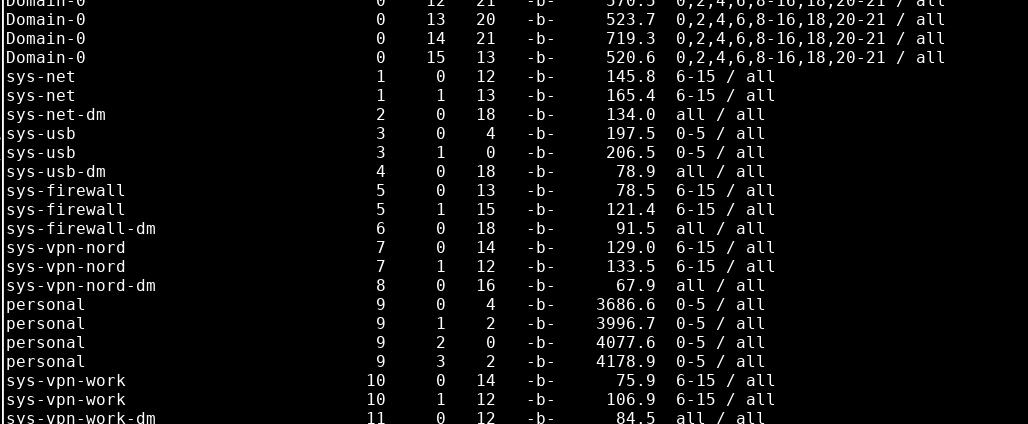

Hi all,
based on all the comments here I have implemented my own version of CPU pinning and am evaluating now if it helps. As you can see in this screenshot
sys-usb and personal are pinned to the performance cores of my processor (https://www.intel.de/content/www/de/de/products/sku/236847/intel-core-ultra-7-processor-155h-24m-cache-up-to-4-80-ghz/specifications.html). My understanding of this whole CPU pinning ist still limited, here are a few questions I have, maybe somebody can answer:
  • why does the list only show “even” processors being pinned? Is it because all of them have 2 cores?
  • why does Domain-0 in my case have all the cores pinned to it? I was assuming this is limited to 4?
  • what is the difference between hard/soft affinity?
  • why do I see a CPU index of 21? My processor has 16 cores only, not 21
  • what are these “-dm” domains? Does it make sense to pin them also?

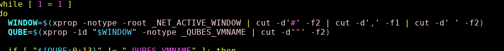

@Atrate
I initially wanted to use your script but I realized that it does not work with the default dom0 installation (not sure what i3 is though… :)). Therefore I followed the approach to implement a “while” loop in bash that runs every half a second (sleep 0.5) and extracts the current vm from these calls:
Maybe it helps to make your script work for the default dom0 configuration.
I will report back if the audio problem occurs again of if it gets solved with the CPU pinning. In case it is not there are few other hints in the comments above, will try those also if required.
Thanks all for reading/commenting here!
A lot of your questions about affinity be answered by: https://wiki.xenproject.org/wiki/Tuning_Xen_for_Performance
As for the even CPUs and the 21 index it’s because of hyperthreading. The indices you see are assigned to threads. Qubes disables hyperthreading (SMT), so the cores that could be hyperthreaded will show up as 1 thread while skipping the other index (so your p-cores are “even” only).
About dm domains: https://wiki.xenproject.org/wiki/Device_Model_Stub_Domains . I haven’t checked what pinning/unpinning them does, but they should only show up for HVM domains or ones with PCI passthrough (one of those conditions, I don’t remember which).

Not sure I understand the statement “so your p-cores are “even””. Is the range I am pinning (0-5) wrong then? Should it be something like “0,2,4,6”?
Pinning a range works, the odd numbered cores are disabled so Xen won’t use them.
Ok, yes, but the question is, what is the range (in my processors case) to pin to ALL performance cores? Theoretically, if odd ones are skipped, it should be “0-10”? My CPU has 6 performance cores.
The correct range is 0-11 to have all P cores, you have 0, 2, 4, 6, 8, 10 and their hyperthreading siblings 1, 3, 5, 7, 9, 11.
Without hyper threading (it’s disabled by default anyway), you could use 0-10 too with the same result.

Not fully sure you’re correct about the 155H. From my research, the layout is weirder than that:
Oh, that is really weird… But thanks for the info, should be easy to map it though :slight_smile:
@Atrate I have asked for a possibility to listen to focus change events in xfce and the first link in this answer Any way to listen to events? / General discussion / Xfce Forums points to this:
xprop -spy -root -notype _NET_ACTIVE_WINDOW
It basically prints the property change which then in turns can be read, parsed and transformed to the current domain via
xprop -id "$WINDOW" -notype _QUBES_VMNAME
Maybe this is an option for you, without a loop and polling :slight_smile:
