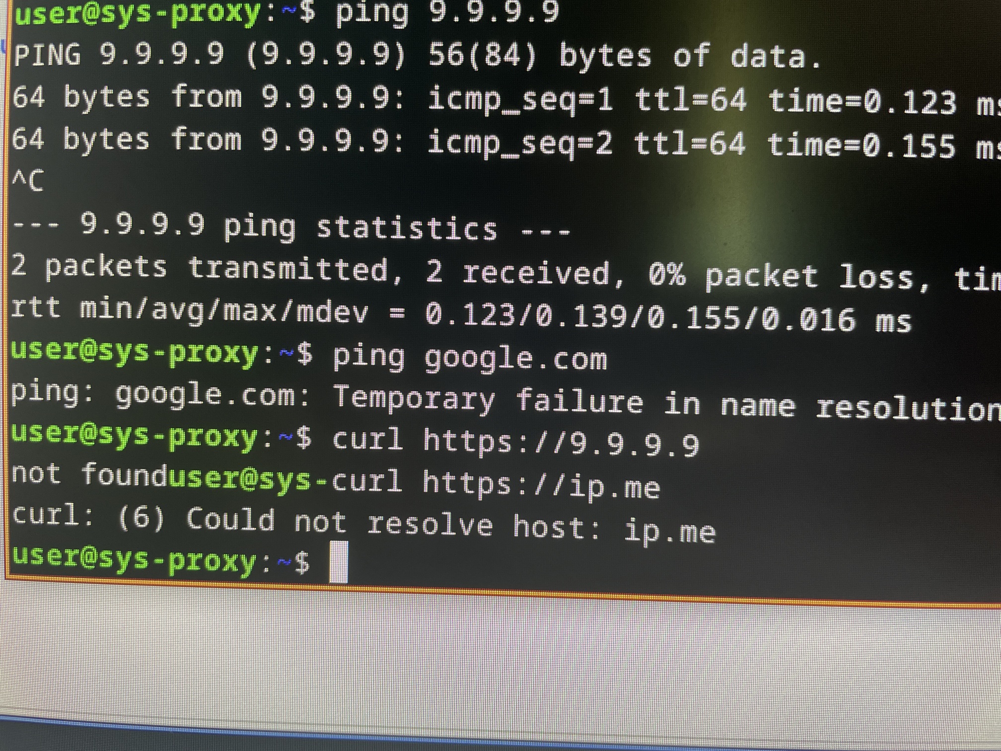

The I’ve tried to go to some websites, none of them could open. I can’t ping any domains (“tenporary failure in name resolution”). That’s it.

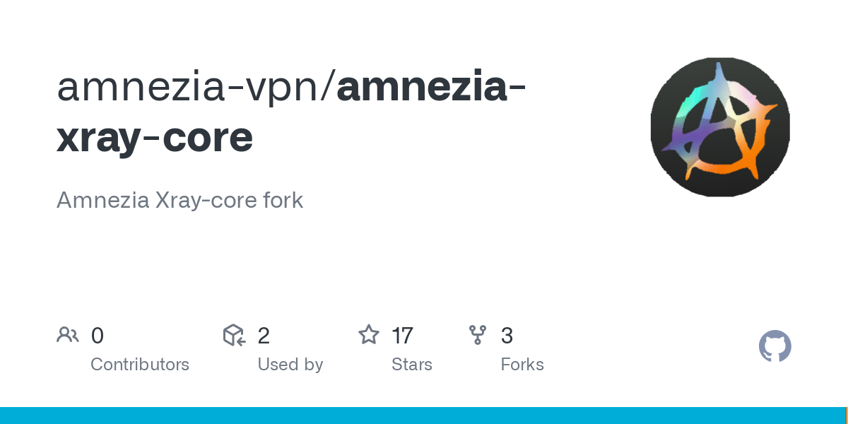

Now I got it, I thought you’re using xray-core with amnezia:
Post the output of these commands in sys-proxy:
cat /etc/resolv.conf
resolvectl
sudo nft list ruleset
You can edit the output of these commands to change your server public IP address to some random string you’ll have it there.
user@sys-proxy:~$ cat /etc/resolv.conf
nameserver 1.1.1.1
nameserver 1.0.0.1
user@sys-proxy:~$ resolvectl
bash: resolvectl: command not found
I’ve tried to change resolv.conf to 1.1.1.1 and 1.0.0.1, but it didn’t help. It was different before that.

Check if the DNS resolution will work in the qube connected to the sys-proxy.
oohhh bruuuhh… it works. I’m not sure if it would work if I haven’t changed resolv.conf, but it works in other qubes. Thank you. Finally can connect to TOR
No idea why DNS resolution doesn’t work inside sys-proxy, it should be something specific to AmneziaVPN.
You can configure DNS resolution for qubes connected to sys-proxy like this (add the commands in /rw/config/rc.local of sys-proxy):
thank you, yeah, I’ll definitely try to set up dns, Amnezia has a function with its own dns on my server where VPN is hosted, and I’ll be able to connect to this DNS if I’m connected to the VPN.
Is it good?
To set up dns, is it better to do in sys-proxy or in other qubes which are connected to it?
Yes, if you have DNS server running on your VPS, then you can use it in sys-proxy. Change 9.9.9.9 used in the link above to your VPS private IP address in VPN e.g. 10.8.1.1.
You should configure DNS in sys-proxy.
Hey, I don’t know why, but it’s not working. It was working, but I turned the pc on today and it’s not working. There’s an issue in DNS, I’m sure in that.
So, I’m using Xray with Amnezia GUI official app. When I’m connecting to the vpn, I can’t ping any domain, ips are good. When I’m disconnected, it all works. I’ve tried to change resolv.conf to 1.1.1.1 and 1.0.0.1, but when I’m restarting this qube, it changes to default 10.139.1.1 and 10.139.1.2
When I change it to 1.1.1.1, I still can’t access any domain, but I guess it’s because the Network Manager should be reloaded. But when it reloads, I receive default values.
I’ve tested DNS in both sys-vpn (I renamed from sys-proxy) and in other qubes which uses sys-vpn.
I can’t add VPN connection through normal Network Manager as there is no Xray, and WG or OpenVPN are blocked in my country.
Follow the guide that I linked before:
Ok, do I need to write this command in sys-vpn or in dom0?
Oh, I guess I need to write it here? in /rw/config/rc.local?
Yes.
I did it like this, but still doesn’t work in sys-vpn nor in other connected qubes.
What’s the output of these commands in sys-vpn?
cat /rw/config/rc.local
cat /rw/config/rc.local:
#!/bin/sh
# This script will be executed at every VM startup, you can place your own
# custom commands here. This includes overriding some configuration in /etc,
# starting services etc.
# Executable scripts located in /rw/config/rc.local.d with the extension
# '.rc' are executed immediately before this rc.local.
# Example:
#  /rw/config/rc.local.d/custom.rc
# Example for overriding the whole CUPS configuration:
#  rm -rf /etc/cups
#  ln -s /rw/config/cups /etc/cups
#  systemctl --no-block restart cups
DNS=9.9.9.9
nft flush chain qubes dnat-dns
nft add rule ip qubes dnat-dns \
	meta l4proto { tcp, udp } \
	ip daddr {10.139.1.1,10.139.1.2} \
	th dport 53
	dnat to "$DNS"
echo "nameserver 9.9.9.9" > /etc/resolv.conf
