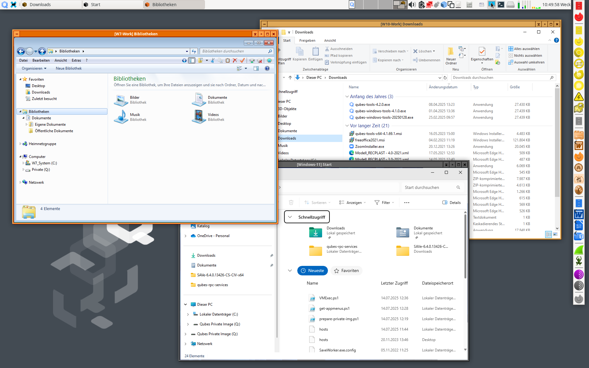

Just for fun, here’s a screen shot of the new QWT running the Windows Explorer in Windows 7, 10, and 11. For Windows 7 and 10, it’s in an AppVM based on a template with QWT, and for Windows 11, it’s in the template itself, because the AppVM is quite unusable.
