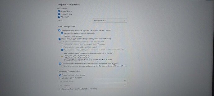

From the logs, it seems you installed Qubes OS, then had the “qubes os post installation” process that asks for templates to install and qubes settings, twice?
At 17:05:30 anaconda seems to try again to create the LVM pool…
I’d just reinstall and see if it works better :woman_shrugging:
I installed Qubes 3 times today. I don’t know if the error is from the hardware or from the system
do you get this screen exactly once? What if you uncheck debian and whonix?

I saw this screen twice and yes I chose only Fedora

this seems very wrong, I wonder why it appears twice…
If someone could try 4.2.1 installer, that would be nice, maybe it’s borked… there was no Release Candidate for it AFAIK…
