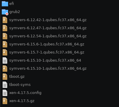

Unable to recreate grub boot entry
I did something incredibly stupid, again.
Running sudo qubes-dom0-update --action=reinstall $(rpm -qa --qf '%{NAME}\n') which results in reinstalling every package, completely destroyed my grub menu, again. Mostly worked with two exceptions related to kernel packages, but I don’t remember the exact error message. Didn’t cared much, as I had plenty of other kernels for booting if something fails. Well…
Because I already had some experience with grub related issues, I wrote the Qubes Iso to an USB, entered the grub rescue mode, mounted everything and tried to run grub2-mkconfig -o /boot/efi/EFI/qubes/grub.cfg though this didn’t helped. In second instance I tried reinstalling the packages again since they are still cached so that other kernels could write themselves into the grub menu. And actually I received the output that I got an new boot entry but when testing it, it still just shows one entry, the UEFI Firmware Settings instead of Qubes.
What shall I do? (besides being more careful)
Here my /boot folder:
Honestly, I don’t think it will help, but running grub2-mkconfig -o /boot/efi/EFI/qubes/grub.cfg is not exactly the correct way to update the grub menu, so, maybe you can try the following?

Still just shows UEFI Firmware Settings after reinstalling grub, trying an older .cfg and regenerating the initramfs.
To make it more easier, how can I add Qubes in Grub from another HostOS?

I will try it tomorrow though I think there is a communication mistake:
UEFI has a functioning Qubes entry. My Bootloader/Grub hasn’t. Usually there are three options, booting Qubes, booting Qubes but advanced and UEFi Firmware Settings. The first two are missing.

Hard to tell at this point, get into the grub shell and try to load this configuration manually, see what happens:
configfile (hd0,gpt4)/boot/grub2/grub.cfg
The grub shell just resets itself. I’m close to giving up, but before I want to redo everything I tried so far in case of an misstake.
If you/anyone has any new idea, you’re welcome.
I am goood at those!
Looking at yout boot dir listing, I do not see any vmlinuz files (or whatever is the Dom0 kernel), and no initrd files, either.
Can you install a kernel or two? Then you may need to run dracut, and then remake grub… but the kernel installer may take care of that.
So fucking thank you, it appears that dnf reinstall deleted the vmlinuz files while not recreating them. Uninstalling and installing the kernel solved the issue.
