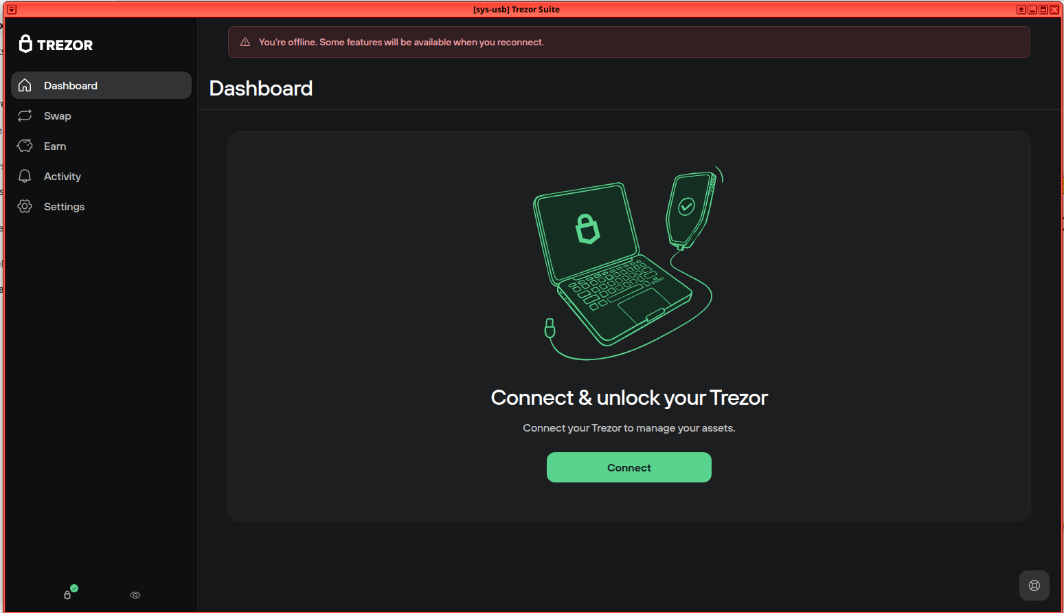

TrezorSuite gets me following erro: App can’t communicate with device
As a solution it says try restarting computer.

The app starts loading but my amounts never load. It’ll say connect and then I connect the wallet and assign it to the trezor suite appvm but it just loads forever.
I used gpt to help me ask the terminal where it’s at and what its pathway is. It led me off track with old bridge ideas to install which are deprecated. Need help fixing it asap. chat gpt leads me down incorrect rabbit holes a lot lol. I’m pretty sure it actually does have something to do with this. I can’t figure it out tho
This is what gpt recommended. And I know with its help we found where it was. Idk if it’s an executable pathway. I’m not sure on much of this lol

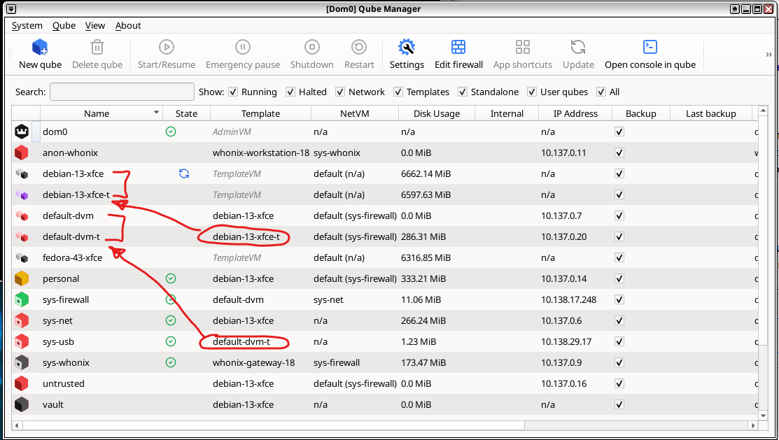

  3. In Step 4 - part 4: It is difficult to change the template of sys-usb. Do not shut down sys-usb or you will loose your mouse and keyboard. Use the following command from dom0:
qvm-shutdown --wait sys-usb; qvm-prefs -s sys-usb template fedora-37-sys-dvm; qvm-start sys-usb
