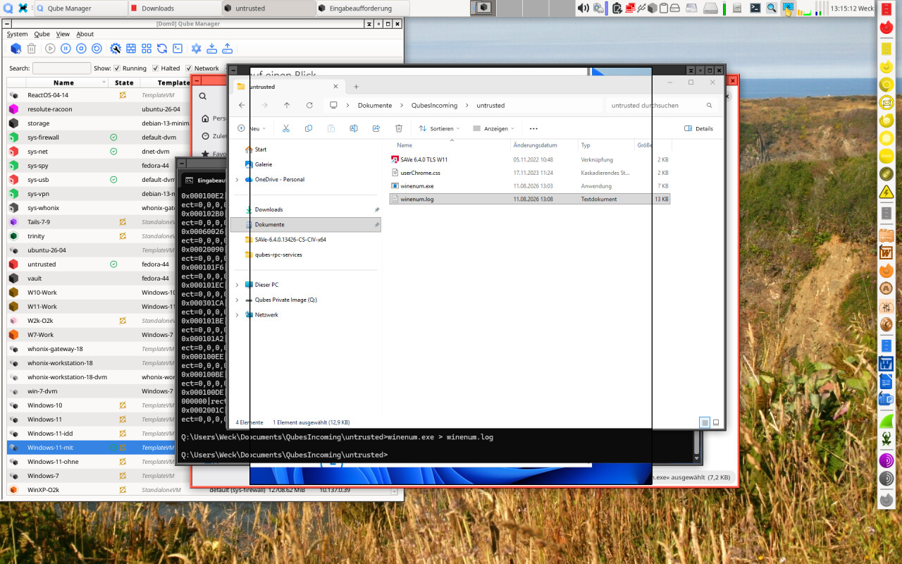

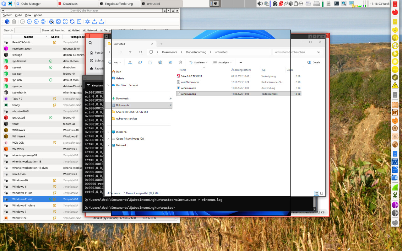

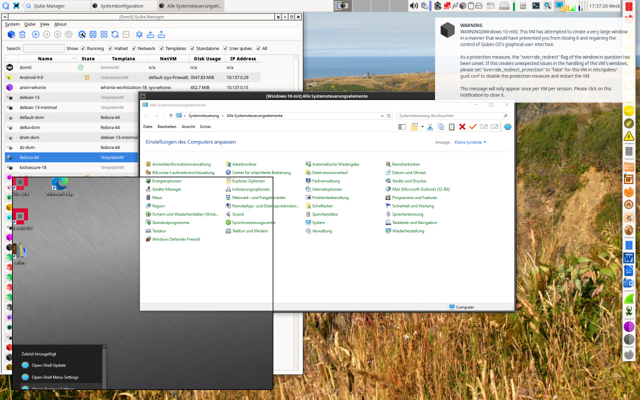

  • The vertical position, where the mouse pointer is shown, is about 1 cm below the position where Windows believes it to be:

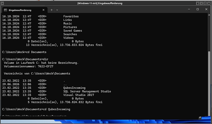

  • Also, the position in a text window was lost:

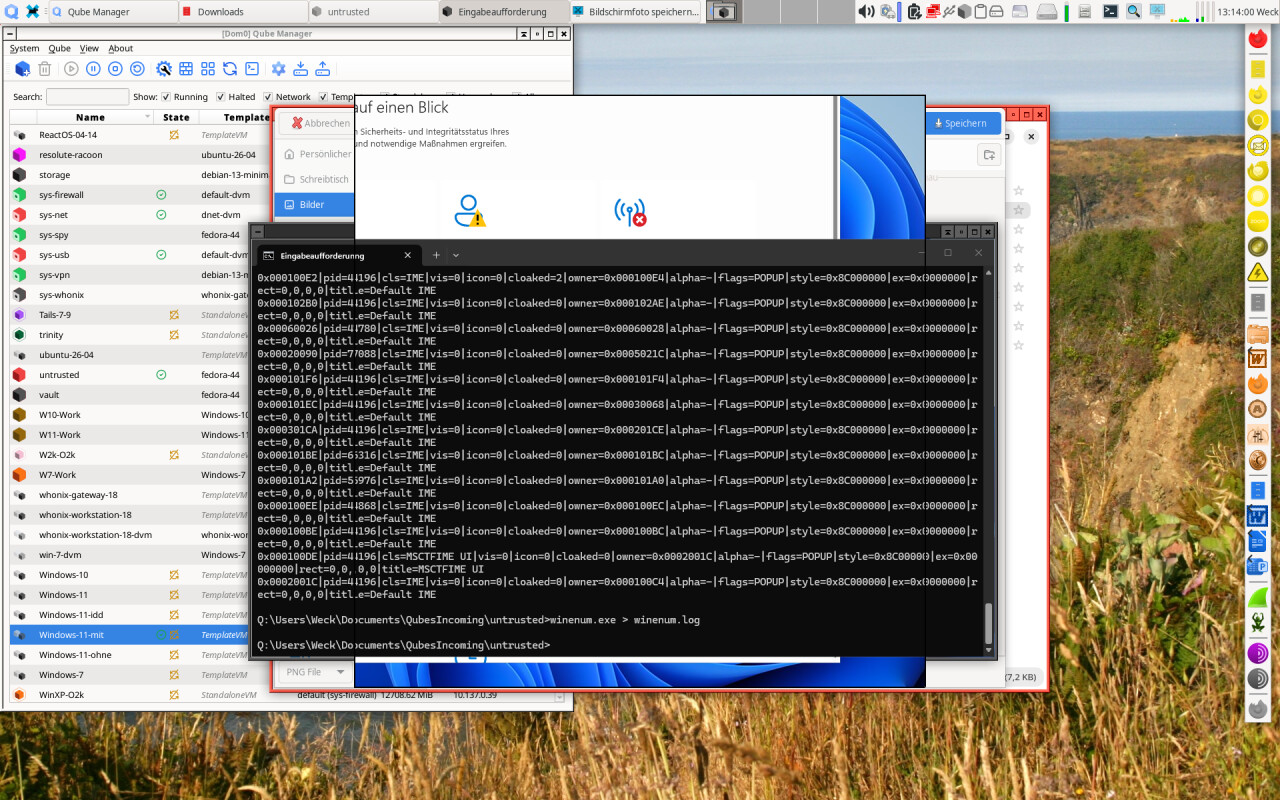

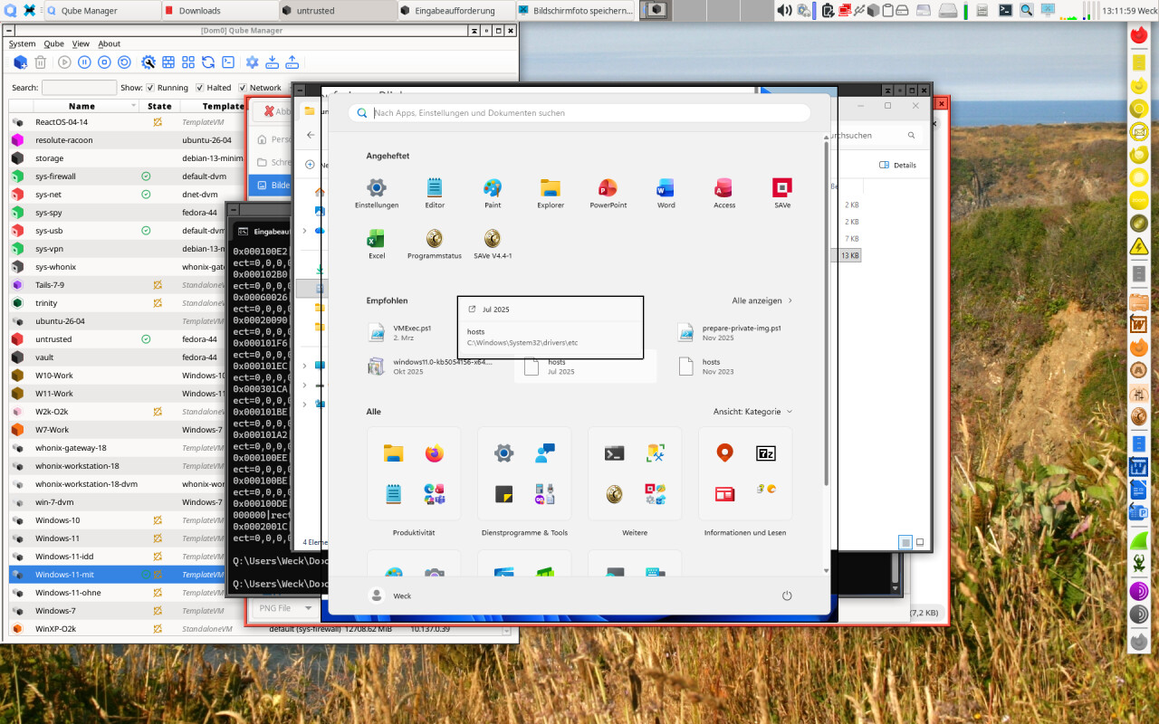

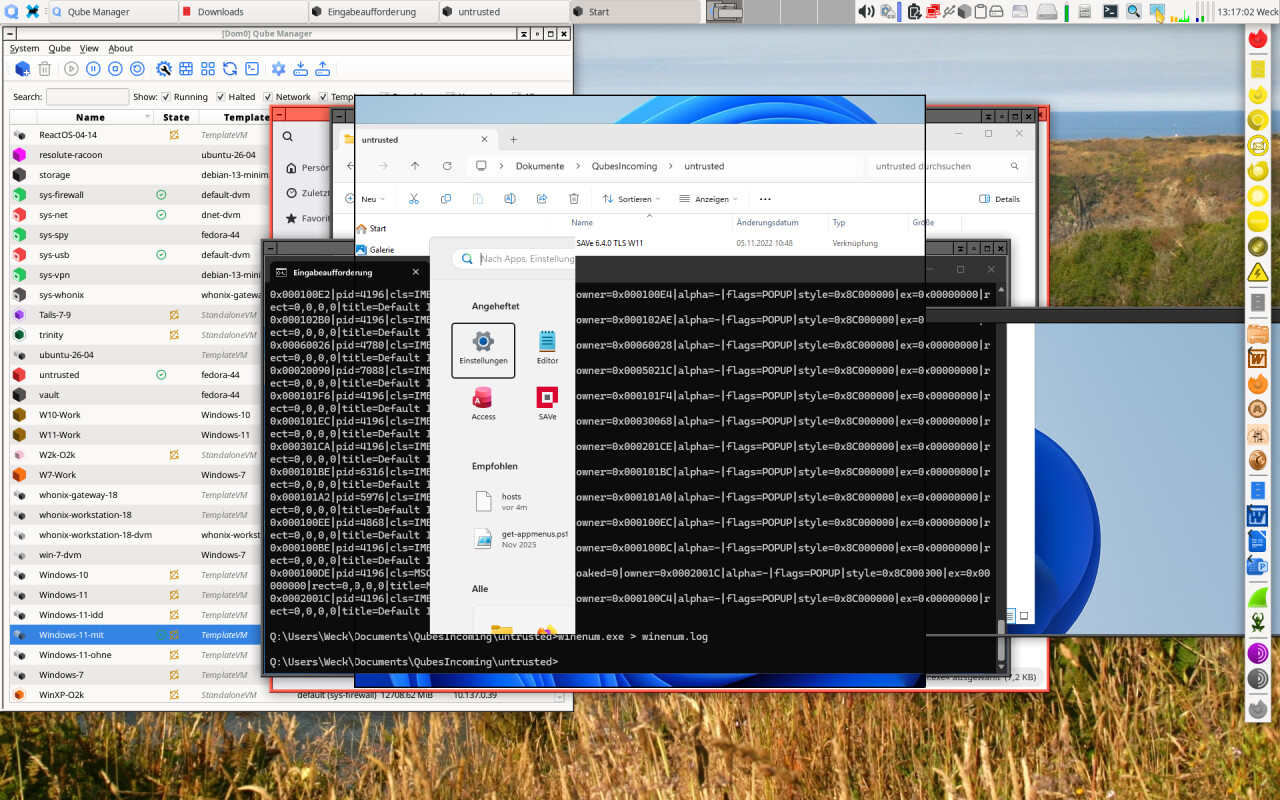

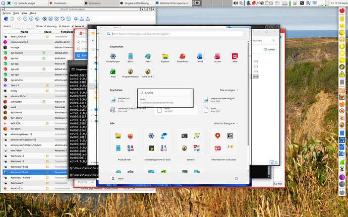

  • The Windows key produced some weird pictures, but no usable menu:

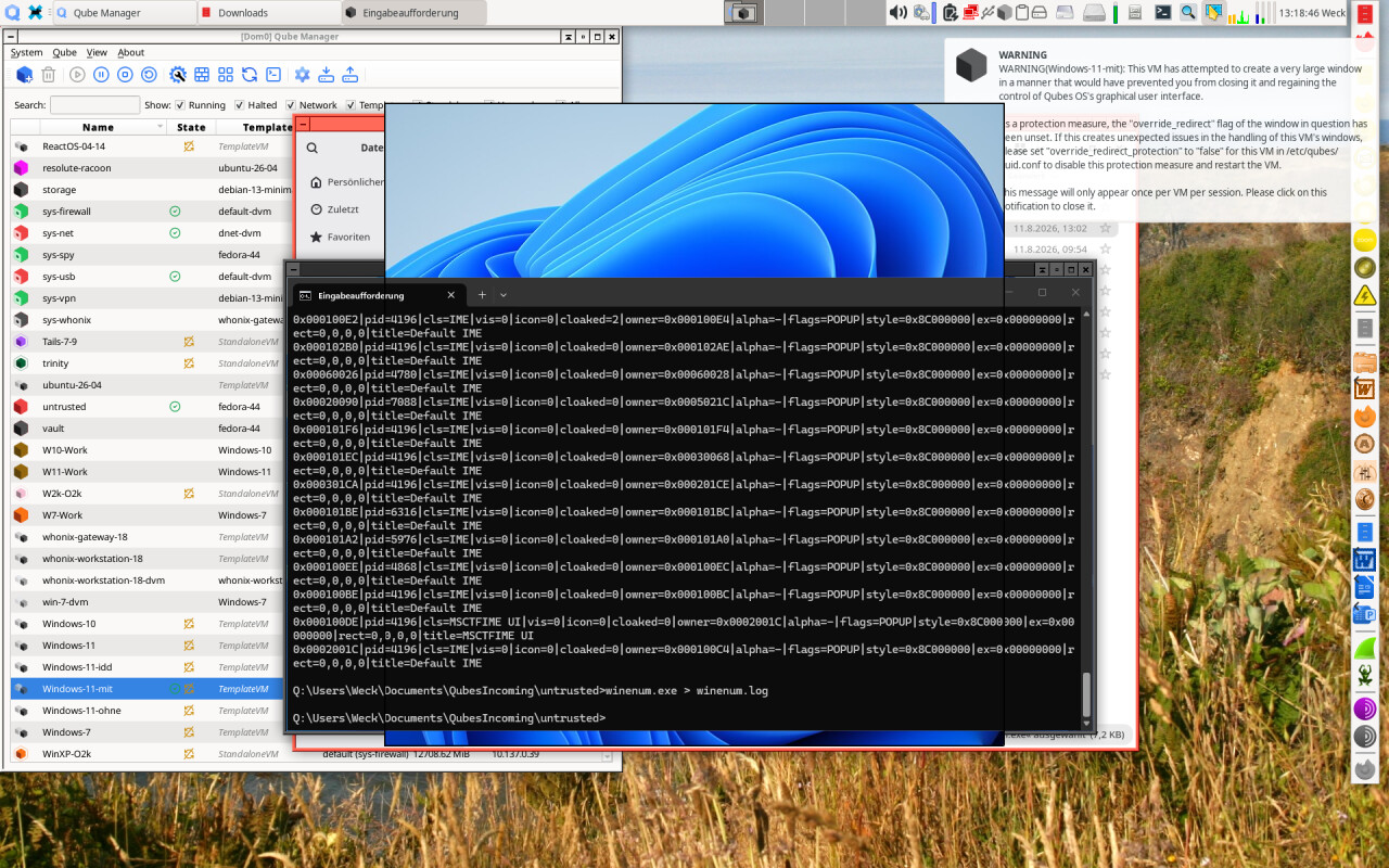

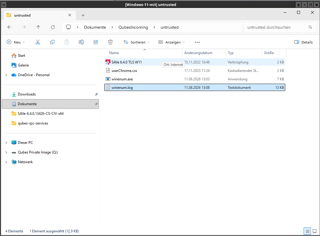

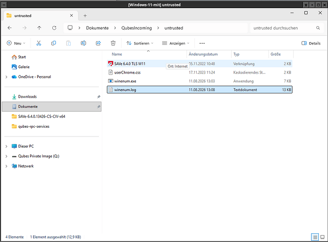

  • Finally, here’s the output of winenum.exe
    winenum.log (12.9 KB)
I hope that helps a bit!

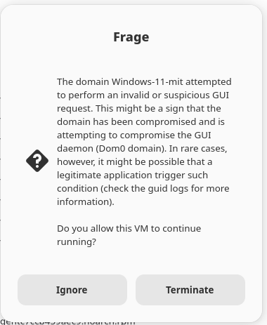

I just tried it once again and got the following error when using the Windows key:
weird. i am on it, stay tuned. however, this all (except the last message) looks like artifacts of non-idd legacy driver.
reproduced, working on a fix. indeed some stuff is 25h2 specific. trying to figure out generalized solution just in case Microsoft changes something big again.

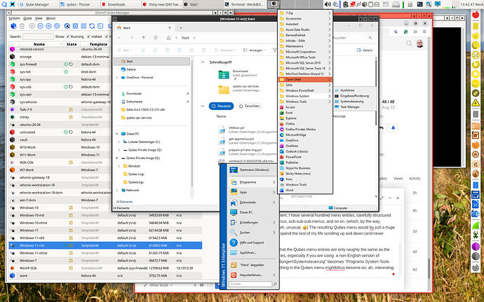

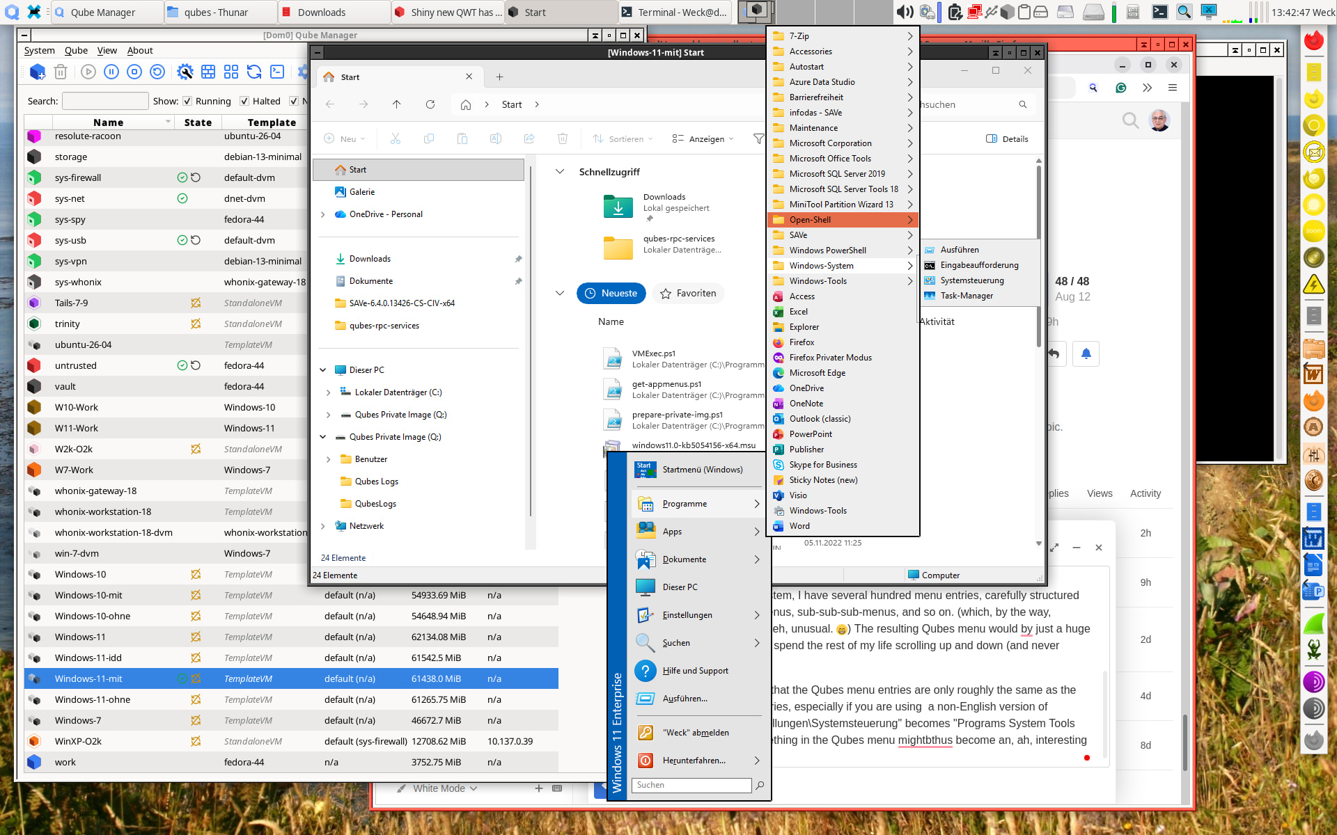

However, not all is lost. If you install the open source tool Open-Shell in Windows, you get a decent, workable menu preserving the original structure and having the correct margins:
This was in Windows 11 25H2 with the QWT version 09b643e5d278, just after installation of Open-Shell and pressing the Windows key, and it worked right out of the box!
Could this be an option in the QWT installer, or could the installer give at least some advice on using that tool? That would be great and preserve the functionality of the Windows keyboard key!
Will check! Nice, no overlap artifacts, everything is rendered correctly on your side?

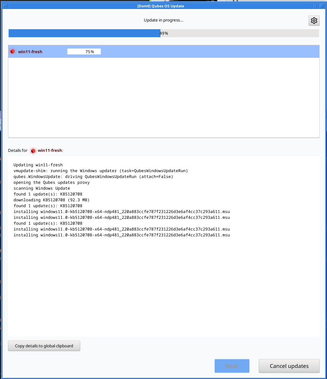

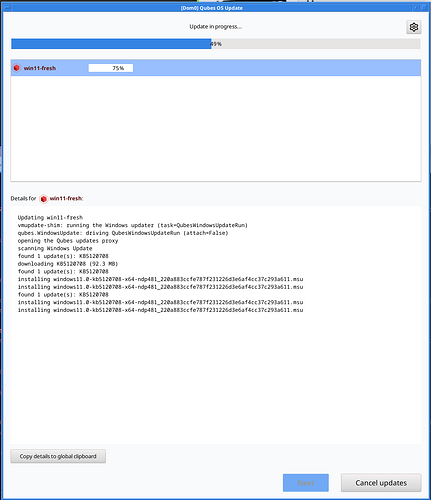

Meanwhile, sneak peek (you would not believe how much ugly machinery was required to keep this entirely template-side, Qubes updater strongly believes the guest must be unixlike), duplicate message bug already fixed.
How did you get Windows to use the Qubes updater at all? I’ve never succeeded with that.
Pure voodoo. The updater injects a python script assuming it is Linux, the receiving qrexec agent environment responds early to some hooks and produces expected output, progress, errors, scheduled reboots, FIXING THE DAMN AUTOLOGON 100TH TIME etc :)). Ugly af, but I am deliberately not touching any dom0 surface to avoid security implications. I did not mention that update proxy interface did not exist in stock qwt either? :slight_smile: Architecturally, btw, I think all guest systems would had benefited from uniform update service agent instead of dom0 making weird assumptions about what target system is.

I have now checked both Windows 10 22H2 and Windows 11 25H2 with Open-Shell installed, using the version 09b643e5d278 from August 10 of QWT. (I could even install Open-Shell after the main part of the QWT installation, just before the reboot.) So far, I found no problem at all with that, in both systems: no artifacts, draggable Windows, correct and working menus. It’s just what I hoped would come!
There’s even one thing that might be regarded as perverse: Open-Shell allows you to open the original Windows menu - and it is displayed correctly and is working!!! :+1:
