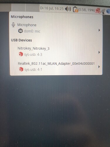

When I turn off sys net and Try to add my wifi dongle as a device it does not show up, is it because the driver is just for debian 10? On my usb devices icon (on the top of my desktop I can the the wifi dongle and can add it to sys net, but this is the wrong way right? I am also confused what the network manager is, is it the icon on the top right with to laptops?

That’s the correct way. You need to attach your Wireless adapter from sys-usb to sys-net using Qubes Devices widget to be able to use it in sys-net.
Yes.

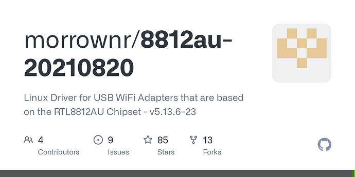

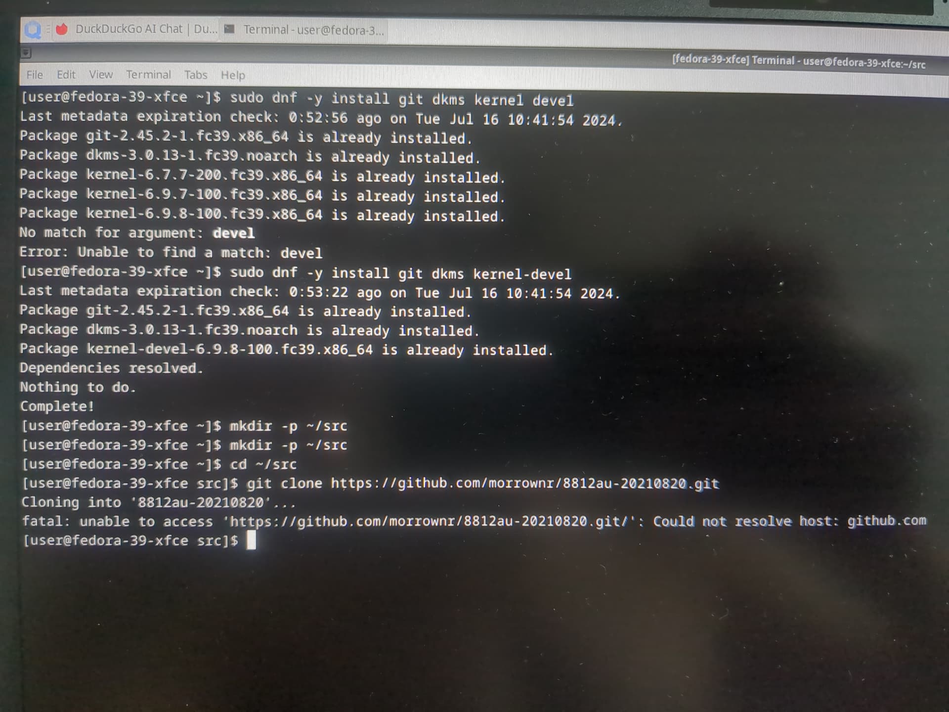

Hi, I tried the github installation guide, but It stopped Working at this ponit:
Restart fedora-39-xfce template to apply the changes in the template.
Open any app qube based on fedora-39-xfce (e.g. disposable) with network access.
Clone the repository in this qube:
git clone https://github.com/morrownr/8812au-20210820.git
Copy the 8812au-20210820 directory to the fedora-39-xfce template using file context menu in File manager or using qvm-copy command in the qube’s terminal.
The copied 8812au-20210820 directory will be in ~/QubesIncoming/QubeName/8812au-20210820 in your fedora-39-xfce template.
Move to this directory and continue installation:
cd ~/QubesIncoming/*/8812au-20210820
I did not test but git can be configured to use an http proxy, so this should allow git clone to work in templates
git config --global http.proxy http://127.0.0.1:8082

You need to attach your WLAN Adapter from sys-usb to sys-net using Qubes Devices widget here:
Then click on the Network Manager icon in tray (2 red PC icons) and if your WiFi interface is working then you should be able to connect to your WiFi AP there.

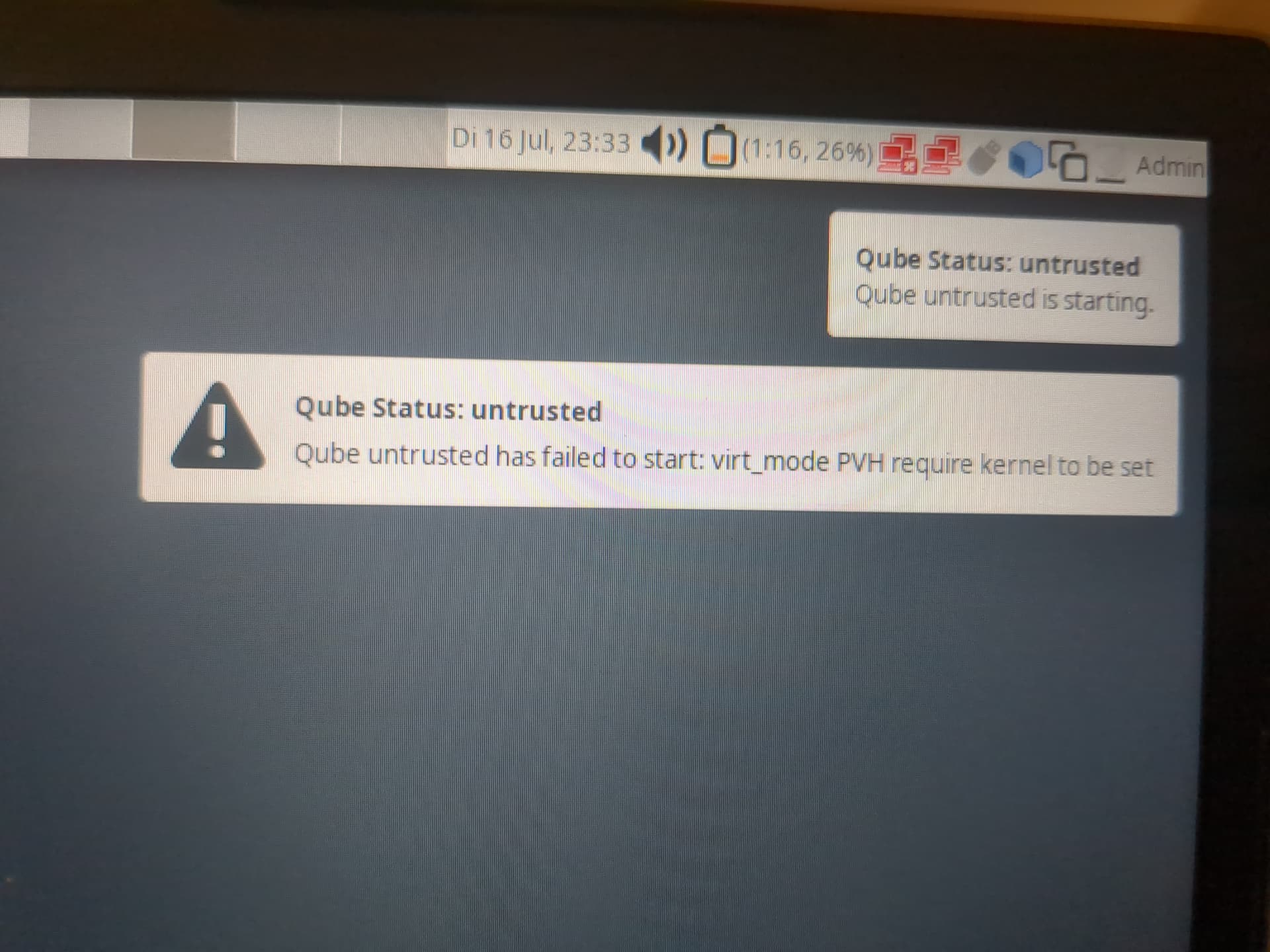

hi thanks, I wanted to try it, I changed the kernel option like recommended, but now I can not start any fedora based qube and not my template, when I go back to Kernel default in my template fedora i can open my qubed on provided bx qube (current) this error occurs:
in all three cases cases
  1. in fedora template kernel provided by qube)+ attach via usb devices manager the dongle to sysnet
  2. kernel = default + attached to sysnet
  3. clicking on network manager on sys usb
on network manager there is no network devices avaible
Change the fedora-39-xfce kernel back to default from (provided by qube).

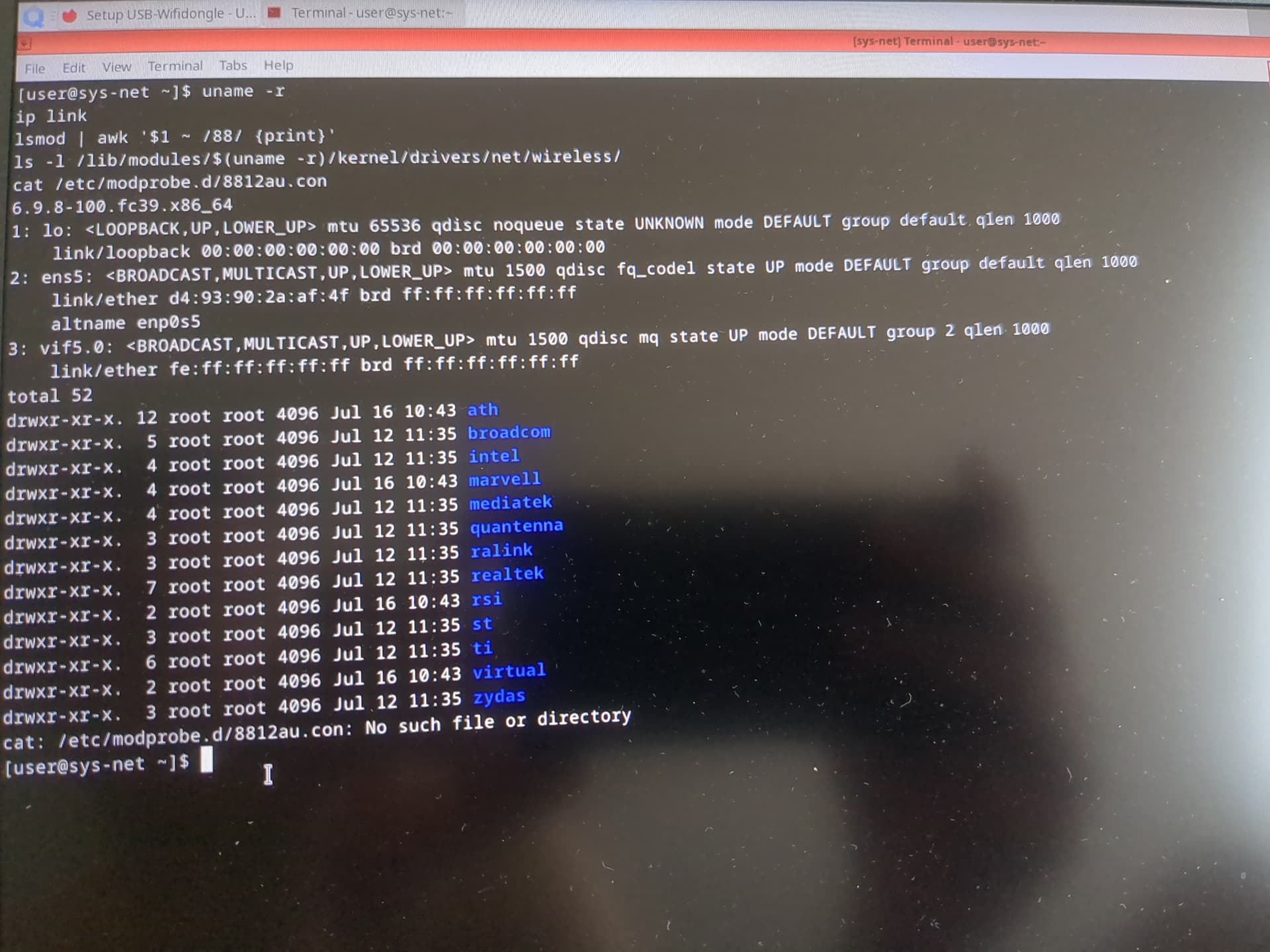

What’s the output of these commands in sys-net with WLAN Adapter attached to it?
uname -r
ip link
lsmod | awk '$1 ~ /88/ {print}'
ls -l /lib/modules/$(uname -r)/kernel/drivers/net/wireless/
cat /etc/modprobe.d/8812au.conf
this is the result:
It seems that the driver is not installed for this kernel since 8812au.ko file is missing in /lib/modules/$(uname -r)/kernel/drivers/net/wireless/.

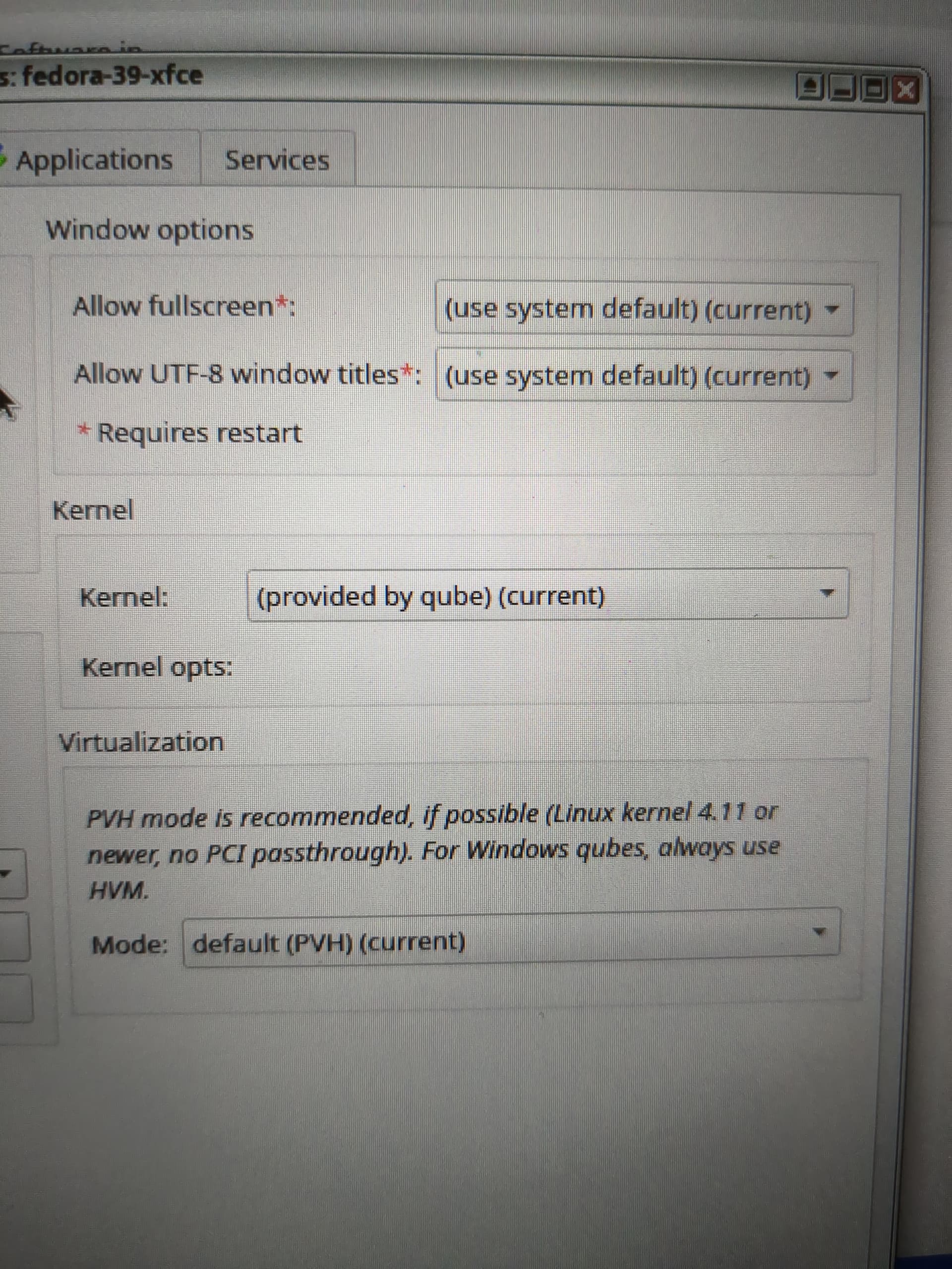

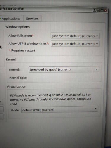

When I set the fedora-49-xfe template kertel set to (provided by qube) this error occurs:
And I cant even open my terminal to install the driver

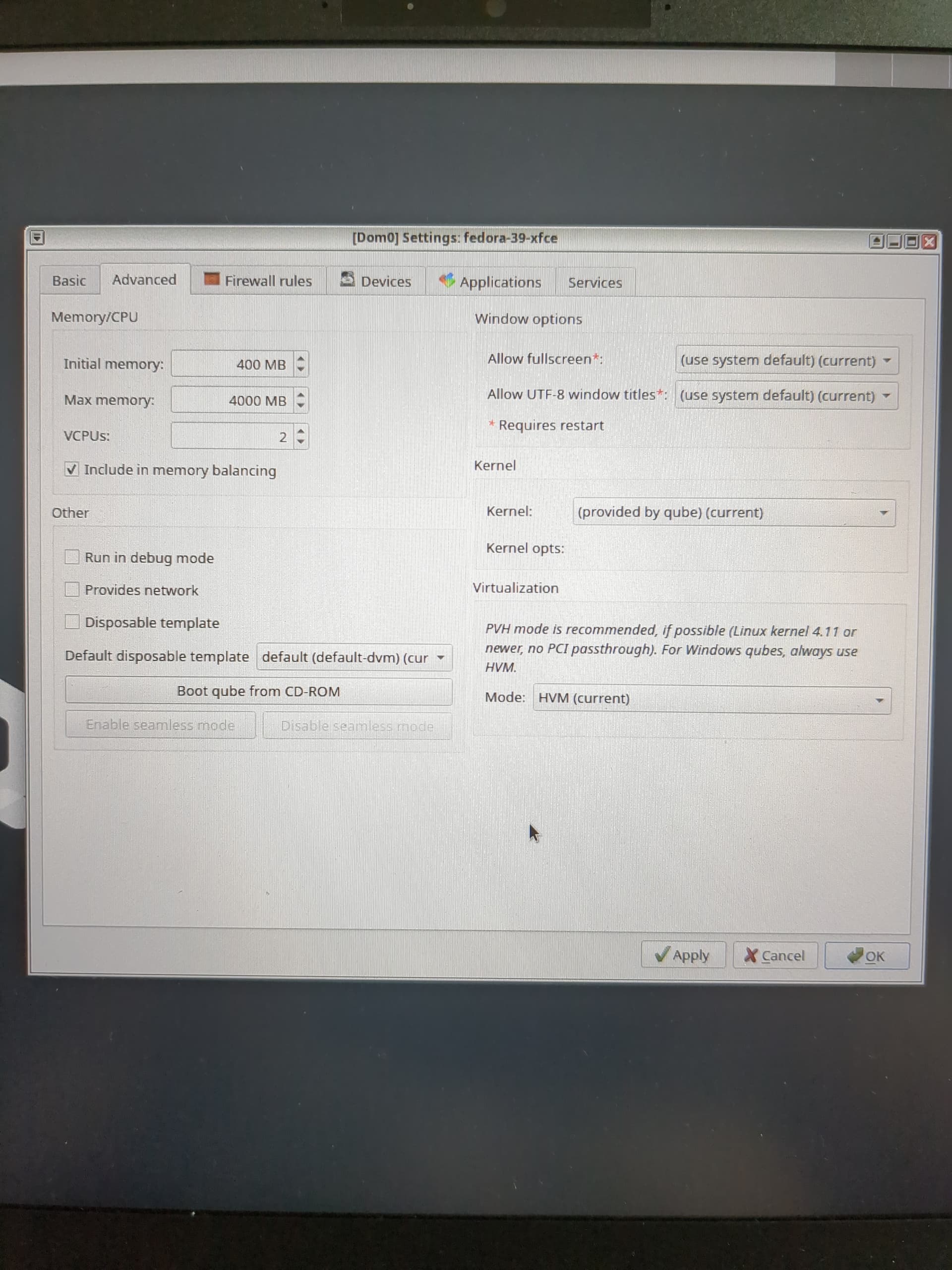

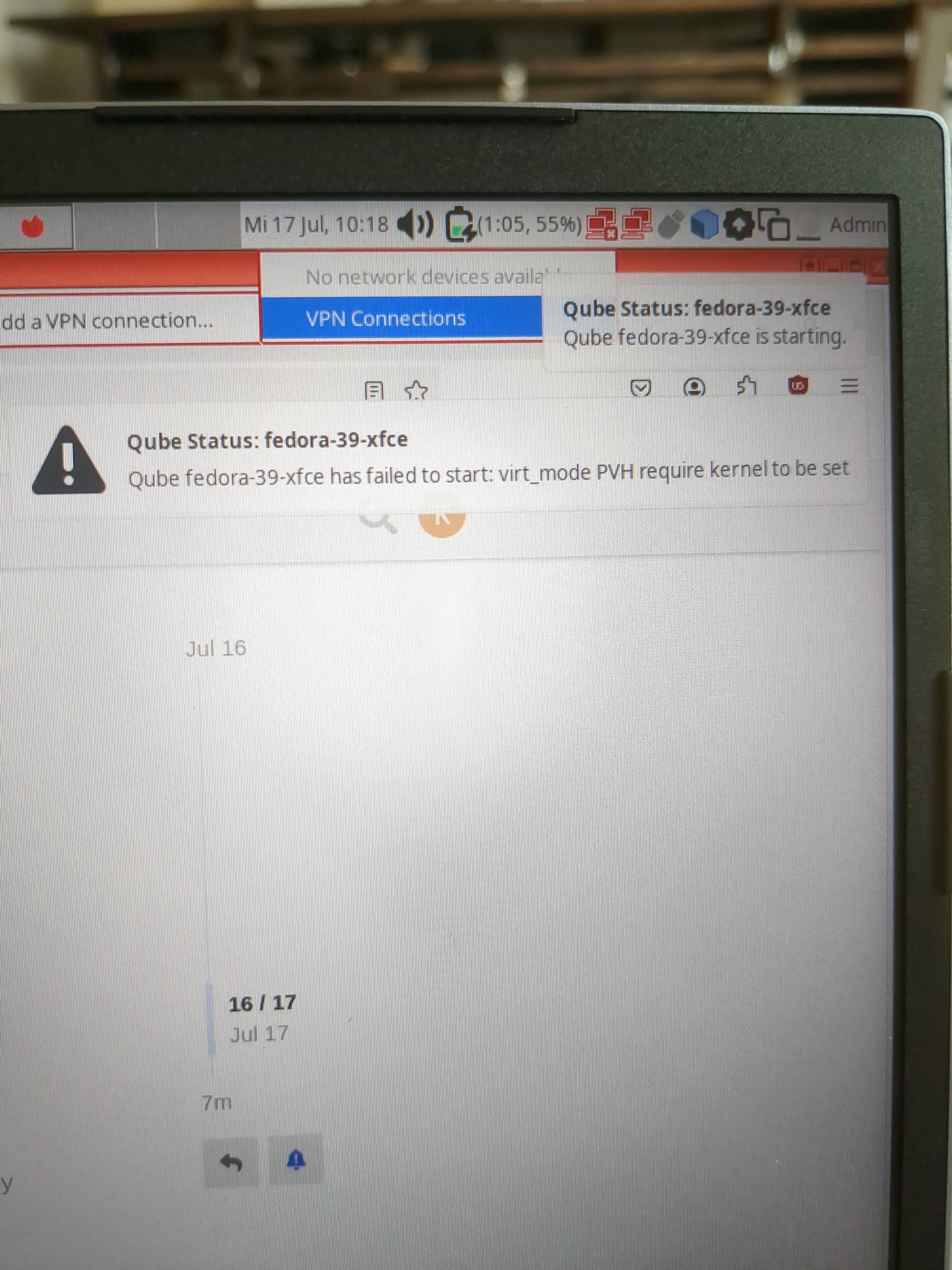

Set the fedora-39-xfe template virtualization mode to HVM.
After installing the driver in fedora-39-xfe template change the virtualization mode back to default (PVH) and kernel to default.

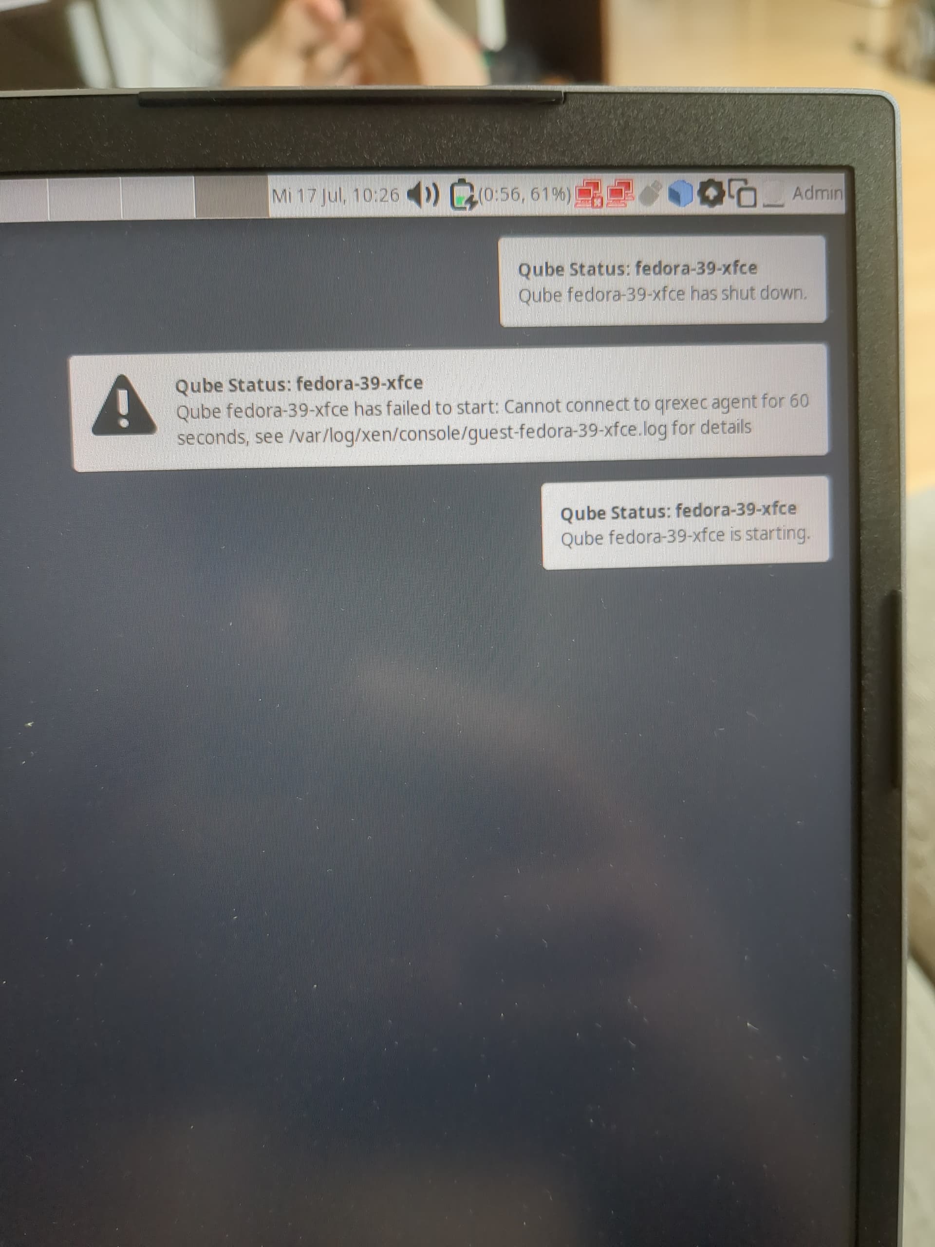

I first switched to kernel provided by qubes then virtualization mode to hvm, when I started fedora-39-xfe this error occured:
