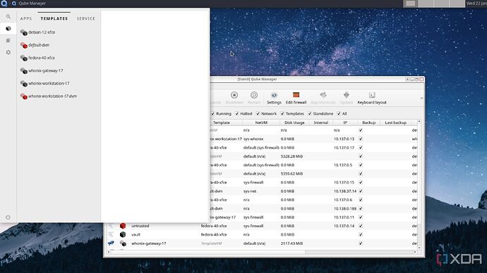

Reverting Back to Qubes OS 4.1 Applications Menu?
Remember the 4.1 banner simple easy and very usable, now we got the 4.2 list which lags a lot and is very unnecessary in my opinion.
Am i the only one who has problems with this list type?

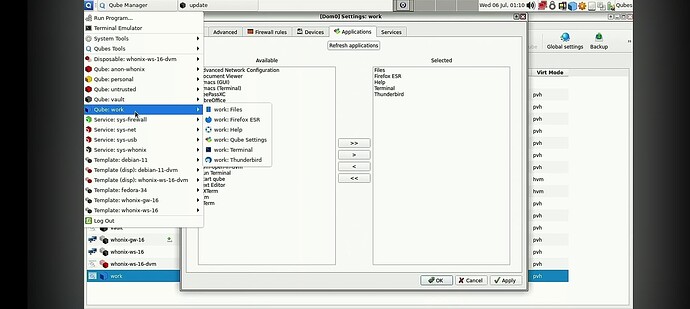

I right-cick on the Desktop and use “the old list” form there (last item in the context menu).
It is available really? What context button?
You have it already. You can customize the XFCE panel, remove the Lancher and Add Applicatios Menu. Or you could have both. Or even 3 (including Whisker Menu). Like this:
This one:
ps. Do not pay attention to the custom icon for qubes. It is not standard. Still under development.
Just right-click on the Desktop. A context menu will pop-up. Last item is “Applications…”
Ok thanks
