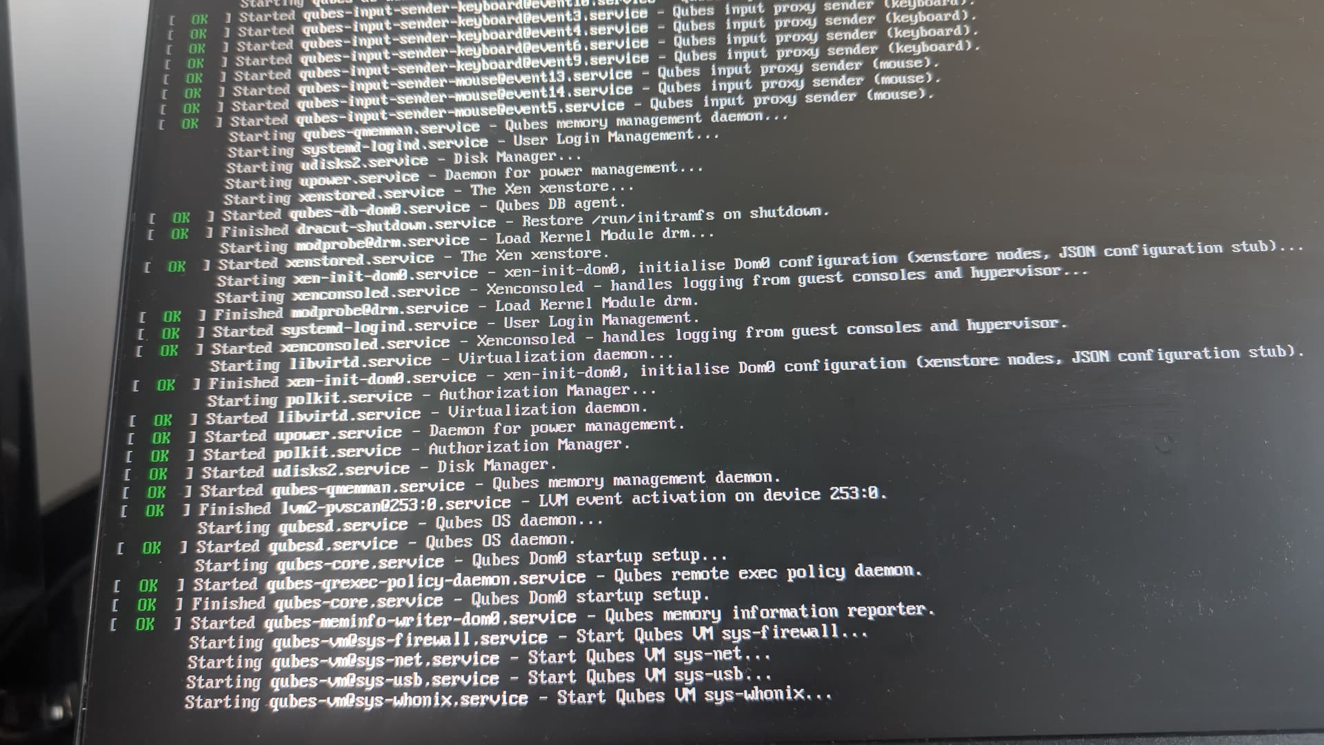

My Qubes OS R4.2.4 system is getting stuck during boot at the following lines:
[ OK ] Started qubes-core-agent.service - Qubes OS daemon.
[ OK ] Finished qubes-core.service - Qubes Dom0 startup setup.
[ OK ] Started qubes-exec-policy.daemon.service - Qubes remote exec policy daemon.
My system configuration includes 64GB of RAM and an ASRock B650M HDV motherboard.
Could anyone provide some insight into why this might be happening and how I can troubleshoot or fix this issue? Any suggestions or similar experiences would be greatly appreciated.
Thank you!

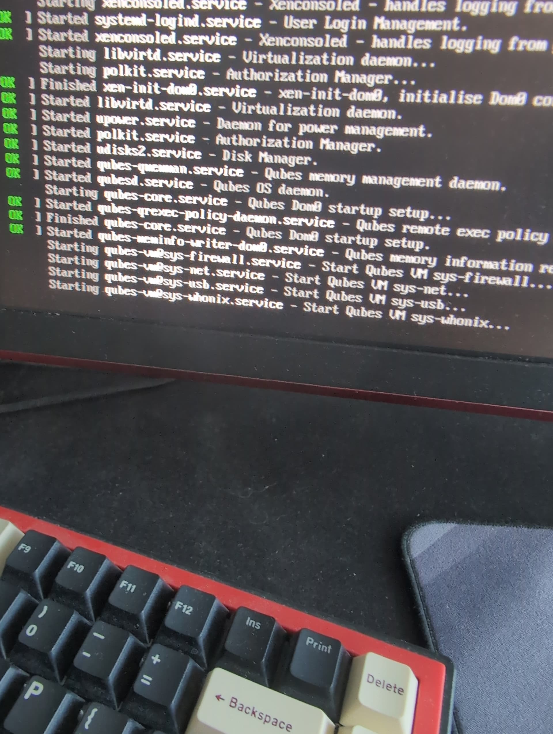

Hello again,
Following up on my previous issue where my system was stuck during boot, I tried adding qubes.skip_autostart to the kernel parameters as suggested in some troubleshooting guides.
While this allowed the system to boot further, I’m now encountering a problem where my sys-usb qube still fails to start automatically upon system boot. This is despite having qubes.skip_autostart in my boot configuration.
Has anyone else experienced this behavior? Is there a specific reason why sys-usb might be ignoring the qubes.skip_autostart parameter, or is there another method I should be using to prevent it from starting automatically?
Any help or suggestions would be greatly appreciated.
Thank you!

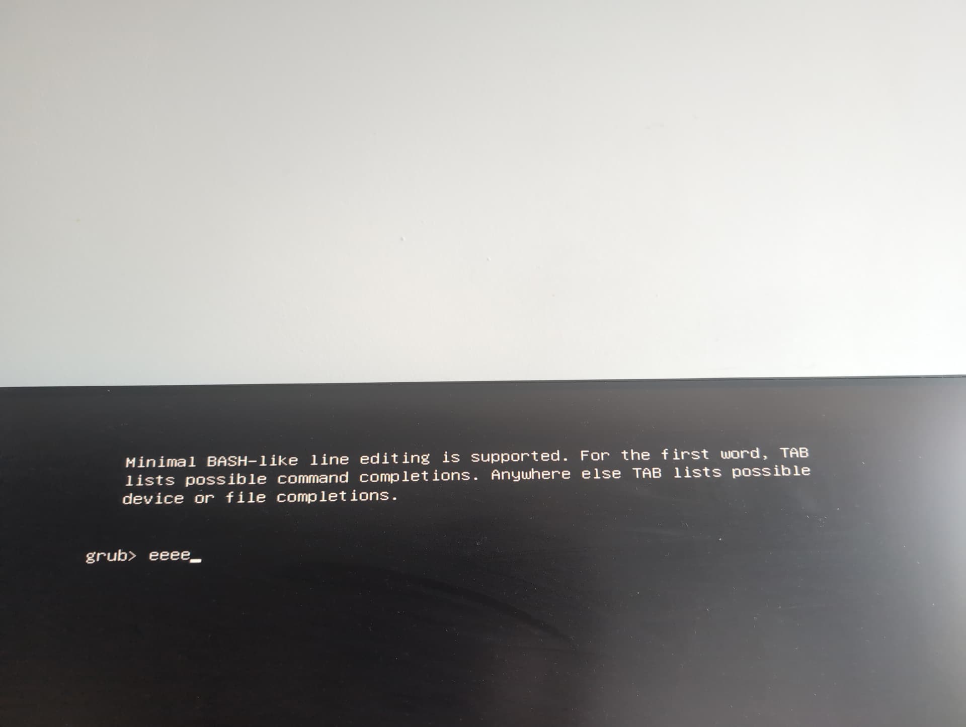

After it restarted, i have new issue

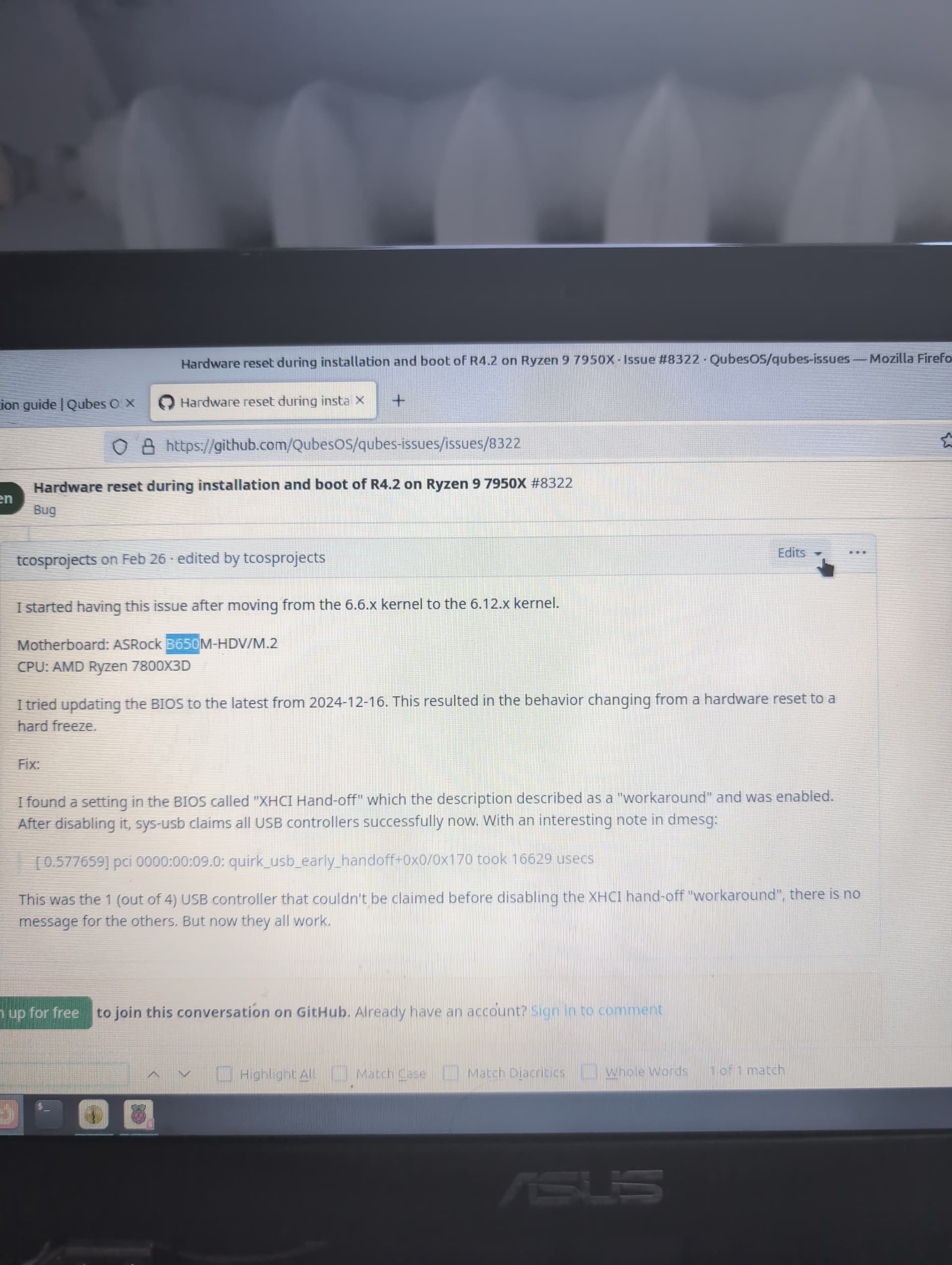

lets swe, sorry for phone pic
Looks good. (The hint on github!)
Here the link: Hardware reset during installation and boot of R4.2 on Ryzen 9 7950X · Issue #8322 · QubesOS/qubes-issues · GitHub
Works fine, xhci is solutions
this shit comeback after one day, when i have all programs on my system :sob::sob::sob:
