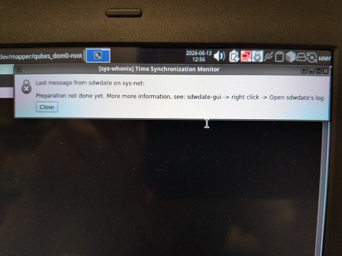

All of the service qubes seem to be running fine. I was able to connect my USB mouse and use it and I could connect to the internet as well as Tor but I had a few issues.
  • There is a noticeable delay when sys-net and sys-whonix starts up. The waiting time ranges from one to a few minutes before I see their icons show up on the taskbar and they start working properly. Sometimes, even when sys-net’s icon shows up, it takes considerably more time to actually connect to the internet (I’m using Ethernet, by the way)
  • I had a consistent error on sys-net that says "Preparation note done yet. More more information, see: sdwdate-gui → right click → Open sdwdate’s log

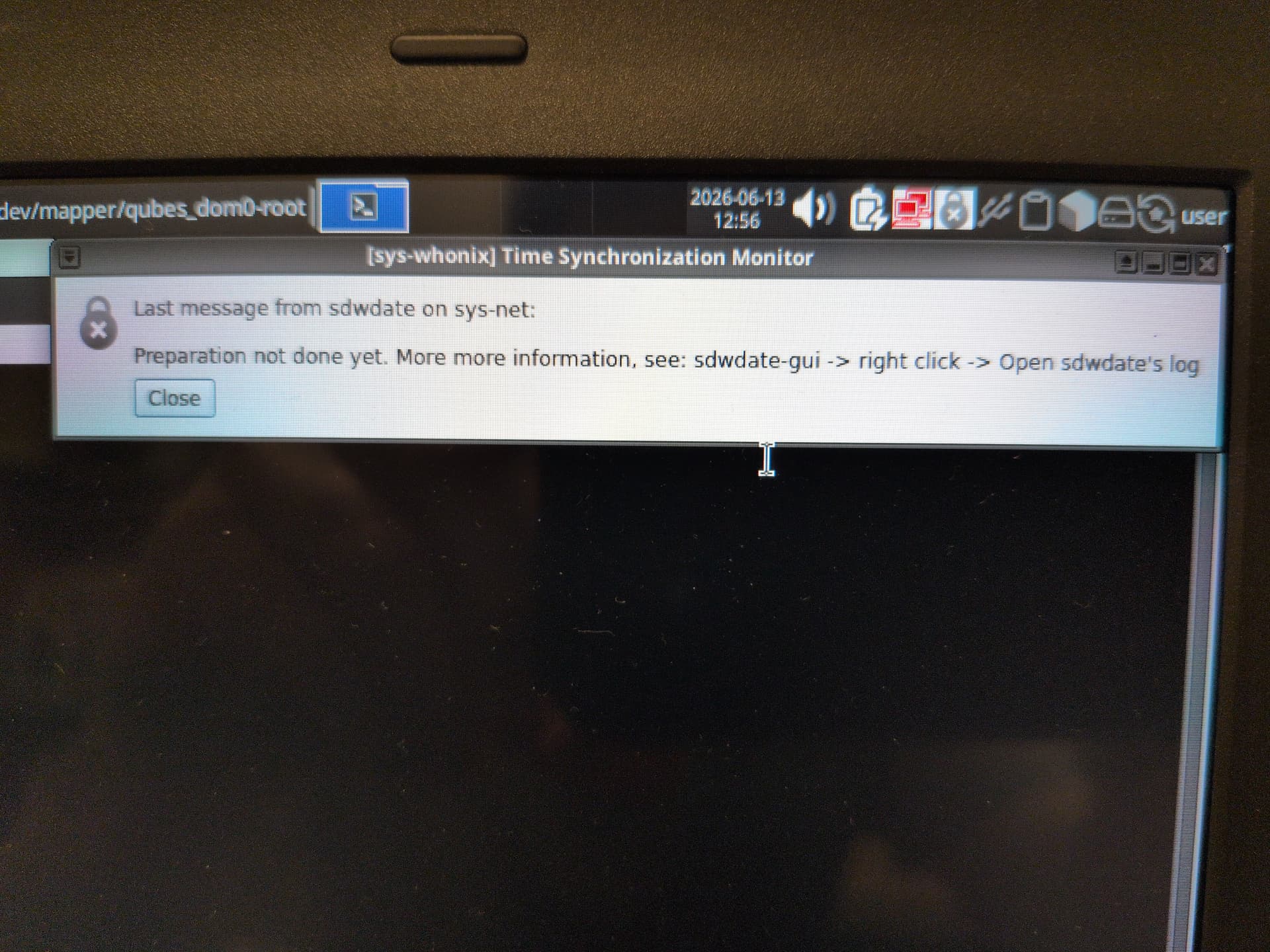

  • Whenever I do try to open sdwdate’s log, it takes a long time for the output terminal to actually show up.
  • When using my mouse, I notice an occasional or frequent lag in my mouse cursor as I move it around.
To address the sdwdate issue, I followed this guide to the letter. Although my error wasn’t a neverending cascade of error messages, only an X icon over the Time synchronization monitor icon, I followed the steps anyway. Sadly, the error described above still occurs.

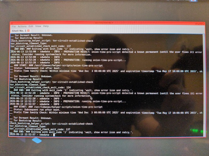

Just in case it helps, I opened sys-net’s sdwdate log and it took several minutes to open. Sadly, for some reason, trying to interact with the terminal in anyway takes forever for the app to register. But I wasn’t able to copy the contents of the output anyway though I can show you a screenshot of it here.

Just create sys-whonix in the varlibqubes pool so that it runs in RAM. This is the simplest option. I use sys-whonix only with ephemeral encryption for root / because nothing is saved in /home - only journal logs need to be wiped. But you can copy sys-whonix to RAM and have maximum privacy without any whonix configuration issues.
