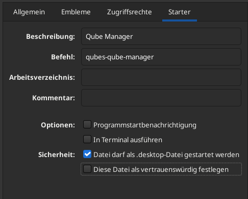

Desktop files are untrusted again? What do you mean? :thinking:
If you have a .desktop file on your Desktop under xfce, in overlay mode it sets the file to untrusted again so that you get a prompt like this when opening.
(sorry for it not being in english)
Yes, this behavior is specific to xfce in overlay in any linux distros :slightly_smiling_face:
