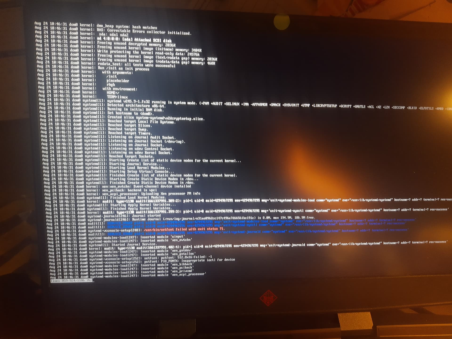

After installing everything and loading this screens is what is get.
Here are related problems.
They say I can make commands in dracut, but how do I get into dracut in the first place?
qube1
2
Here are pictures of the logs
when you type dracut you are in dracut shell
from the log, looks like initramfs can’t find your luks partition.
do you use any custom configuration when installing?
