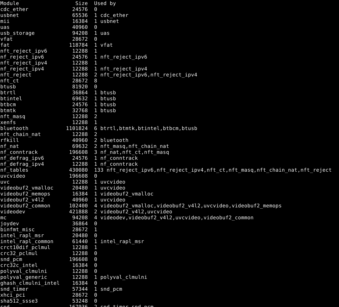

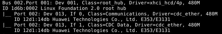

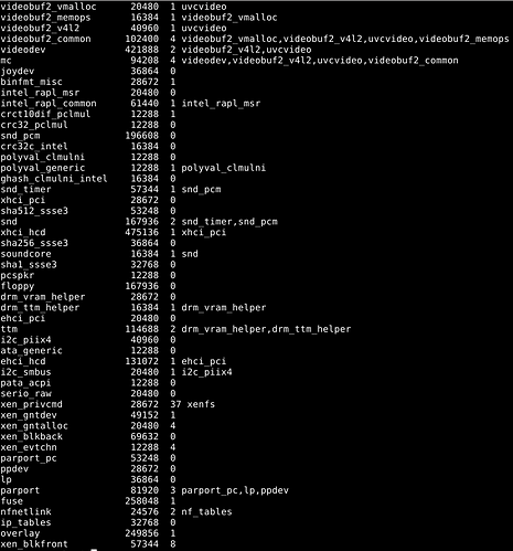

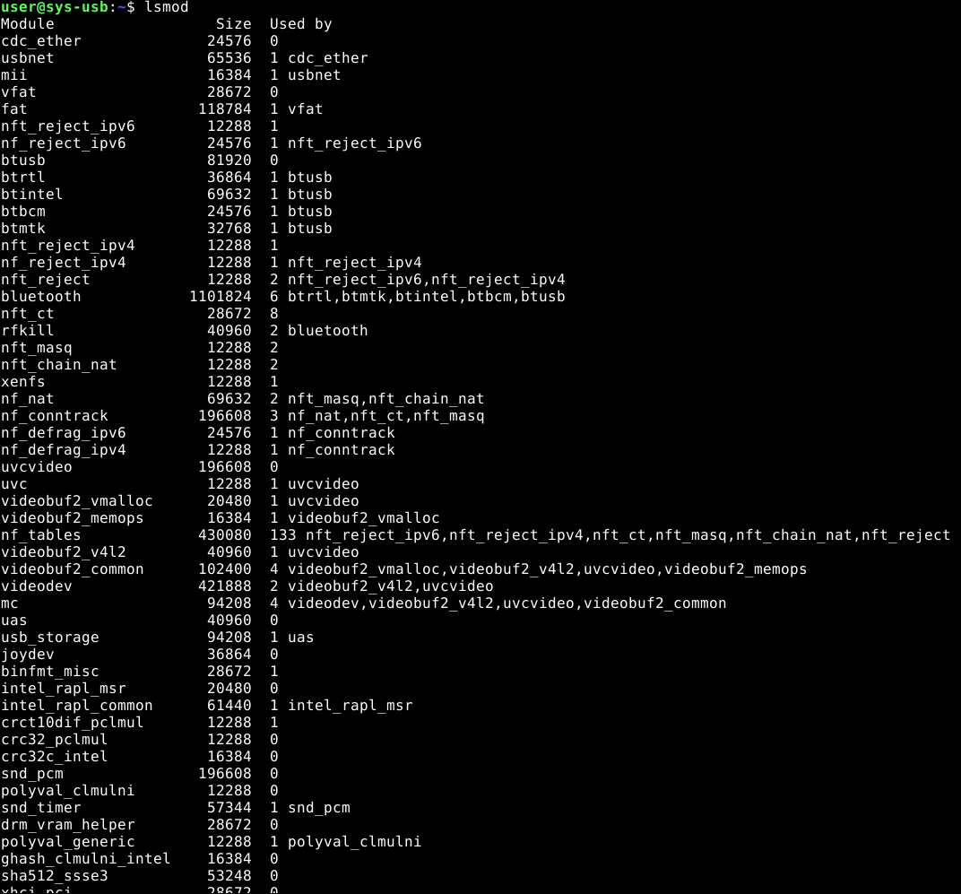

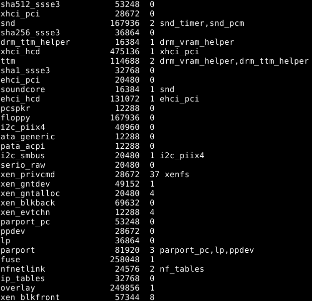

"It returned to the point where I don’t unberstand what’s really going on again. I updated Debian template a day before yesterday and yesterday everything worked (after system reboot too). But last night I suddenly found that stick doesn’t work again. And today all this also continued. All the symptoms returned. I did nothing except updating Debian and installing secure-delete package on it. While stick was not working I checked lsusb -tv again. Also was suggested the command lsmod so I tried this too. Here’s the outputs:
lsusb
As you can see, the driver changed to cdc_ether. So at first I thought this was its fault.
lsmod (Sorry for showing the full output. I’m not sure what info is useful for you there so posted all)
So today I restored Debian from the backup, changed system qubes’ template to the restored Debian. First nothing changed. I rebooted OS and stick started working again. Nevertheless I think the restoring helped more than reboot, because I rebooted OS one or two times before restoring and this didn’t help.
But the biggest surprise was waiting for me when I checked lsusb -tv and lsmod commands again:
lsusb -tv
lsmod
It turns out that cdc_ether is still present and the stick is still working. So it’s probably not the cause of the stick’s issue.
