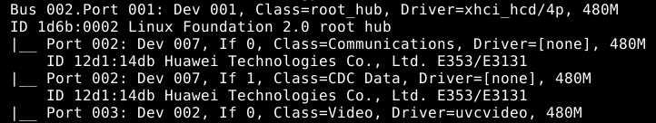

When you plug the device in sys-usb, please do the following:
In dom0:
qvm-usb list
In sys-usb:
lsusbb -tv
Dom0 recognizes the stick as Network: Huawei Technologies Co., Ltd. E353/E3131

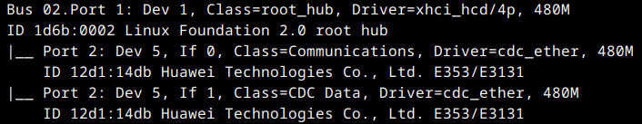

But the main reason why I’m here is to show the screenshot below. As soon as the stick started working again I made another lsusb -tv output screenshot to see if there will be any difference with the screenshot of the non-working state of the stick. And there were indeed differences. Take a look at the screenshot. It was made during the stick’s working state, before any updates in the system. Hope this can help somehow”.
