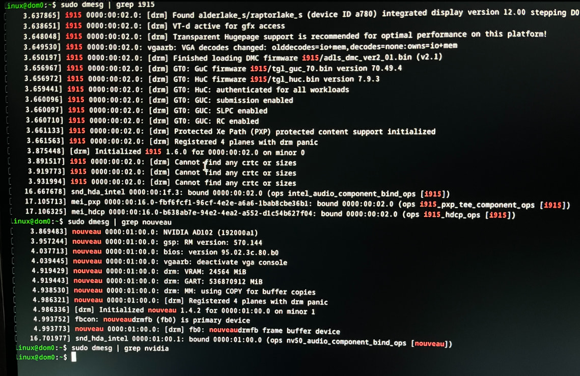

Please provide “dmesg” result.

I tried part of your solution
In your GRUB_CMDLINE_LINUX, add “rd.driver.blacklist=nouveau nouveau.modeset=0 rdblacklist=nouveau”
@dom0:~$ cat /etc/X11/xorg.conf.d/20-intel.conf
Section “Device”
Identifier “Intel Graphics”
Driver “modesetting”
BusID “PCI:0:2:0”
EndSection
As for the things you mentioned about deleting, after all, they are all internal things in the system. I am a little hesitant to delete them because I am considering whether they will affect the entire system or upgrade in the future.
bios is (Primary Display changed to CPU Graphics, iGPU Multi-Monitor set to on)
The monitor cable is plugged into the motherboard socket, but it basically fails. There is no signal after entering grub or there is no signal after entering the hard disk password. I don’t know what the problem is.
