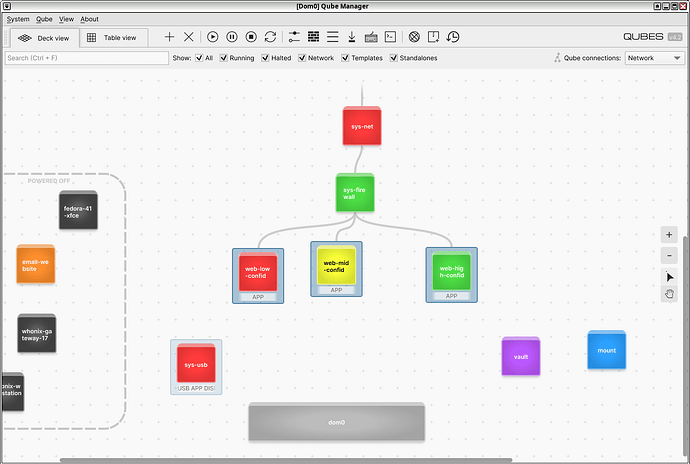

I had the idea of redesigning the Qube Manager a while ago and just finished a mockup of the core change that my vision entails:
Please do enlarge the above mockup to view all details. The three “web-xxx” qubes are selected and sys-usb is being hovered on. A qube’s features are represented by a tag list on the bottom on being hovered on or selected (e..g., “APP” for app qube, “DISP” for disposable, “USB” for sys-usb). It says “Qubes” in the upper right-hand corner because Qubes OS is actually a trademark and I wasn’t sure whether I am allowed to use it in this way.
The core change is what I call “Deck view”. It’s the currently selected tab in the mockup and its features would be:
  1. Visual representation of relationships between qubes (see “Qube connections” dropdown in the upper right-hand corner). Not just the network – could also be, for example, policy permissions. Which qube is allowed to do what to another qube? This could be extended to be an editor as well. A real “under-the-hood” view.
  2. Drag and drop functionality. Launch or stop qubes simply by dragging them from the main area into the stopped area and the other way around.
  3. Free zooming in and out and moving around. Get an overview of your machine in seconds.
In addition to that, the familiar table view, as it is currently implemented in the Qube Manager, would always just be a click away.
What do you people think? Feedback is highly appreciated.

Relational graphs would be a very natural addition to Qube Manager. It’s hard to not appreciate the graphs you see on the QubesOS website, in Qubes documentation, or in Qubes developer blogs, and then think “I want my system to be graphed like that!”. That’s what goes on in my head anyway, and I can’t be alone in that. So yeah, I’m supportive of the core idea. For inspiration we can look to ex. one of the several GUIs for pipewire, like pw-viz . Probably it would be better rolled into a much more general overhaul of Qubes Manager. Not sure what current plans are for QM, but the devs must have lots of ideas for changes already.
As to your specific example, I dislike that powered-off qubes are separated out spacially, because you’re giving the spacial information mixed semantics. To my mind the graph should only be describing network connectivity (or even relationships generally, but power state is not a relationship). Power state would be better expressed by changing the appearance of the icon, and of course you could also have the option to hide powered-off qubes if you wish.
Another thing I’d like integrated is qube groups:
  • The graph would show an obvious visual indication of qubes that are grouped together.
  • You’d have the ability to manipulate their properties as a single unit.
  • They’d share a tag that can be used in policies.
  • Qube groups could also be grouped or nested in the Start/App menu.
Does this solve a problem people are having? I ask this ingenuously. After all, I’ve perused this forum for quite some time and I’ve yet to come across any real gripes from users in regard to the Qube Manager layout. In fact, I’d say it’s rather intuitive and easy to control.
But also, you must consider the devs. Right now they’re struggling enough to find a way to get Fedora 42 to work with Q4.3’s sys-gui. Much less should we add to their work load completely revamping how we interact with, arguably, one of the least-used features of Qubes. (And by that I mean, once you configure it a certain way, you largely forget about it until you need to tweak something. At least, that has been my experience.)
This does not prevent people to contribute to ideas, or even implement them later themselves :slight_smile:
I think the deck view should offer multiple layers, because there is more than the netvm relationship:
  • relations between templates, appvm and disposables (named or not)
  • audiovm relationship
  • gui relationship
I’d be happy to have such a view because sometimes I struggle to have the big picture of my setup.
I see it more as a nice-to-have. When you’re designing or maintaining a network, it helps to be able to visualize it. Perhaps it’s hard to grasp the usefulness of it if your system only has sys-firewall and sys-net. Try to imagine a system with a tree-like structure of 10 or more netvms.

I don’t think anyone’s suggested the devs should reprioritize. Brainstorming ideas like this, even if they can’t be seriously considered in the next 5 years, is pretty harmless imo.

There should be a mode for viewing template-appvm-dispvm connections.
I’m too lazy to drag, can’t we just right click or something? Ability to drag doesn’t affect the behavior (i.e. what would be the network qube, template qube, etc., there is nowhere to drag to). Even then, IMO dragging is unwieldy. I agree with likafox’s take on that:

On that note, why bother with “deck view” at all? Something similar to a file manager tree view might be easier to work with as well as implement (and will take less space on screen).

p.p.s @Ferdinand_Heinrich Here’s an idea: in the network mode, don’t just display qubes, but also network devices, and allow controlling which qube handles which interface by “drawing” (maybe stretching is a better word) connections
I would want to see the ability of dragging devices such as usb and microphones (aka PipeWire e.g. qpwgraph) to the desired destinations. Perhaps creating a large temporary volume for transferring data to another, and then moving that volume and mounting it in a DVM for processing or inspection. Like when upgrading a template and you need temporary space to do the upgrade, just create a volume and drag it to the template to mount it, do the upgrade and then move it to the trash. Click on any VM and look at the space available, or have the VM’s color coded for % space remaining.

Now I do see the potential of a unified interface for what are essentially three interfaces at the moment (application menu, Qube manager, tray icon menu) and that is, in addition, making heavy use of spatial design.
I think it is worth my effort to test whether this concept actually provides additional value compared to what there currently is. I am going to write a high-fidelity prototype of the interactive graph view (i.e., what I call deck view). It will be a KDE app (Plasma Desktop 6, more specifically) because I would like to provide easy access to theming and I prefer Qt 6.
On a side note and as to the question what problem I am trying to solve, I would like to mention that I see my PC and its OS as a digital, mobile home for myself. Therefore, I want to push on three very specific parameters that I think define the feeling of being at home:

Hi, the dev who does the UX stuff here :slight_smile:
I like the idea a lot and it really aligns with something I would love to see in Qubes one day. The problem I’ve seen when trying to test it out on a live system is that it’s very hard to make it readable/practical when someone has a lot of qubes (I’m at ~20 app qubes, and I don’t think it’s that much, the guy next to me has over a 100…), and even if you don’t have that many app qubes, even a couple of templates, whonix stuff and default system qubes is already a lot. It might get very hard to find the qube you want quite fast.
But the idea of showing a tree view, using drag-and-drop for some permissions/attachments is a great one (I’d love also to see devices integrated there, too, because they seem like a very natural fit - connected to the backend qube and dragged-and-dropped onto the frontend).
My own vision for Qubes Manager and the whole system management toolset is that right now it sucks AND is problematic to move forward to Wayland (because tray icons are apparently the devil?), so my soon-to-be-happening project is “rethink and redesign the way the user is managing the system in day-to-day operations in order to move away from the billion widgets”. I think it’s pretty clear that the idea to split system management from qubes manager to widgets was a failure (the widgets are bad to use with keyboard, not very discoverable, and while I tried to improve some things about it, I think it was just bandaging a dead horse), and we need to rethink the whole approach to it. One of my ideas is a re-designed Qubes Manager (keeping the current table view, but also having a dashboard-like view for current system state), but I still need to do more research and more thinking on it…
edit: soon to be happening means like “the moment I’m done with last 4.3 fixes”, so hopefully weeks

I’ve not been able to see the Mockup, but from the discussion I’ve a
pretty good idea what is included.
I like the idea too - so much that we used to include something like
this for users. But in the end, it did not suit anyone, inn that it did
not solve any problems. (Of course, it might solve problems for OP,
and for some other people.)
@marmarta is right - as soon as you start to run diverse
templates/qubes this sort of representation becomes unwieldy. For
example, we regularly ship in excess of 30 templates, and in excess of
80 AppVM - that doesnt include disposables or standalones. We didnt find
a sensible way of easily incorporating this in to a GUI scheme.
Things you might like to consider:
  1. Template store - dragging from template to qube area creates new qube
    based on template. (This requires separating “running” target space from
    qube target space). Dragging an existing qube on to a template, changes
    the template used by that qube.
  2. Disposable template store - dragging a qube in to this store promotes it
    to Disposable template, and automagically generates entry in disposable
    store. Dragging from removes that property.
  3. Disposable store - dragging qube from here spawns disposable
  4. Standalone store - dragging to here creates a standalone. Dragging
    from here, starts standalone.
    You need to be able to select multiple items at the same time to change
    networking properties.
    Right click on network connection open qvm-firewall properties for
    editing.
    Right click on icon opens Qube settings for editing.
    It’s important to separate “running” space from “stores” - dragging
    from the running space should shut down the qube.But dragging to/from
    stores should change klass or properties.
There’s probably more, but I cant remember just now.
As I said, it didnt work for us. It may work for you.
The major objection that I had to this approach, (and I’ve said this
numerous times), is that it puts the focus on the implementation, but
for most users, they dont care about this. What they want to do is get
on with work, without bothering about templates, AppVMs, disposables.
The way to do this is to use Menus that put the focus on what a user
wants to do, rather than how they do that in Qubes. Helper scripts that
generate whole security domains and create grouped Menu items with an
emphasis on applications rather than qubes. Shortcuts that do all this
stuff in the background.
I’ve been banging this drum for a long time, and it doesnt seem to
appeal to many users in the Forum, (or in the mailing list before), but
I’m sure that it’s the way to get Qubes out of niche.
Incidentally there was a suggestion before that Qube Manager was
reinstated because of some “bounty” - this was just wrong. Qubes
development is not based on bounties - you cant pay to have some
feature that you want included in Qubes. (You can pay to have a
custom Qubes provided for you or your organisation but that’s
different.)
The Qube Manager was reinstated because user feedback to its removal
was overwhelmingly negative.

I’m just using Qubes since a year ago, and it think it simplifies understanding the system. Some things I already understand, some things not yet. Looks good, especially for new users.
Hahaha, that one was funny and weird,. I wanted to say “mutiny”. And if anyone asks theirsleves what on Earth these two have in common at all, well for a non-native English speaker it does… Apologize.
@unman puts a finger on it for me…
TLDR: The UI problem (for me) is that it doesn’t seem to map to my set of use-cases for the whole system.
the Too Long bit is here
The big list of AppVM, DispVm, maybe with templates and service VMs separated out is something I mostly try to hide from. Sometimes it is useful, but most of the time I want to be working in a limited “domain of activity” (e.g.general business admin, a specific client, project, in a personal or work library, general browsing, personal communication, archiving, etc). These domains very much do NOT map to single or multiple VMs, and often span multiple security contexts.
Most of the time, I want almost everything else just to disappear, until I switch “domain of activity” or need to add something to the current one.
I both agree and disagree with @marmarta here…
The Widgets are great and indispensable for having an always-on view of overall system state and for quick access to some global config and actions, but they cannot be the sole view of config and management. Old-style manager is sometimes the best tool, but lacks some functions, and the same for the new main menu… but all of them are very “global” - they show everything, which is often too much.
Most of the time, I’m actually a user of a restricted subset of AppVMs/dispVM/Templates/windows… and sometimes I really don’t want all that Dom0 power anywhere nearby. I need a whole range of different “splits”, but mostly they are not splits between simple classes of “implementation-y stuff”.
My current approach is a mix of workspaces, prefixes on VM names, labels… and self-discipline. Have considered/considering splitting my use cases with AdminVMs, separate virtual consoles, tags&RPC, and assorted other tricks… but mostly not brave enough.
I’ll shut up now, as it’s starting to sound like a job of trying to “tesseract the hypersphere”, and I seem to be repeating myself.
Your idea sounds neat. Here is related info on a previous attempt, but your idea looks better then this one:
Which ultimately comes from this:
One issue that happens with mermaid is that once your system has a lot of qubes (for example, qvm-ls | wc shows 170 qubes on my system), the automatic layout algorithm will sometimes try to put like 100 of them on one line next to each other, (going far “off the page”). (note: trying qvm-ls-mermaid now just gives me a “Maximum text size in diagram exceeded”, so I cannot confirm these things as I am saying them)
My point is:
  • Looking at this for ideas for kinds of relationships you may want to present may be a good thing
  • That the algorithm for laying out the nodes in a automatic way will probably become a focus point. You may want to see if someone already has a good automatic layout algorithm that’s part of a library that’s small enough for people to feel comfortable adding it to dom0
I notice he has a “Qube connections: Network” box in the upper right corner. I’m assuming the thinking is about only displaying one relationship at a time, where the user could change “Network” to “Template”, or “Policy Group” or whatever?
However, “power state” should be determinable from each graph, since when someone wants to know something about a VM, more then 80% of the time the VM will probably be currently running, making it a easy way to visually find the VM you want and not the many, many non-running VMs. It could be something as simple as greying it out.
Also note he was displaying the security label colors (which is probably a good idea)
My guess is that a KDE app would probably not get accepted for dom0 as it would pull in tons of kde libraries, however you can read the “visualize qube config without trust” on how to use the Qubes Admin API to run qubes-manager not in Dom0. (I.E. by putting your new qubes-manager in a qube and running it from there with enhanced, but restricted permissions)
And finally a rabbit hole to go down about information about expressing information beyond security label color: :slight_smile:
(tip: don’t try to handle every use case. at some point you have to give up reading about new use cases and actually do something, but it can be good to know what the issues that may come down the line are)
Re: “the focus on the implementation” cc: @unman @phceac
The Qube Manager being implementation-focused is not a problem. Until proven otherwise, I don’t believe it’s possible to get away with not caring about implementation. Security in Qubes doesn’t happen by accident; beyond the most trivial of use you need some understanding of the underlying design to make effective use of Qubes. It’s like a password policy-- The policy can help guide a user in the right direction, but at some point you are relying on the user’s understanding of what a password is even for, lest they set it to ASDF;lkj1234 anyway. Likewise with setting up networking for their qubes etc… If you discourage users from thinking about implementation details by hiding all of it, while still expecting them to make decisions, you will have Windows-like pop-ups saying “this program is trying to access the internet. allow access?”, that the users will always click “yes” on because it’s just easier/lets them get on with their work faster.
Now for the part where I agree with you. There will always be a place for an implementation-focused interface like QM, but we need a use-focused interface too. Sometimes we are setting up/maintaining our qubes, and sometimes we are USING them. We need BOTH. That is where the start/app menu is supposed to come in, however I share all your concerns about it not being the use-focused interface we need. The main view area being an alphabetical list of all your qubes is just not it. We need something purpose-oriented, that shows more of what we want and less of what we don’t, and that takes into account relationships much like what @phceac describes as “domain of activity”:
I can relate. For example, I’m currently working on an embedded computing project, codenamed “bruno”, that I’ve made the following qubes for:
  • bruno-research mainly runs firefox for looking up documentation etc. and a notepad for taking notes.
  • bruno-dev has a dev environment for developing and compiling the embedded device’s board software package.
  • bruno-cache is bruno-dev’s netvm, which handles http proxying and perma-caching code repositories for reproducible builds.
  • bruno-test has a usb controller and serial console for doing live tests
I really wish there was a better organization method than giving all qubes the same prefix, which doesn’t do anything to slow the proliferation of start-menu submenus. I mentioned qube groups earlier, and groups would go a long way to making the start menu more comfortable than what we have now. It’d be nice if from the menu I could open a mini-manager window of the bruno group, where all the bruno app launchers are on-screen at once. I can launch 5 apps in one go, and then keep the window open while I work in case I need to restart anything. No fumbling around in the start menu over and over.
But I wonder if even groups is a half-baked idea, and we could do better. Would need to think on it more (and give it its own forum thread and keep this one to QM discussion).
btw I heard KDE is planned to be the default desktop in future versions of Qubes.
