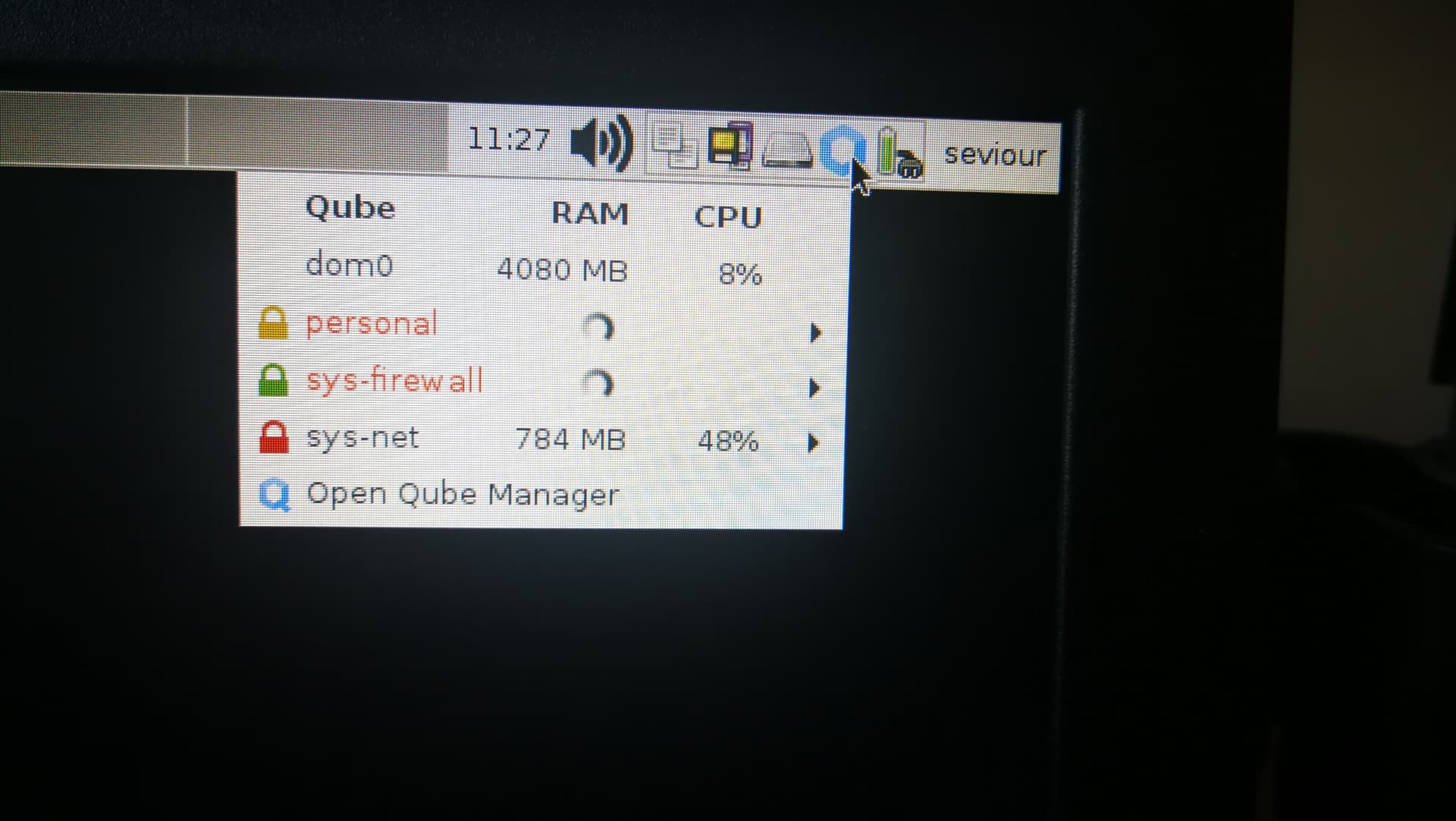

When I’m opening any qube or VMs then status in Qubes Domains is highlighted with red fonts and starting the process and after while the procedure is halted and pop up message saying that my domain has failed to start: qrexec-deamon startup failed: connection to the VM failed

I run the command and gave me logs but it make no any sense to me. Should I do screen shot for you to see it?
Try running journalctl -f continuously and simultaneously try to start a VM. Post here the new lines which appear in the log during that.
Not sure if you can read it clearly?
This is unfortunately above my level of knowledge. Perhaps @unman could help. In order to help other people, you could copy it as text: How to copy from dom0 | Qubes OS.
