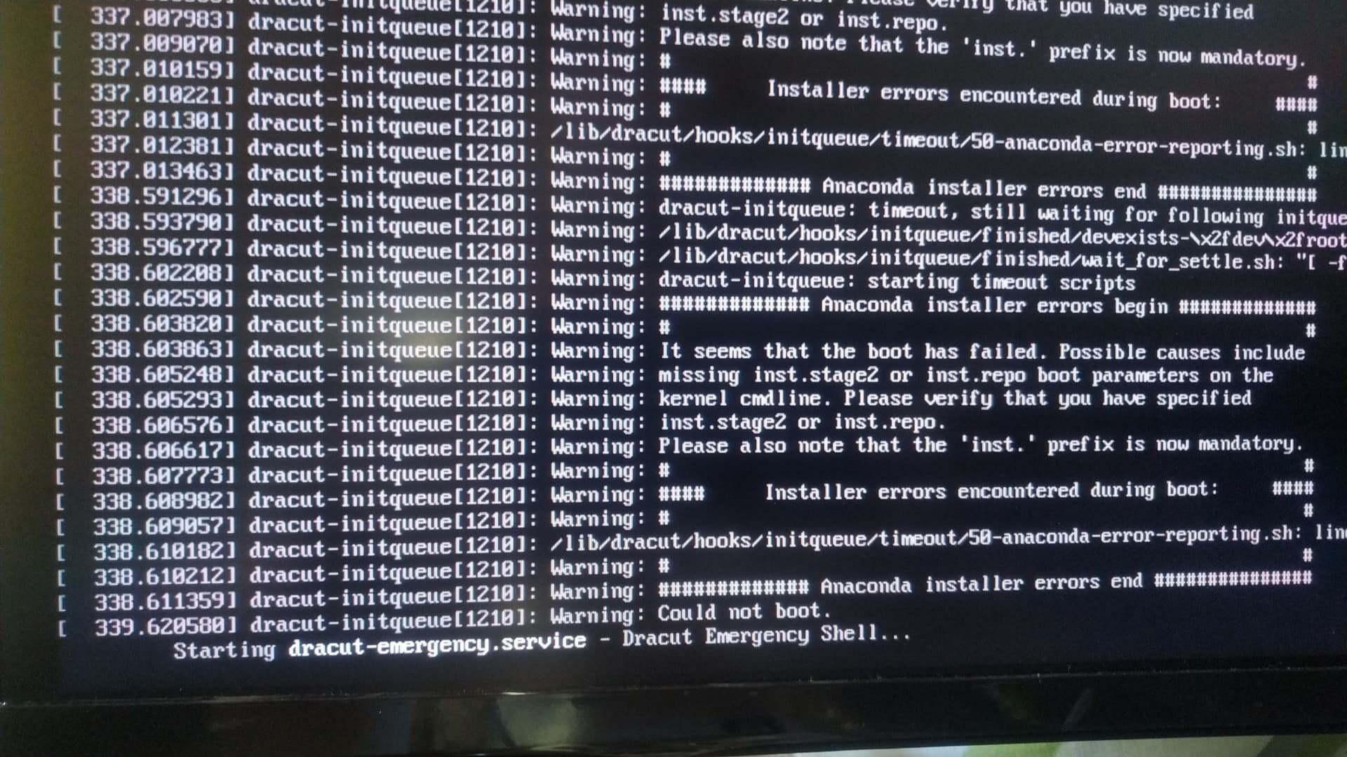

Hi everybody, trying to install QOS 4.2.1 I noticed the problems errors I get are similar to others with AMD Ryzen 7 and NVIDIA GTX1650…

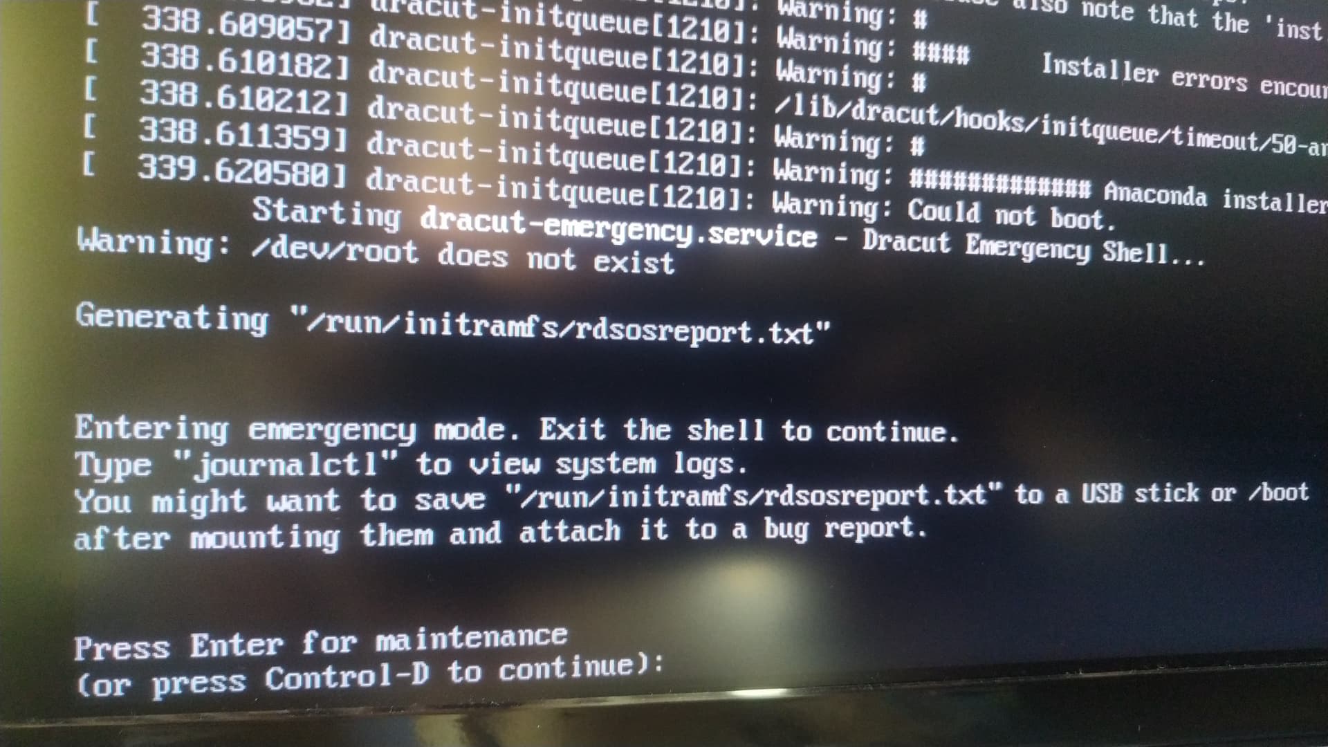

What is missing in my system to reach Anaconda Installer? It stops before I could see Anaconda

Can you describe the errors that you see or make a photo?
yes thanks, in few minutes

Can you copy the rdsosreport.txt that is generated after the installer fails to boot and check it to find the exact errors that cause the boot to fail or upload it here?
Press Enter on this screen and you can copy the file to some of your disks.
Where should be saved that txt file ?

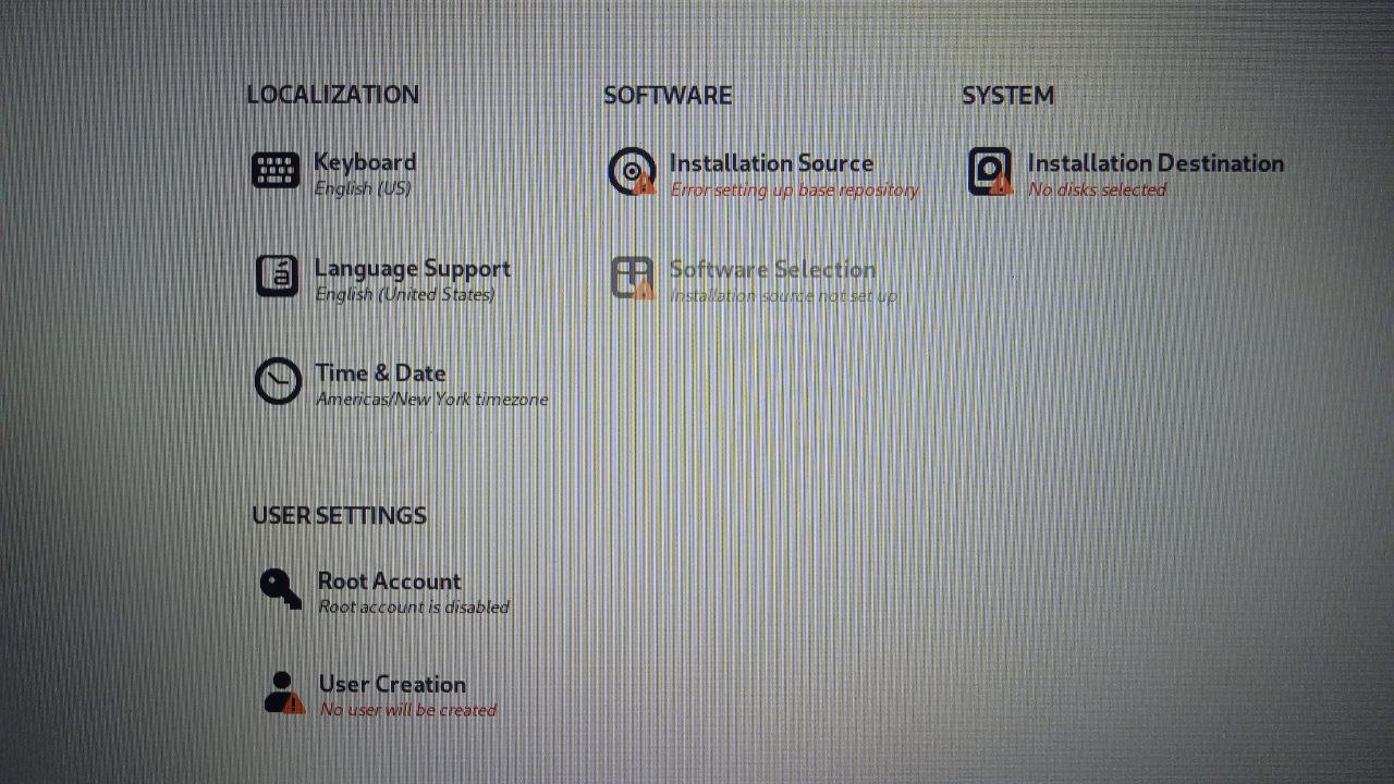

Now boot with last changes screen remains totally dark and don’t show any text
What did you change from the time when installation failed with a log messages?
Screen remains dark after selecting any installer GRUB menu entry?
I reenable NVMe … Now i made a new burn from Rufus, checked che SHA256 and match, booting with choice “last kernel”, then appear for half a second few lines on screen and then fully dark and game is over.

Remove the quiet kernel command line option in the installer GRUB menu entry e.g. like this:
Maybe you’ll be able to see the logs.
