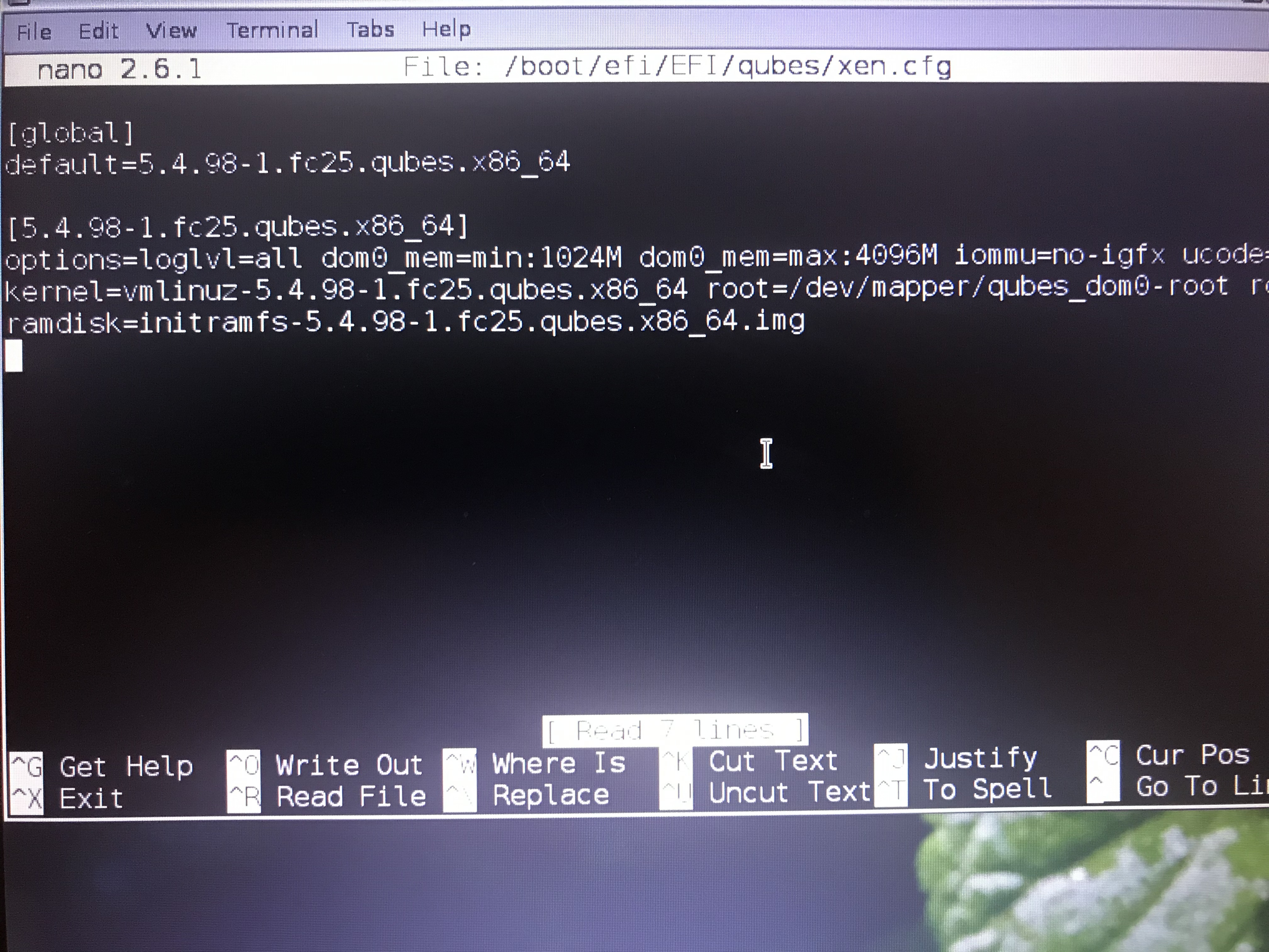

When I attempt to change the Kernel I am only seeing one boot entry option listed ( the current default kernel) and no other kernels to choose from. Is there a way to see all available kernels?

I have a interesting new development, I switched the default kernel and can can now open VMs that do not use networking or if I switch the networking off I can now launch the VM.
