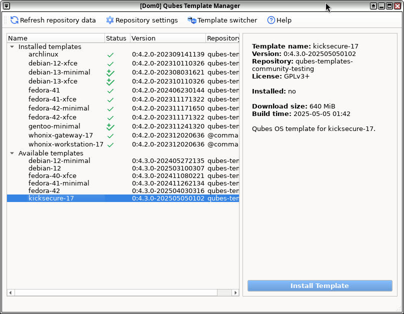

Official Kicksecure for Qubes Template:
Would it be possible to trigger a template build for r4.3 as well? For testing users who are on R4.3 alpha.
Created a ticket for it:
Thank you very much for following this. It appears that it got built and uploaded few hours after my post. It is now available to r4.3 users:
