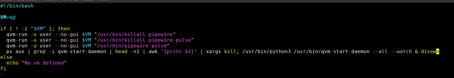

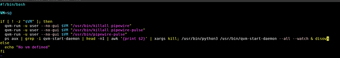

I have a script in dom0 that tries to restart things:
Unfortunately it also does not solve all the problems. Especially the microphone causes issues still.
