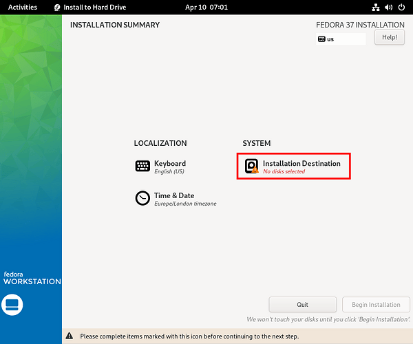

RAID-0 looks like it’s easy to set up for the semi-automatic Btrfs installation layout:
The GUI-based RAID creation utility available in the Fedora installer is not present in the Qubes OS installer. Additionally, when I attempt to create RAID drives using the virtual console and then load them in the GUI, the Anaconda installer crashes, causing the system to reboot. Therefore, the setup described in the linked guide does not work for Qubes OS.
Using RAID0 on Qubes is quite simple using BTRFS. Select the two drives when installing Qubes, select “Custom”, and follow the instructions.
I setup RAID0 on my system with two NVMe drives with no issue. Hoped for noticeable quicker speed, but in normal use it doesn’t feel any faster.
It is present in the R4.2.4 installer. Make sure you don’t forget the first step:
For RAID-0, the total capacity will be (number of drives) * (size of the smallest drive) although Btrfs would support using the full capacity, because Anaconda will create small partitions even if “Size policy: As large as possible” is selected. (I haven’t tried the R4.3 installer, maybe it’s fixed there?) The full capacity can still be used by selecting “RAID Level: Single”, which however won’t do striping so performance should be a bit lower than for RAID-0.
