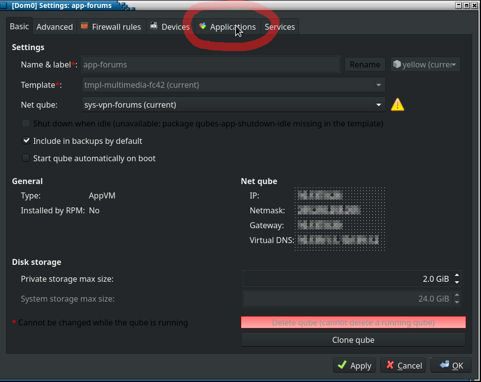

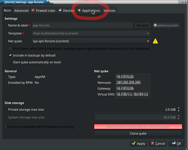

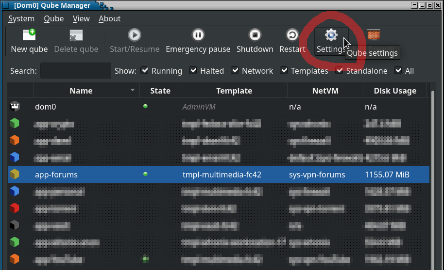

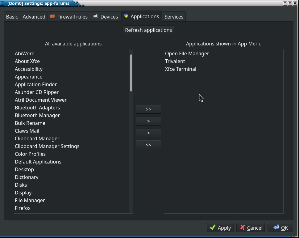

  1. either go to Q menu, cog wheel, Qubes Menu and run Qube Manager or in a system tray click blue qube and run Open Qube Manager
qubemanager-01-02 qubemanager-01
  1. in Qube Manager chose qube from the list and run Settings

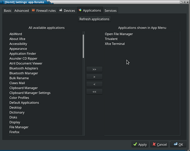

  1. in qube settings go to Applications tab
  1. there you can chose which app will be visible in Q menu
On the left side are all available apps and on the right side are apps that was added to Q menu and are visible.
Those apps are installed and you can run them from terminal or make .desktop files to autostart them, but to chose them from menu you must add them to the right pane.

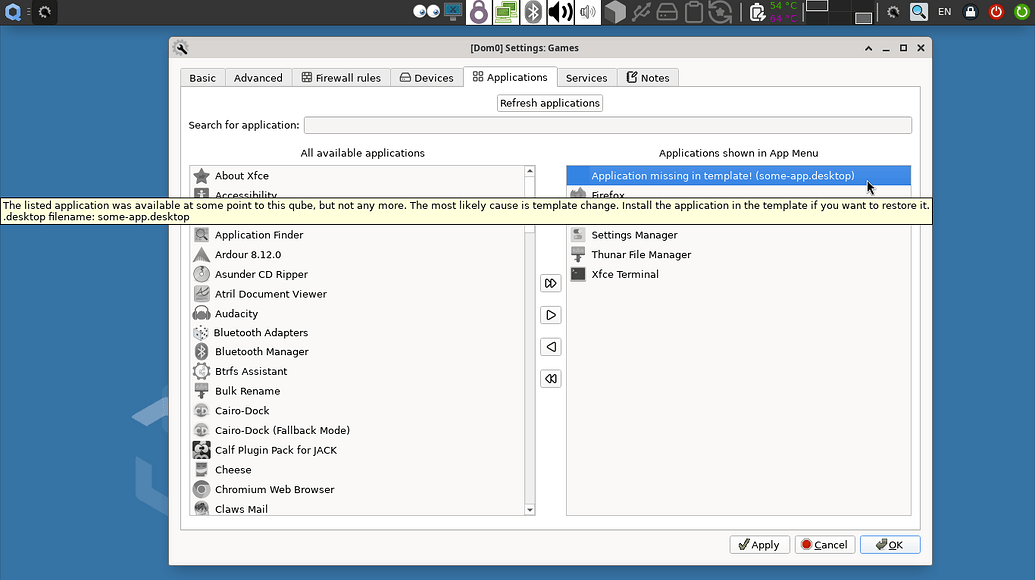

That’s not what I mean. This last step will result in {application missing in template} as shown in the picture.(It is highlighted in blue)
In fact, my Qube symptoms are different from those in the photo, and everything including the terminal is {application missing in template} and does not work at all. By the way, there are not many apps that can be installed on the left.

In that windows of yours there are apps that is installed in template/qube on the left side.
On the right side are apps that was moved to be accessible from menu.
Xfce Terminal is not a system, it’s an app. All those what you see over is installed apps both on the right and on the left. Period.
The one that you highlighted, some-app (strange name) for me looks like you made .desktop file, added it to menu and then deleted it so it’s missing.
This menu don’t scan automatically all available apps.
When you install/uninstall app in template, special python script is executed that on base of .desktop file of that app generates this list. If you delete .desktop file by hand from terminal/thunar then this menu/settings windows know nothing about it.
And if you have app added to menu on the right but you uninstall it from template then it will stay on the right side in settings window as missing.
You need to remove it from the right side.
The picture is just to show an example of {application-missing-in-template}. It’s not mine. A kind user showed me in the thread below. A series of issues with {application-missing-in-template} are written here.

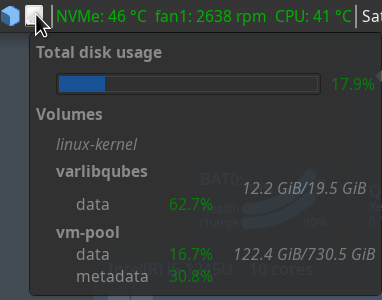

First lets check disk usage in disk widget in system tray
I certainly didn’t write any details about memory. It looks like this in order.
Total disk usage 7.6%
varlibqubes data 27.6% 5.4Gib/19.5Gib
vm-pool
data 7.1% 57.7Gib/815.1Gib
metadata 14.7%
So, you have plenty.
