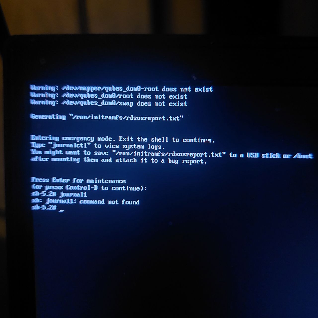

Hello, I'm having a very big problem with my QubesOS 4.3.1 operating system—I can no longer access my files
Hello, I’m having a very big problem with my QubesOS 4.3.1 operating system—I can no longer access my files.
I keep seeing this message.
How can I fix this error?

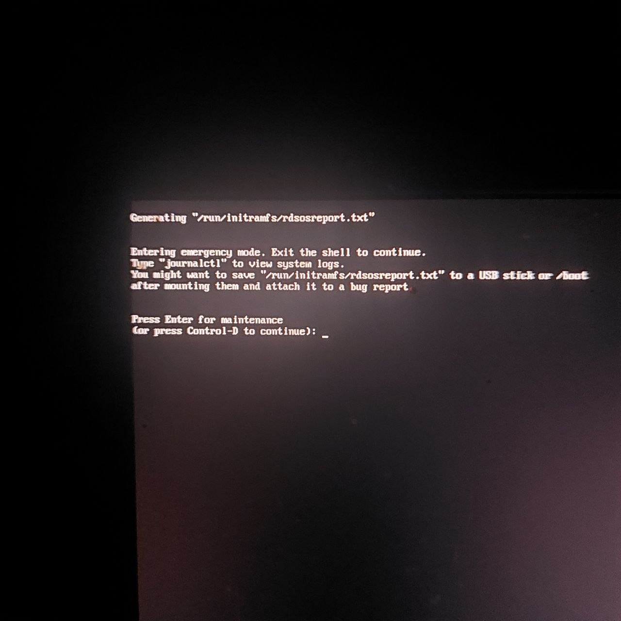

Hi Sabine
What happens, if you type:
journalctl
– followed by pressing the return/enter key?

journalctl

Hi Sabine
From the information shared (the system asked you to type journalctl, you typed journal1 and got sh: journal1: command not found) it is very difficult to give any meaningful suggestions. :frowning:
:slight_smile:
Looks like your lvm pool broke down.
When you are at it with journalctl, check also for the visible partitions via lsblk.
It would also be interesting to see the output of pvs and vgs.
Apart from that, I’ve seen lvm pools breaking down before, but not like this.
Did you “try something out” that might explain that state?
