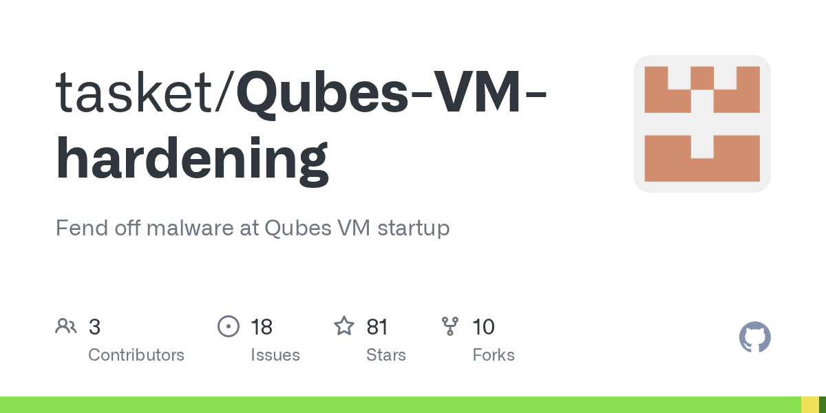

I believe the following work by @tasket includes some mitigations against this, but I think it’s a bit advanced and the above mentioned mitigations should be already a step in the right direction.

- If someone is walking the ten miles two install and use Qubes OS, why isn’t Qubes-VM-hardening - one extra mile - included as an option in Qubes OS?
- Where is the download button in GitHub? Being an non-IT end-user for Qubes OS, GitHub continues to challenge me. How can I download Qubes-VM-hardening?
And is such a third party add-on considered to be safe?

By installing a third party package, there is some due process needed. Chris (aka. Tasket) is a known community contributor, with a long track record of contributions. So you need to figure out for your particular threat model and some other variables you should accept the level of trust or not.
When you download the code from github, you should verify that the code is signed by Chris’ GPG key, but that may itself be a roller coaster on its own.

Look for the green button: (and if needed, after that you can also hit the ?)
There’s an open issue for it:
Doesn’t look like it’s in the contrib repo, but if it were, you could install it (potentially) more easily:
