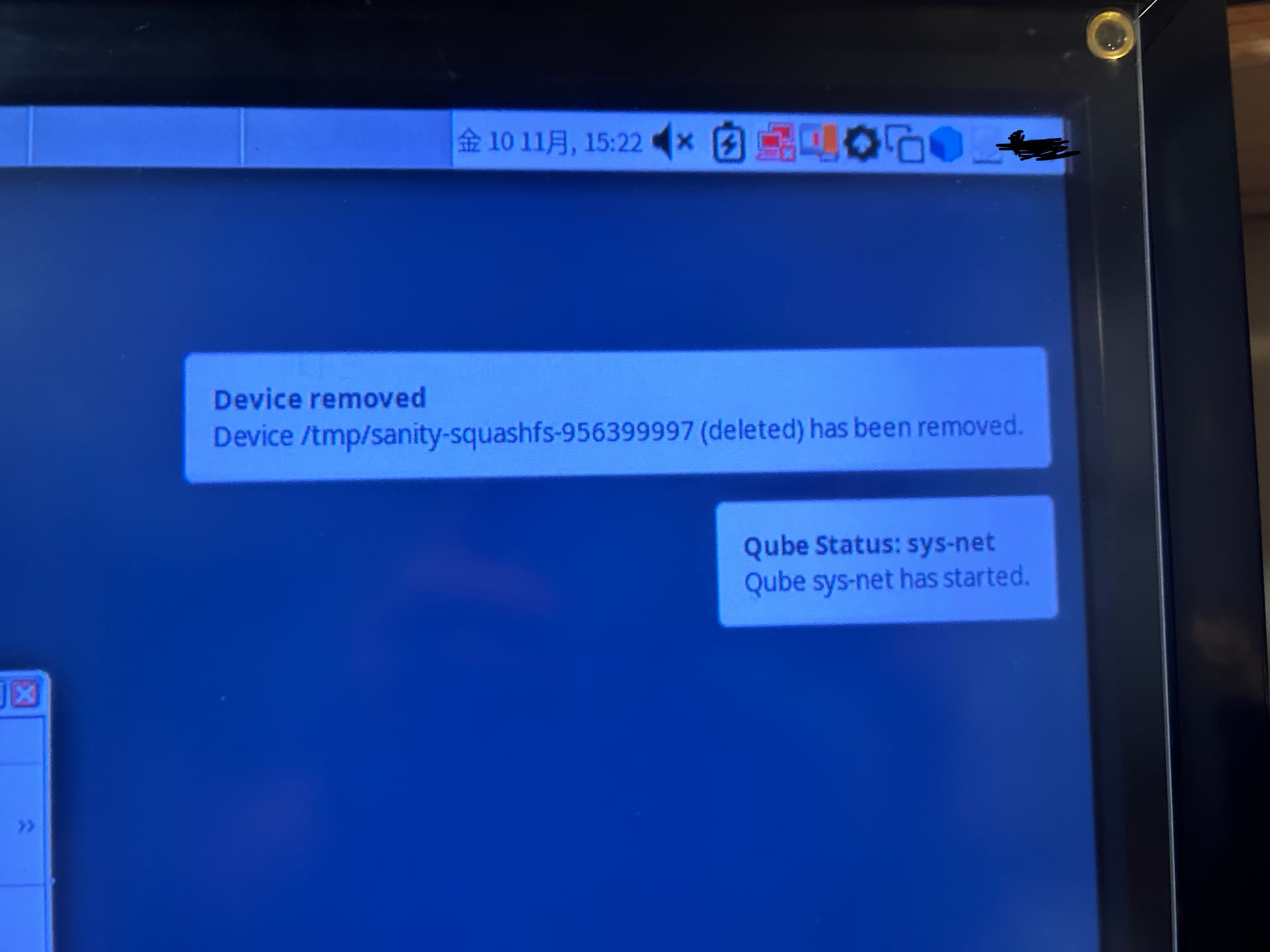

Yes, I tried to do exactly that. But when I start, I still get an error that the device has been deleted (as shown in the captured image) and it does not seem to be connected.

Thanks for your continued support. I was having dinner with my family, sorry, I made some sys-net and the HVM/Ethernet/memory/ is the same. I don’t know if this is correct, but when I try to start the terminal, I get the error in the image and cannot open it.
No, I made a mistake. It was a conflict. sys-net5 was killed and the terminal was successfully started.

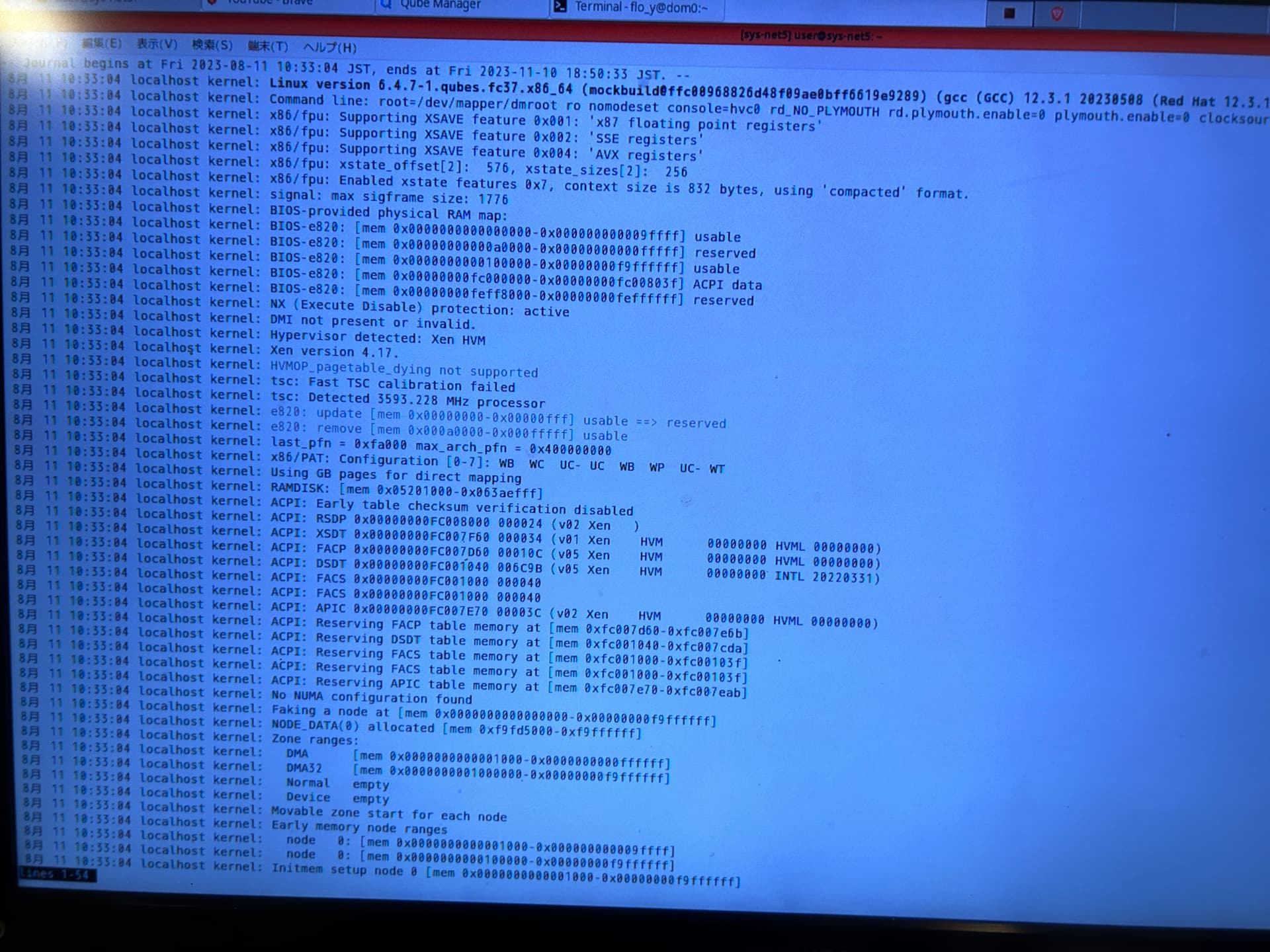

エラーらしいものはいくつかあるようです。HVMOP / e820: remove など。他のsys-netも同様です。
Those are not relevant messages. Try to look for messages containing words “error” or “fail”.
Also check the log from the end to see the messages from the latest boot.
You can use this command to only see the messages for current boot:
sudo journalctl -b

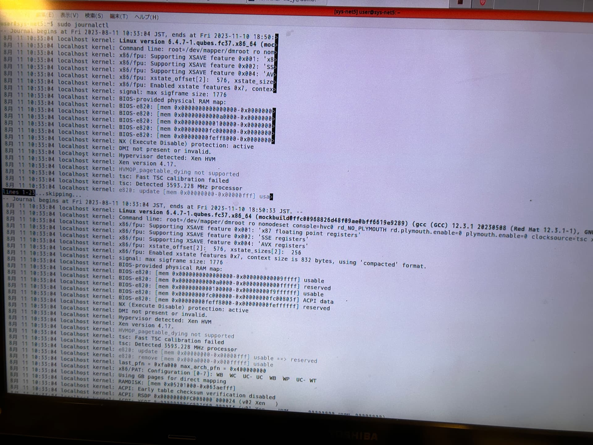

I rebooted(sys-net) again, put the error on the top right screen and then did sudo journalctll -b.
[Firmware Bug] TSC doesn’t count with p0 frequency!
The only error I can find is.
Greyed out is
HVMOP_pagetable_dying not supported
e820; update [mem 0x00000000-0x00000fff] usable ===> reserved
e820; remove [mem 0x00000000-0x 00000fff] usable
only.
Perhaps errors are shown in red, but I don’t see any Error messages; do I also need to do journalctl -b with dom0 or etc.

The messages:
Device /tmp/sanity-squashfs-* (deleted) has been removed
Seems to be related to snapd and shouldn’t be related to your problem.
