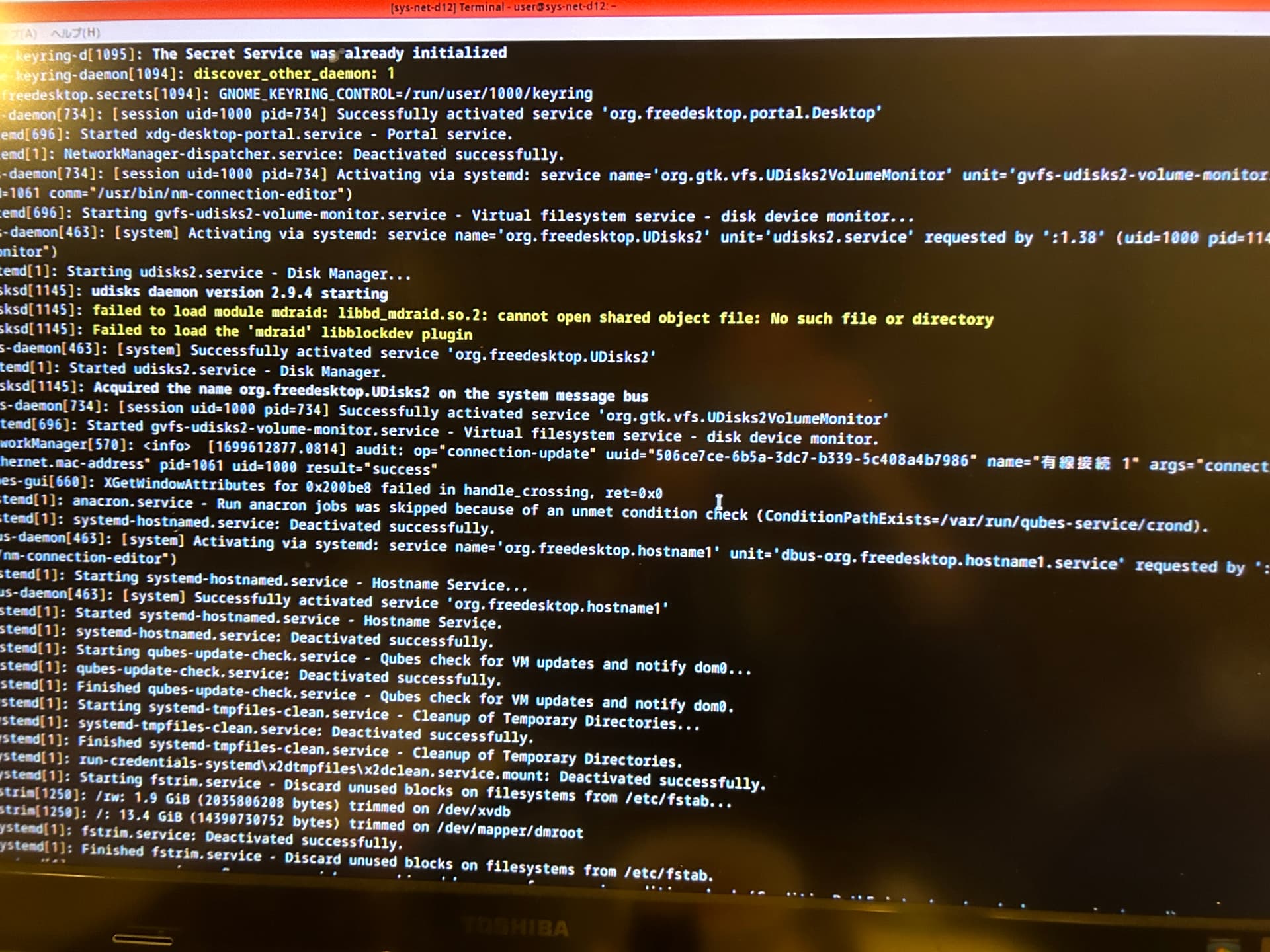

I meat for you to check the logs in sys-net terminal with sudo journalctl -b and search for “ens6” and “enp0s6” there.
Thanks, I read the log that came up with sudo journalctl -b, but there are no words like ens6 , enp0s6. The network settings are configured in the properties that come up when I right-click on the computer icon in the top right corner, as I can’t find Network Manager. I think it might be here. I have no network settings on the dom0 side.
Maybe you didn’t scroll it with PageUp/PageDown or with arrows?
You can also print full log in the terminal with this command if it’s easier for you to scroll in GUI window:
sudo journalctl -b --no-pager
Then it means you’re using Network Manager applet.
Ah! I didn’t realise I could scroll down… I just checked and if it’s a NetworkManager log, it’s there. But I don’t think there are any words like ens6 in the interface.
Since interface with this name is present then it should be somewhere in the log.
You can search for a string in journalctl with / key. For example, type /ens6 and then press Enter.
You can read journalctl help about its shortcuts if you press h key.
I tried typing the command but without success, so I did a search from the terminal toolbar.
kernel: r8169 0000:00:06.0 ens6 : No native access to PCI extended config space, falling back to CSI
