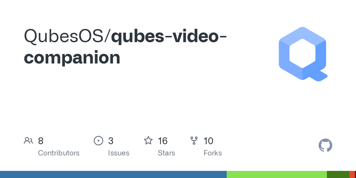

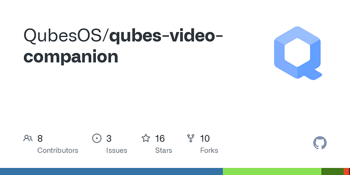

You can also try this:
It should be more performant compared to attaching USB device to the qube.
