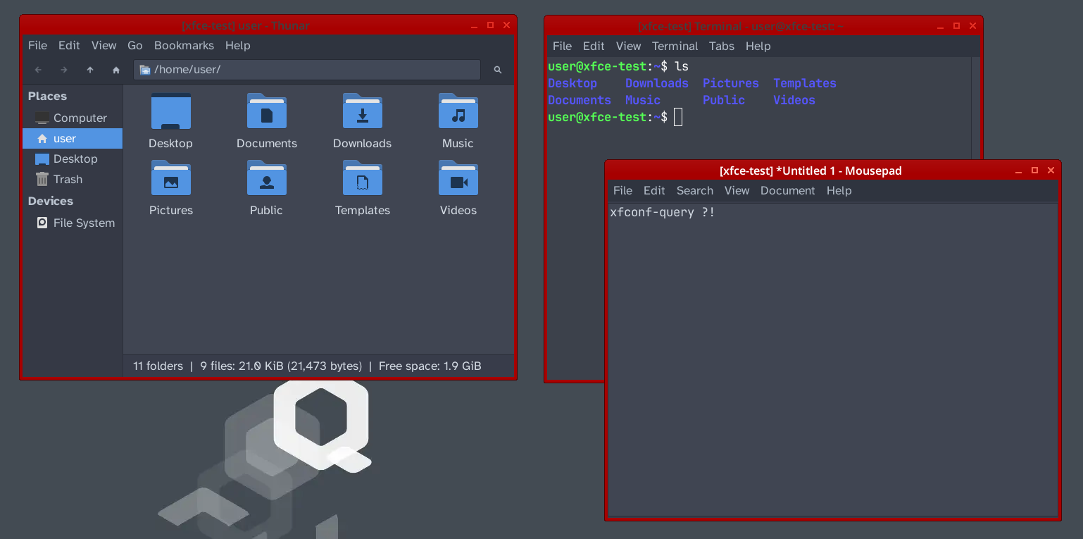

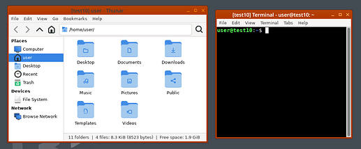

XFCE dark theme for qubes which are based on minimal templates
Since Qubes OS default is XFCE I thought it would be nice to switch my all my qubes from Gnome to XFCE (also using xfce-terminal, mousepad, thunar … instead of gnome apps).
I already had a very easy and straight forward implementation for Gnome ( gsettings set org.gnome.desktop.interface gtk-theme <THEME-NAME> …) but for weeks now, I cannot get XFCE based on debian-13-minimal to look like this:
(based on debian-13-xfce; just as reference)
Instead, I always end up with the default (fallback) light theme:
I test (almost!) everthing related to xfconf-query and xfconfd …
XFCE alternatives to ‘Adwaita-dark’: numix-gtk-theme and arc-theme

Beside the xfconf-query I have also tested to use directly *.xml configuration files - both without success.

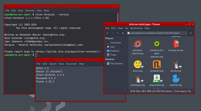

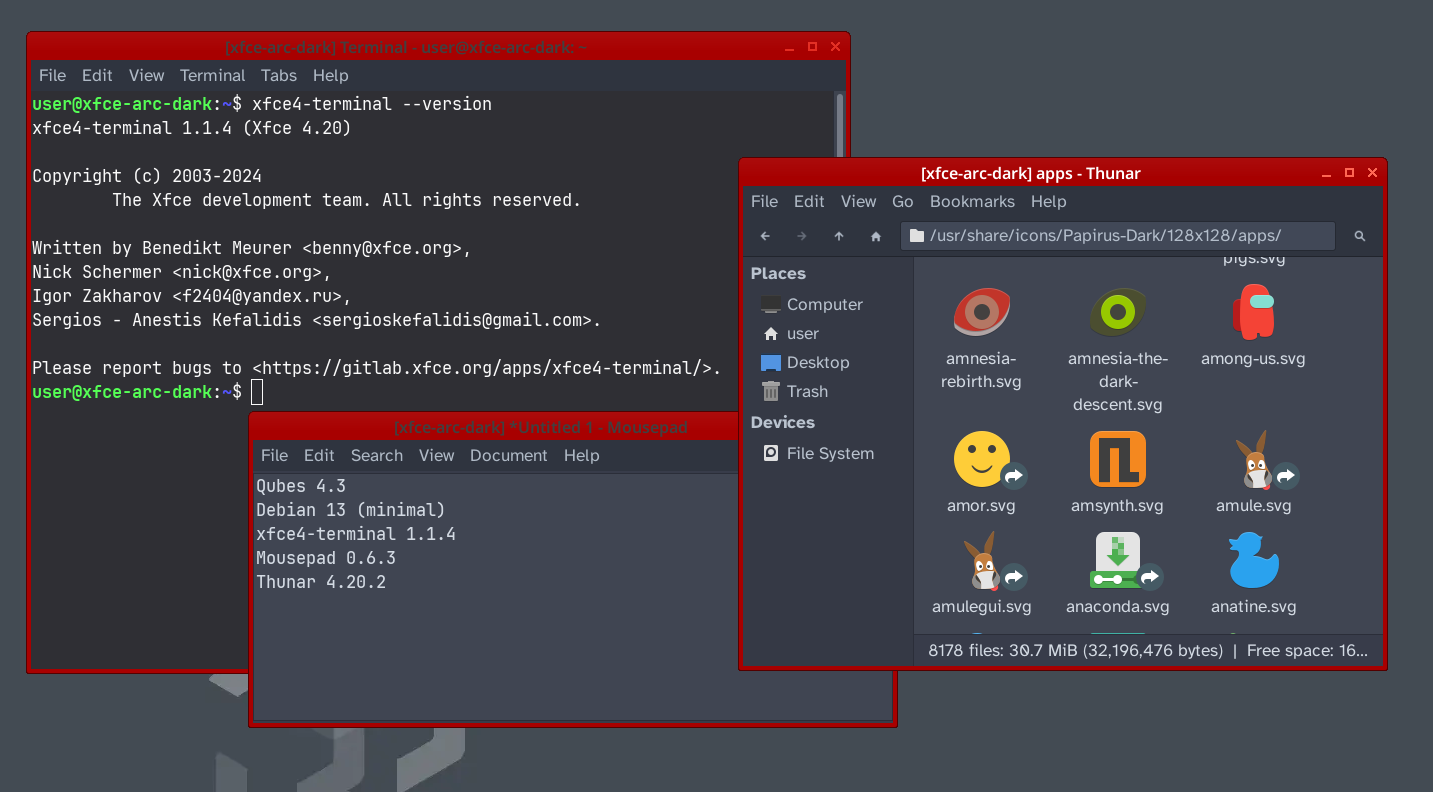

Setting up a dark theme for a minimal qube might seem straightforward knowing this central configuration apps from a classical Linux OS or Windows. But the Qubes OS reality for a minimal qube might be challenging to keep minimalism but functionality.
Objective
Create a Xfce application qube with:
  • Minimal package footprint (no unnecessary packages and daemons)
  • (grey) Dark theme: Arc-Dark theme (GTK)
  • Set new icons: Papirus icons
  • Set new default fonts: JetBrains and Atkinson Hyperlegible (was not able to find a solution to set JetBrains as default for mousepad; bug: [mousepad] Completely ignores configured font settings)
  • Xfce4-terminal with a hidden menu bar (I only found a solution by modifing *.desktop)
  • Thunar with thumbnails
  • Make all configuration within the template qube
Note: Not touched now, but should be simple: Extend to QT apps.
Architecture overview
Isolated qubes for testing purpose:
debian-13-minimal       # source qube
 └─ d13m-xfce-arc-dark  # template qube
     └─ xfce-arc-dark   # application qube
All-in-one script
Feel free to reuse, share and modify.
You must review and trust it, afterwards copy and run in dom0.
2026-03-15 | Qubes OS 4.3 | minimal Debian 13 | Xfce Arc-Dark

# xfce4-terminal configuration file
cat > "${dom0_dir}/terminalrc" <<'EOF'
[Configuration]
FontName=JetBrains Mono 13
ColorBackground=#2f2f34
ColorForeground=#fafafa
EOF
# Create xfconf XML files for Mousepad
# NOTE: There is a bug in Mousepad!
#       https://bugs.debian.org/cgi-bin/bugreport.cgi?bug=794330
cat > "${dom0_dir}/mousepad.xml" <<'EOF'
<?xml version="1.0" encoding="UTF-8"?>
<channel name="mousepad" version="1.0">
  <property name="view" type="empty">
    <property name="font-name" type="string" value="JetBrains Mono 13"/>
  </property>
</channel>
EOF
# Create xfconf XML files for Thunar
cat > "${dom0_dir}/thunar.xml" <<'EOF'
<channel name="thunar" version="1.0">
  <property name="last-view" type="string" value="ThunarIconView"/>
  <property name="misc-thumbnail-mode" type="int" value="1"/>
</channel>
EOF
echo "Copy files to template qube..."
copy_to_qube "${qube_tpl}" "${dom0_dir}/environment"  "/etc/environment"
copy_to_qube "${qube_tpl}" "${dom0_dir}/.gtkrc-2.0"   "/etc/skel/.gtkrc-2.0"
copy_to_qube "${qube_tpl}" "${dom0_dir}/settings.ini" "/etc/skel/.config/gtk-3.0/settings.ini"
copy_to_qube "${qube_tpl}" "${dom0_dir}/settings.ini" "/etc/skel/.config/gtk-4.0/settings.ini"
copy_to_qube "${qube_tpl}" "${dom0_dir}/terminalrc"   "/etc/skel/.config/xfce4/terminal/terminalrc"
copy_to_qube "${qube_tpl}" "${dom0_dir}/mousepad.xml" "/etc/skel/.config/xfce4/xfconf/xfce-perchannel-xml/mousepad.xml"
copy_to_qube "${qube_tpl}" "${dom0_dir}/thunar.xml"   "/etc/skel/.config/xfce4/xfconf/xfce-perchannel-xml/thunar.xml"
#  Create Xfce application qube and make final configuration
qvm-shutdown --force --wait "${qube_tpl}"
qvm-create "${qube_app}" --template "${qube_tpl}" --label red
qvm-shutdown --wait --force "${qube_app}"
qvm-start "${qube_app}"
echo "Enjoy!"
