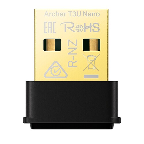

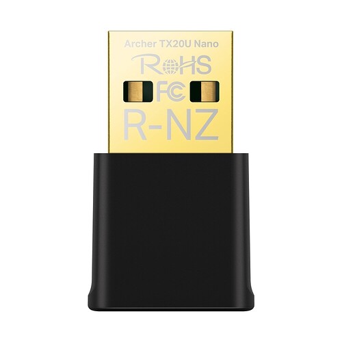

Sounds good. Do you have any ideas on which wifi dongle is compatible? I was thinking of this one
and this one
but I don’t know if any of these are compatible with QubesOS?
