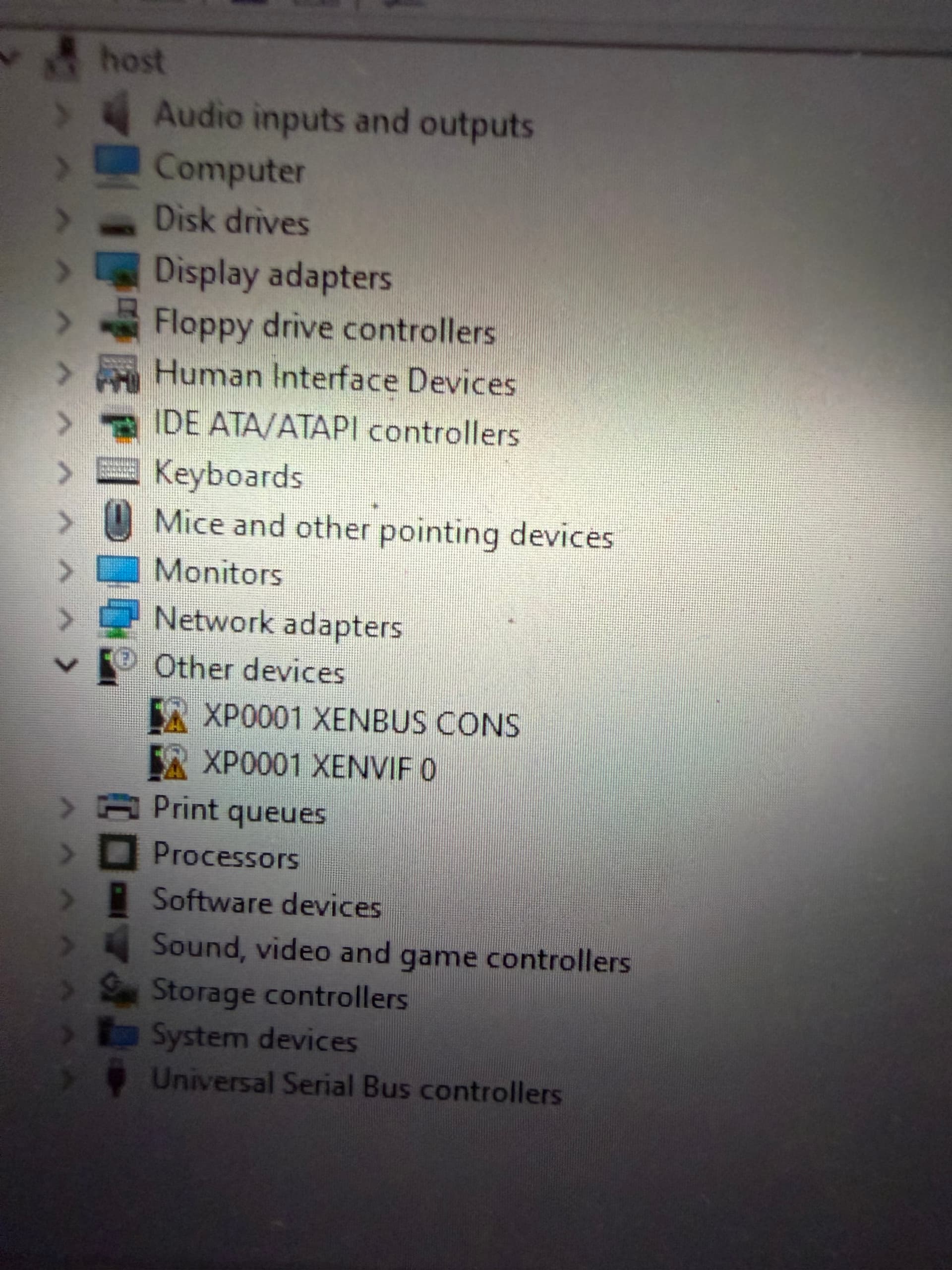

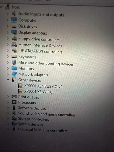

And Installed Win10 from scratch (first without qubes-win-tools, after with), and I am not able to get an internet connection at all. Can somebody help?
The Device Manager looks always like this:
This issue is described in the documentation:
If there are network-related issues, the qube doesn’t resolve DNS and has trouble accessing the Internet, this might be an issue with the PV Network Drivers.
In this case, it’s recommended that the PV Network Drivers be unchecked during installation of Qubes Windows Tools […]
As mentioned, I tried also without qubes-windows-tools at all, still not working.
