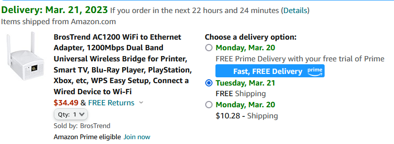

Idea: Ethernet still works.
I can purchase a WiFi to Ethernet adapter, not bridge.
