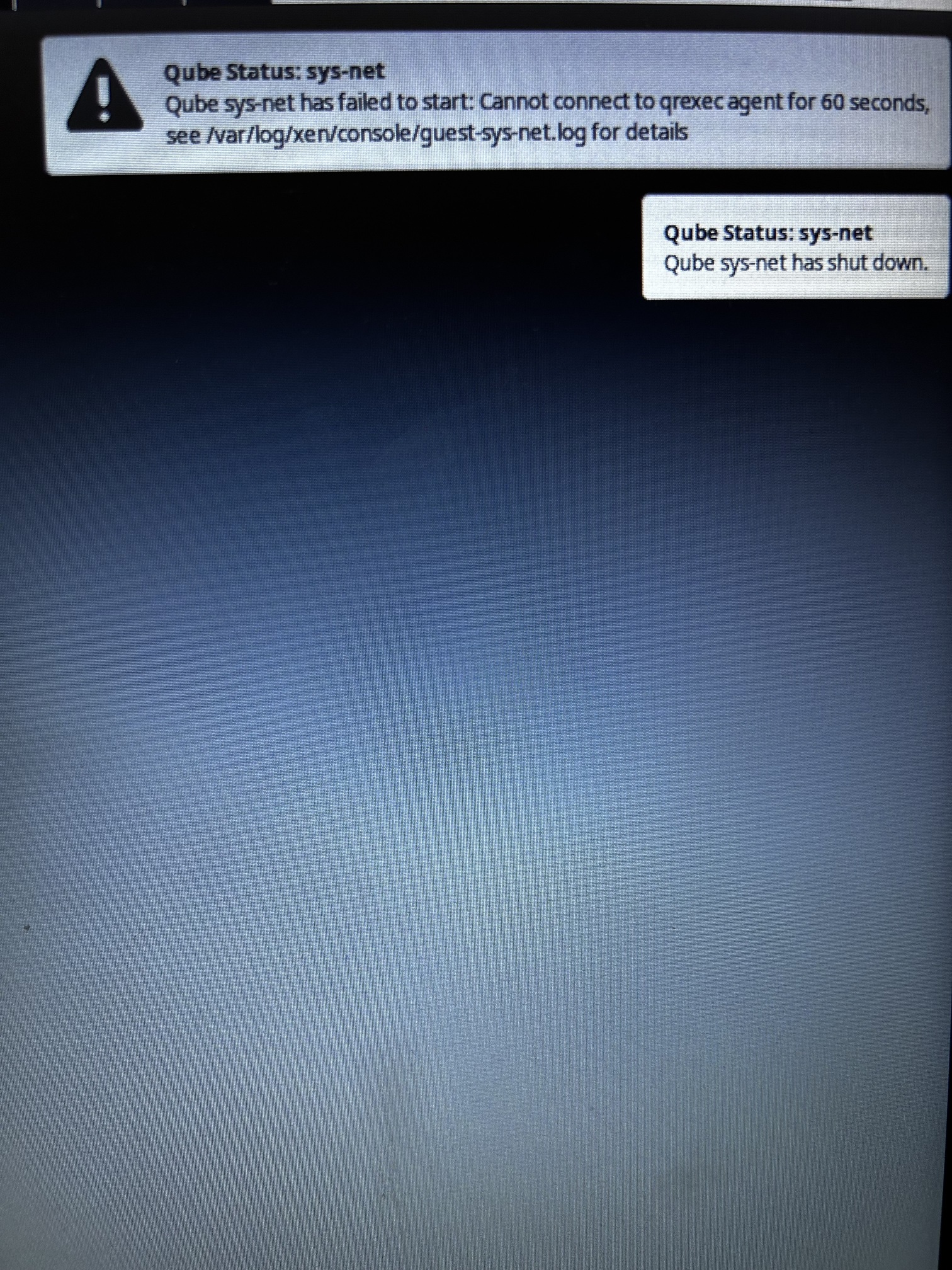

Processing: IMG_4749.jpeg…
This message pops up when trying to start sys-net with the fedora template
Are you able to start the fedora template qube itself?
This used to happen to me all the time with sys-USB and sys-net. You need some good legacy templates. You can try “fixing” your Qubes install with an older version. There is a kernel/driver mismatch somewhere. There is no easy way to fix it but to get the correct template and kernel.
