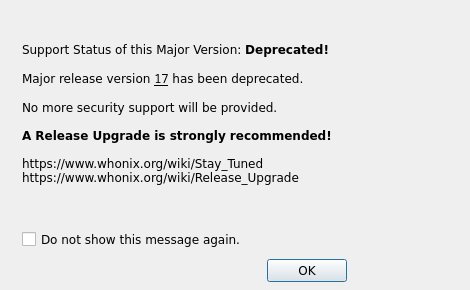

Hello everyone.
Am I the only one getting the message “Whonix 17 deprecated”-alike while starting template, or it’s dvm’s dispvm?
I tried in-place upgrade, which went ok, but now getting error “Denied sdwdate. ConnectCheck from dispvmxxx to sys-whonix”.
Any feedback?
There is no Whonix 18 yet, so what/how did you upgrade?
What’s the exact message?
You’re probably using the developers repository - don’t.
