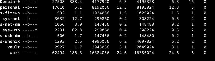

Image is from when doing nothing, having 3 vms opened, vaulda work and personal
personal and work having google browser opened, work on teams call with screensharing
vauld having keepass opened

sys-usb seems unusually busy, is it normally like that for you?
When juggling multiple browsers or multiple browser windows, on Qubes or on any OS, something I do to save on CPU is leave the non-active windows displaying a blank New Tab page. Anecdotally, less costly than displaying even a simple webpage let alone something web 2.0 or animated.
no sys-usb starts to be busy when on calls on teams (my mic is mounted on the work vm but not used … not sure if is related with this as all vms starts to go high when on calls) , otherwise is at 0-3%
