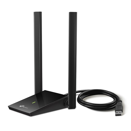

I want to use the TP-Link Archer T4U Plus, and I worked hard to install the driver using the default template and added the USB device to sys-net, but now sys-net and sys-usb won’t start. Please tell me what I should do to use the USB Wi-Fi adapter.

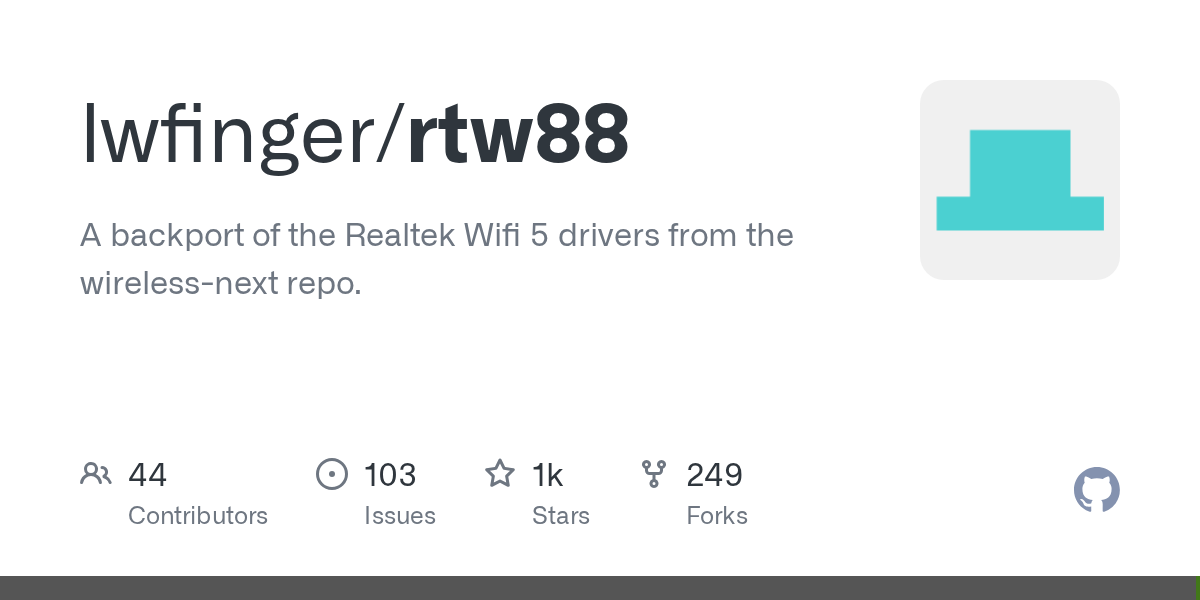

I used the following commands within the Debian template according to this page.
sudo apt install linux-headers-generic build-essential git
cd rtw88
sudo dkms install $PWD
sudo make install_fw
sudo cp rtw88.conf /etc/modprobe.d/

Yes. I had exactly the same problem after installing that driver GitHub - lwfinger/rtw88: A backport of the Realtek Wifi 5 drivers from the wireless-next repo. in Fedora 42 template. sys‑net stopped starting

Some questions: Does the Qube template where you installed the driver work properly? Also, on the GitHub repository, there’s a section dedicated to uninstalling the driver have you tried it?
