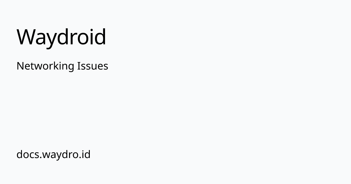

Can anyone tell me why I have to set up the firewall and if this effects any other qubes. Because today I have seen that there are other network issues which may be caused by the waydroid experiments
That’s because it’s required for waydroid to work:
No, it shouldn’t have any effect on other qubes.

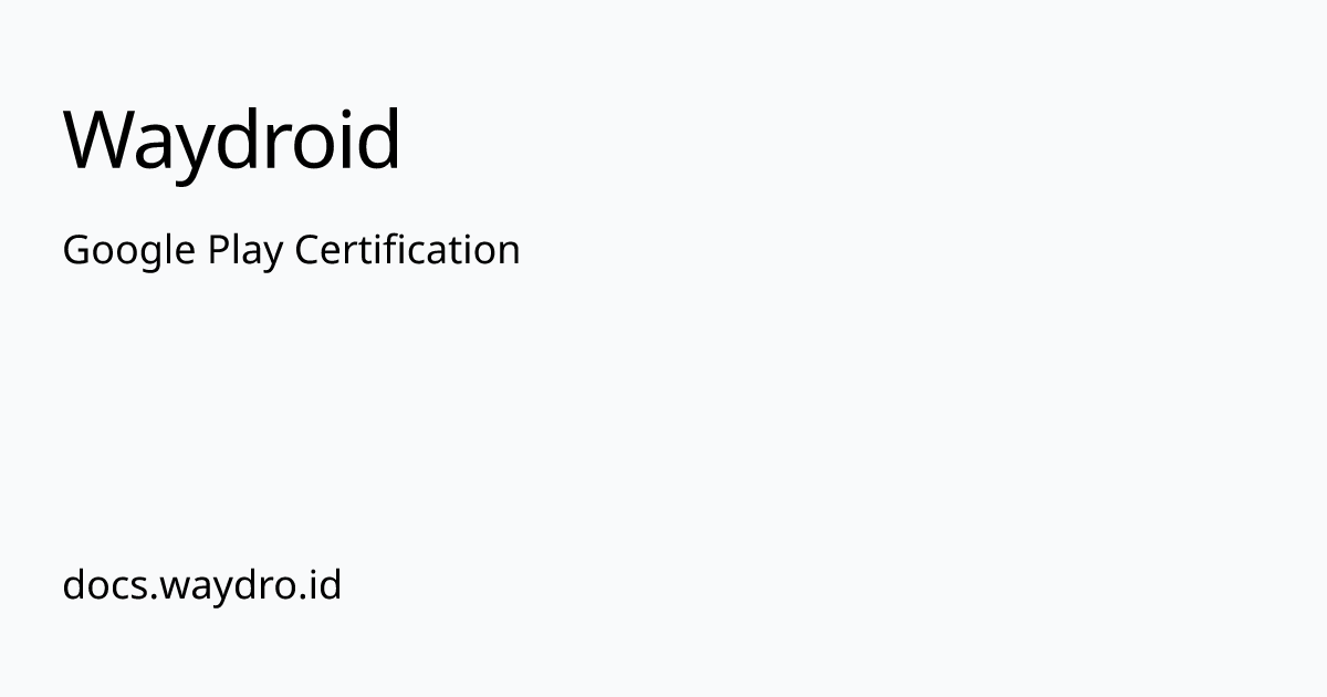

You have to self certify the Waydroid:
Related issue:
So this is an issue with Waydroid?
Never had to register a device that was running LineageOS before…
Guess this is just an issue with WayDroid…
I don’t know how Play Protect works, maybe it’s checking the hardware device fingerprint or/and the ROM to be supported.
I have used LineageOS on identical hardware, same PC, same version of Qubes, everything… With GApps and all. Never had the issue, never had to register my hardware with a marketing company.
I don’t know how it works so I can only assume that LinageOS is certifying their ROM builds with Google but the Waydroid is not. The Waydroid is based on LineageOS with some patches but it’s not using the LineageOS ROM builds and build the images by themself and don’t certify them with Google.
Waydroid uses LineageOS. Their ROMs are LineageOS.
There is nothing to certify…
They have not registered my hardware with google… Nor has Waydroids copy. So there should be no issue… as I say… SHOULD…
So I don’t get it…

Hey, I’m running Qubes r4.2.1 I successfully got everything up and running. However, Waydroid does not have internet. I verified that I ran the commands for 4.2.1 and that the changes took. The Qube itself has internet and completed a ping to google.com.
What’s the output of this command in Waydroid qube (run as root)?
nft list ruleset
How did you check that you don’t have internet there?
