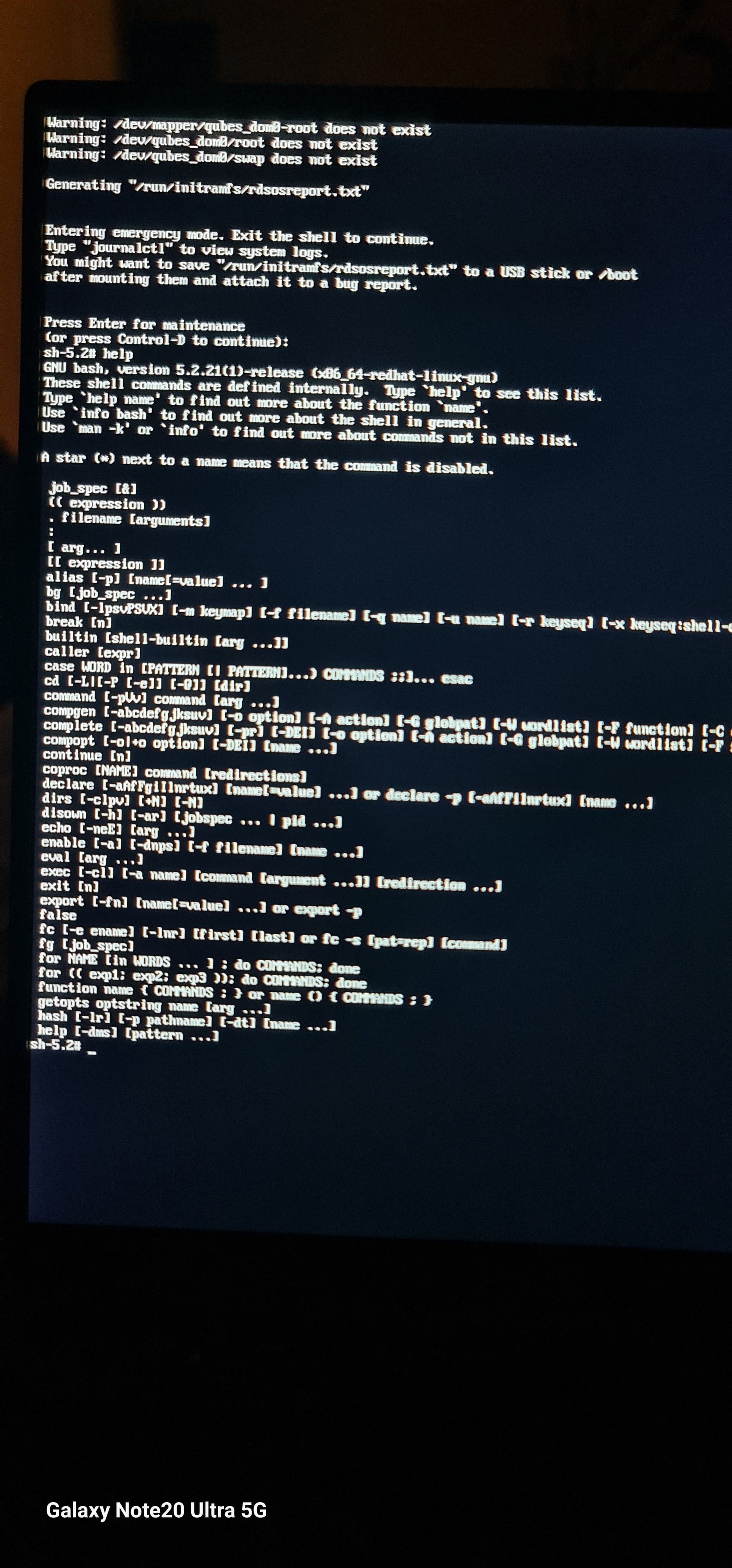

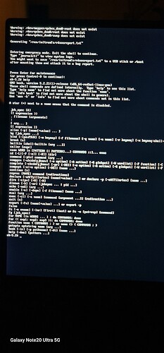

AND…it failed !
system blanked out, black,frozen.
powered of dirty.
restarted,took the diskEE password
then…a black frozen cold screen.
step3.
"invalid characters in property name {’ ‘,’=']
running scriptlet … 1271 / 2575
system borked.
will need to get the ISO and boot ,fresh,clean…on the live working laptop !
ARGH…dont do it on live works systems
Anyone having any idea how to restore to previous working dom0, version 4 2 ?
There is a command to rollback as a snapshot of Dom0 is made at the beginning of the upgrade process. It should be documented somewhere.
sudo lvconvert --merge poolname/Qubes42UpgradeBackup
I found this in the upgrade script, it’s the command to rollback dom0 after an upgrade. Run this command and reboot. Replace poolname with the actual name of the lvm volume group I think. Not sure what it is by default…
