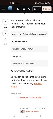

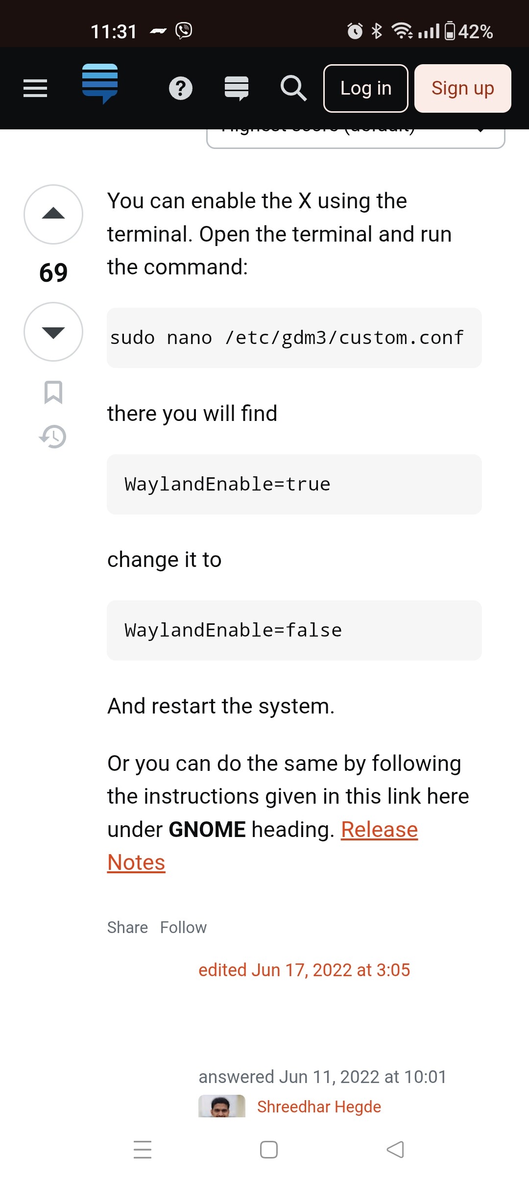

I can also confirm that changing from wayland to xorg works. For rocky it is gdm
