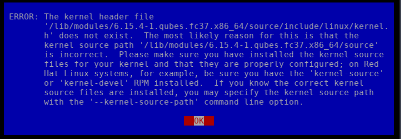

Hello, within a week, two Dom0 updates (I think the kernel and Xen were upgraded) have each broken my NVIDIA driver, both ‘nouveau’ and the official NVIDIA open-source driver (570.169). After the first update, I could still switch to the official driver, but after the second one, this doesn’t work either. The error message is attached. Do you have any ideas on how to fix this so that either ‘nouveau’ or the official driver works again? My first idea would be to downgrade the kernel, but I don’t want to take the risk of breaking even more if I copy commands from my research, so thanks if you can help! Additional information: I use the kernel-latest and an NVIDIA card from the 40-series Geforce.

Not sure if this is the same problem that I just experienced, but maybe you want to give this a try …
To me it looks like there might be a bug in version 6.15.4 of the qubes kernel-latest-devel package:
The 6.15.4 version installs kernel.h in
./usr/src/kernels/6.15.4-1.qubes.fc37.x86_64/include/include/linux/kernel.h
(note the double “include” in the path)
In 6.14.4 it is in
./usr/src/kernels/6.14.4-1.qubes.fc37.x86_64/include/linux/kernel.h
(with only a single include)
The latter location is where the build process from your screenshot expects the file, and in 6.15 can no longer find it and fails.
Actually, most of the include files in 6.15 are underneath ./usr/src/kernels/6.15.4-1.qubes.fc37.x86_64/include/include (“double-include”)
This does not really make sense to me, and looks like it might be a result of some path-confusion in the package builder. I have not yet looked at the kernel repo for the root cause, though …
For comparison: RPM for 6.15 vs RPM for 6.14 - you can check the contents with rpm2cpio …rpm | cpio -t
… anyway …, what worked for me: I manually moved all the contents of the double-include dir one level up (subdirectory drm needs careful merging!)
After that the kernel module build worked as before.

Still I managed to fail:
sudo cp -r /usr/src/kernels/6.15.4-1.qubes.fc37.x86_64/include/include/linux/ /usr/src/kernels/6.15.4-1.qubes.fc37.x86_64/include/
Found another forum post related to this: Nvidia proprietary driver installation.
I’d prefer making nouveau work instead of disabling it. - at least til I am able to install the official driver.
That command just copies the linux directory into the right path.
Now the build log complains about further missing include files in other directories.
At least on my system there are still lots of other directories in include/include, so you should copy them all.
I recommend using the -i option to let cp ask you before overwriting something …
That would have been easy to avoid. I am sorry for my stupidity. Thank you! Looks like it works! I let you know after restarting.
