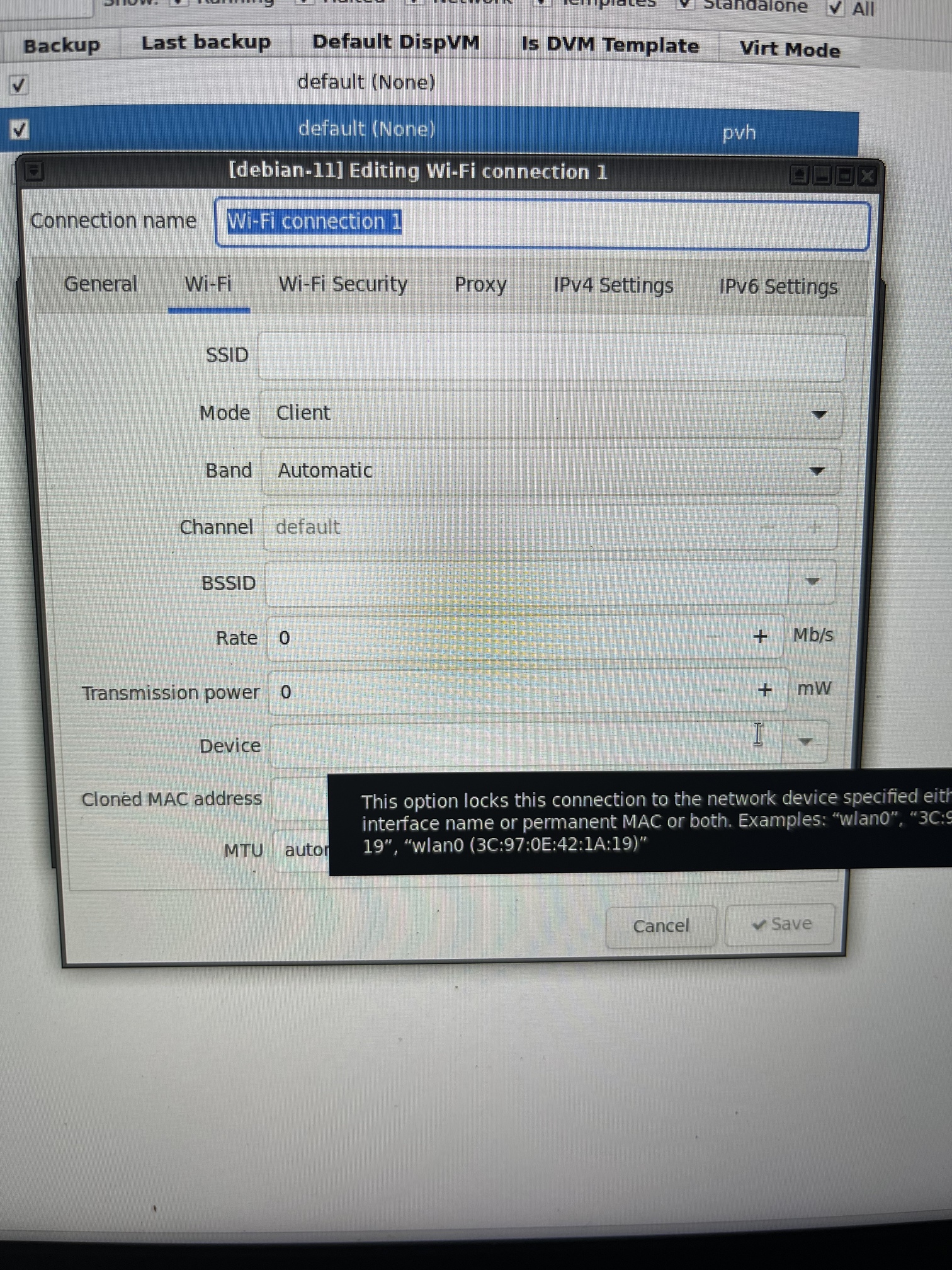

If anybody can help? I’m new into the Qube OS system. Trying to figure things out as I go. I’m having trouble in connecting to my Wi-Fi net work I don’t have a clue and what to do and what to see. If someone can help me with a detailed description of what to look for and what to do that would be amazing.

I installed it with my through my usb. It completely wiped my windows os and created my qubes as my main os. I haven’t made any changes or corrections to anything for the sole reason of trying to understand the os. At first there was nothing that I could find that would indicate to connect the system to my Wi-Fi network. I don’t know if my ideal of qubes os is as simple as tails or a bit complex. Looking through the qube os I only have two templates which is Debian 11 and fedora but when I click the qube manager I see domo. Towards the upper right of the screen it displays a double comp icon that you can rifirrafe click and it appears edit connections, as I click a box appears that gives you a option to add a connection manually to Debian or fedora through Ethernet, mobile broadband, Wi-Fi and etc.
Overall I want to connect my qube os to my Wi-Fi network or what are the proper ways of doing so. Due to my laptop now having no form of internet connection now

Yes, it’s definitely a lot of docs. But it looks to me that user tried to connect to wifi in templateVM (look at the title bar of the window - it’s debian-11), so I thought Qubes OS concept is missed here at first.
The thing is, there should be a sys-net qube available and I can’t see it.
