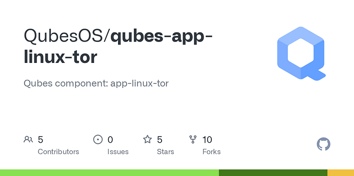

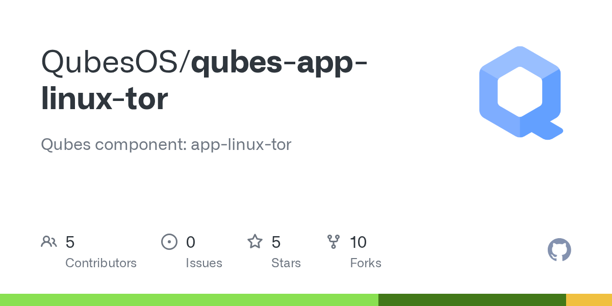

Also: why isn’t TorVM a part of Qubes any more?
That is easy to answer:
Archived April 26th, 2020.
