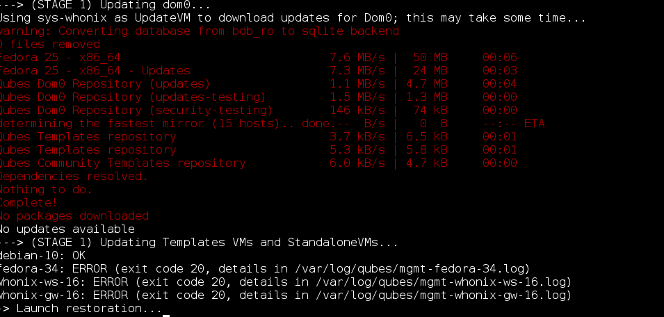

Hello, I tried to make an in place upgrade to the new qubes version. But after I running the upgrade script, there was a error code at stage 1, as you can see in the following pictures. I does´nt found a explanation for this, so maybe someone in this forum can tell me what I can do. After the error the qubes template update tool (which worked until this moment property) gave back an error.

Thanks, I try to update the templates with an ethernet port, but it does´nt help. In the above mentioned post, I have the same type of error message.

Comment: File /usr/lib/rpm/macros.d/macros.qubes is not present
